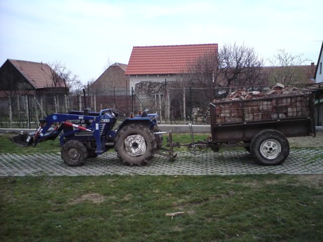

Ok Cowboy357, here we go
The pics (although already posted in other threads) my TL1900
Rebuild grey import with new FEL.
[/IMG]
with the dumper in building stage
And the hydraulic commands

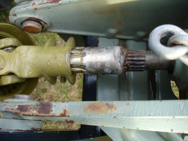

The only half-way interesting project I've done to my tractor (other than rebuild the top end of the motor, which I then found out didn't really need it, but that's another story:rolleyes:) was to design and fabricate a 2-pt to 3-pt hitch adapter. I've covered this project before in the Customization forum but never here I don't think. Basically, I found a real nice condition 2-pt 48" Yanmar tiller on ebay for only $250. As I recall I was the only bidder, I guess because the 2-pt hitch scared everyone away. I paid a little extra for shipping from OK to CO and it was mine. I then went about taking lots of measurements and laid it out in AUTOCad. From there, with the help a a friend, I fab'd/welded it up and also welded on a std. 1-3/8" 6-spline PTO shaft adapter over the tiller's metric 16-spline input shaft. It works just as I has envisioned it to. Maybe the only issue I have with it is it hangs back away from the tractor a couple inches more than I would have liked but it also clears the rear tire better, so...the following are a few pics of it installed on the tractor.

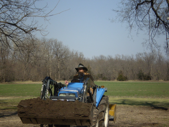

Great Pics , Fine looking Tractor , Some handy info tatra805 . I Was not aware of the Low Rpm Issue , I Will Have to Check Mine today & see what the Low Rpm,s are set at . After seeing Your Nice Clean Tractor I,m Kinda ashamed to show any , As I,ve Been Clearing Tight areas Between trees lining the River bank , & Moving a lot of Broken concrete & dirt Leaving Mine Perty well beat up , But will try to get Some Updated Pics Next few days . Thanks for Showing . Any More Updates on the dump Trailor as I,m thinking about Building one Myself to Carry dirt from one end of the Property & to & From my New Baby Pond Project ? :eek:
yomax4 As Larso said , Yes as far as Using the Clutch to Engage the Pto , Also its a good Idea to Use it When changing PTO Speeds allthough I Very seldom Use the Low or High setting & find 2nd to be just Right for My needs . Sounds like a Nice Find on the 247 also, Any Pics ? I Also noticed said for Digging Holes, I,m assuming You Mean You use a Post hole auger as I Have recentlly bought an allmost new one & have Yet to use it or even Hook it up Yet , So I Might have some Dumb Questions Myself soon . :confused:
Larso 1 Interesting Pics & Also a good post Thanks For Sharing . Not Wuite sure I understand the Welded on Spline on Your Output shaft & Guess I Dont Know anything about the 2 point type hookup, But Looks Like You did a Great job Making it work . I Had Several of the old Well used Iseki tillers & sold them all Because They looked like to Much work to Me & Figured if I found the need for one I,d Buy a Newer Greymarket one I Know Works . Might need Your input If & When that time comes also .
Anyone else care to Join in , I,ll Try to Get some Pics soon , Allthough There Mostlly boring to Most I,m sure , Thats Why I,ve never Posted any in Any of the top Interesting Projects threads . Ya,ll have a Great day . I Actually have to Work on One of Mine today , Seems its so Ready to Work it doesn,t want to shut off Properlly . More then Likelly a sticky Ignition switch I,m hoping .

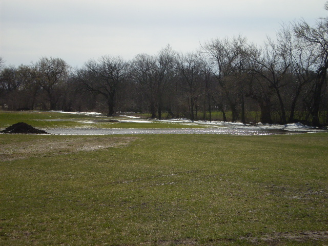

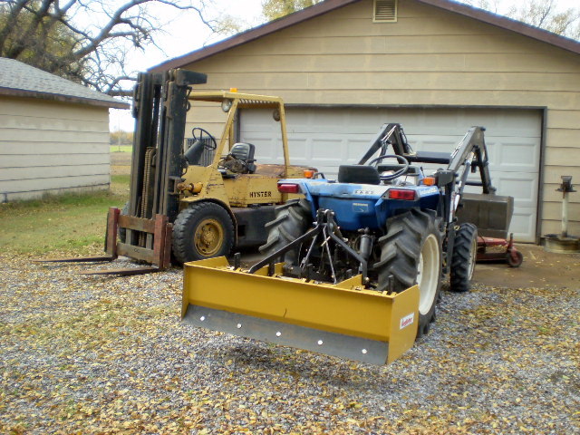

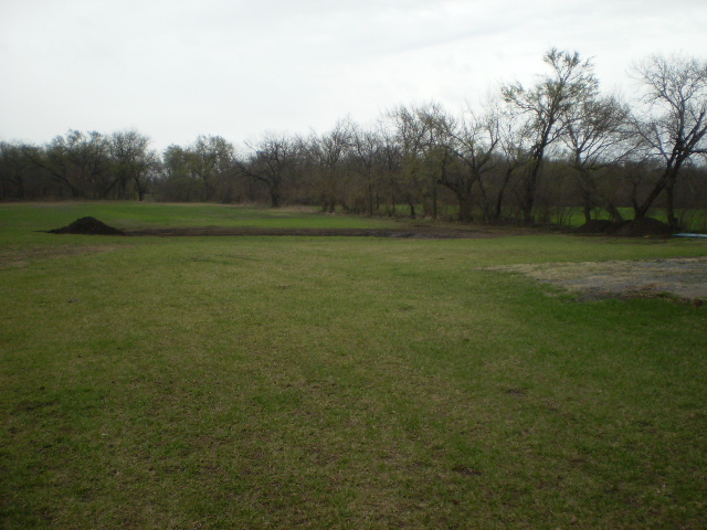

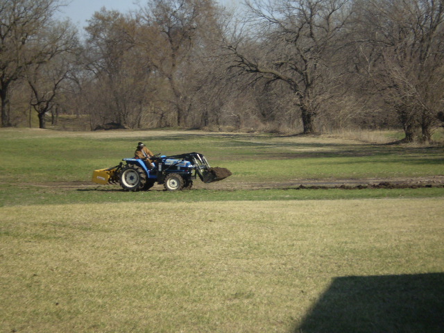

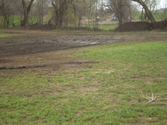

I Added some Pics of Both the Tractors & My Latest Project , Making use of a Normally Flooded Skeeter hole that is hard to Maintain, & I needed dirt for other projects the wife wanted done . So Thought that would be a Great Place to start a small Pond, Allthough I,m No Wheres close to being done Mother Nature Decided it would be a good time to test it out . lol . Thanks to all posting & Looking . Bob

The very last update on my trailer that i can give is that my neighbour filled it today with some old rooftiles . Finally a test for the hydraulics as the same volume horse manure is no challenge.
I have a thread on this dumper in the build-it-yourself section. Plan to update after paintjob is done (looks as summer holiday period...:(). In the mean time the trailer is in use and working fine.

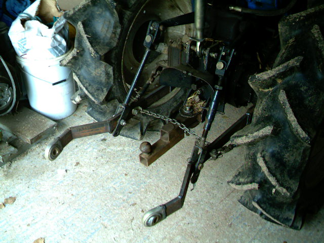

Hi
Attatched is a picture of the new cranked lift arms i made for my iseki tu 220.
I made them as some of my implements were a struggle to get on as the old arms hit the tyres before opening wide enough.
With the new arms the problem is solved.

Nice pond Cowboy are you gonna' stock it with fish?, my ISEKI is the old white painted G-174, I paid $3200 for it supposed to have only 730 hrs on the meter, came just plain tractor, the 3 point hitch was all I got, installed a grader blade this winter installed on the 3 point hitch, the blade is reversable, love to have a front end loader like yours but I'm on a tight buget bein' retired, so I guess one can dream, I really like my work horse a 3 cyl diesel 4x4, I feel I had to pay too much for it, but in Canada here there aren't many around, anyhow I like the country livin' although I live in the city, how many acres do you have?......take care AMPA:)
