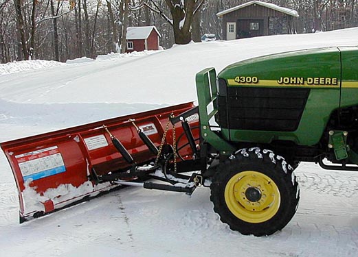

Pic of my solution. Best way to go, IMO. Others have their "best way to go" as well.

I thought about it, and read a post on this mod (maybe yours?). But not comfortable with the awkard position relative to the controls this might put me in. I have a total of about 2k' of driveways, so a blade wount be a bad investment, if the price is right.
