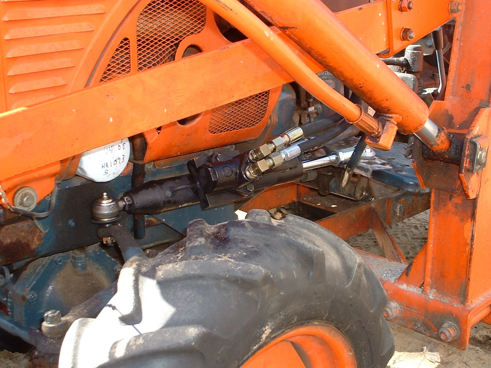

Hi guys, just finished adding power steering to my B. Running it off the PB of the FEL. I removed the hose that went from the PB back to the block which sends it to the 3PH. I then put the power steering setup inline. The only issue I noticed is that when using full loader, the loader gets all the pressure but when messing around it did not seem to be an issue. This setup was under $400 counting the 2 - 1/4" hoses I got from TSC. I may still add a couple 90 degree fittings to get the hoses where I want them on the cylinder side. Bostonrats and I got our cylinders together to try and get the best price. I can't complain at all with it, and it's well worth adding. You can see Bostonrats info hear: http://www.tractorbynet.com/forums/customization/138014-power-steering-90-minutes.html Attached is some pics, the best place to mount it was on the step which I reinforced. It's a pretty tight spot.

Man, that looks sweet! I've just been playing around in the driveway, haven't even started really using my B7100 and I already wish it had power steering! I'd put this mod on my short list, but it's already too long!
I noticed you and Bostonrats mounted your cylinders differently, do you need to find the center of the "stroke" then work on the mounting? Or is it not as critical as I'm thinking?
I like the way you added the reinforcing plate there. Are you able to replace the "toe guard" thing over the pitman arm?
Do they include some kind of instructions?

Willl: No flex whatsoever. I added 2 pieces of angle iron and a thick plate under there. It used to flex when stepping on it but no longer.
cappys tractor: It's definetely a worthy mod for anyone who does allot of fel work. From what I can see, the PB allows all the pressure out when not using the loader, maybe the same as open center? When using the loader, the extra fluid is dumped out a different hose. I don't know anything about quick connects but I know there's posts about it.
yeagisyeag: Bostonrat's L185 has much more space for mounting than does the B, I wanted to make sure the tire did not hit the cylinder. It rubs a bit on full turn but not a big deal. On the toe guard, I removed it when I had to replace the clutch pressure plate and never put it back on. Depending on the tractor, it may need to be centered more but there is more than enough stroke for the B6100/7100 so I went with it as close to the front arm as possible and out of the clutch pedals way. It comes with some basic instructions but not specific to the tractor model. Good plan by the way ;)

did you have to limit the stroke on the cylinder? or does it just hit the hard stops? I see the website has listed the stroke as 8" and I think my b6200 would require about 5" stroke before hitting the hard stops.
   / Now my B6100 has power steering :)
#9
It hits the stops on the tractor and I still have cylinder to spare. This setup has a built in relief valve so when you hit the right/left stops the relief kicks in and there's no harm done to the steering components. The cylinder is longer than needed but it does the job.
