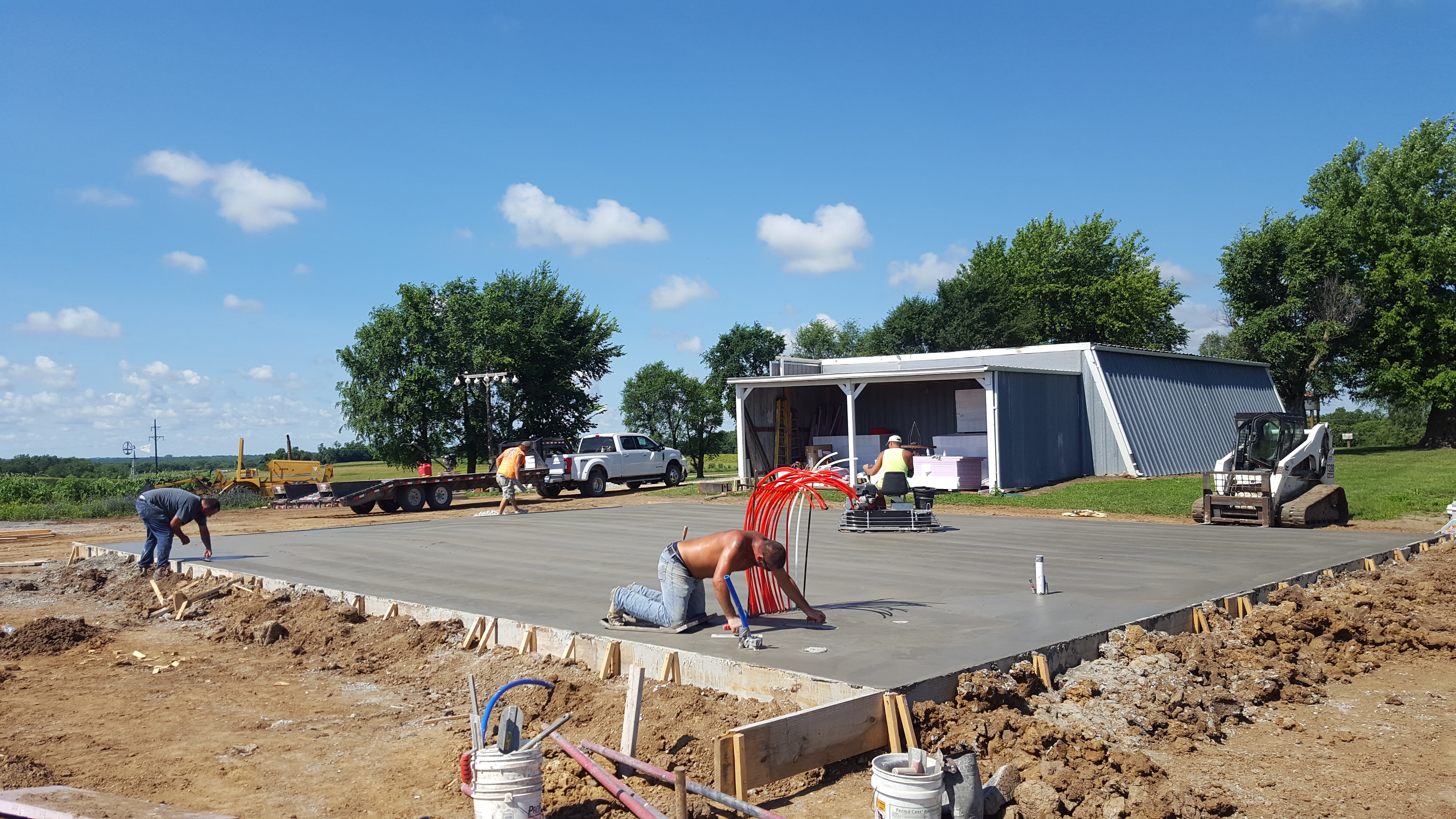

Mine was a 36 x 48 with mesh and in floor radiant heating pex tubing tied to it. Underneath is 2” foam boards on a VERY level bed of sand.
Concrete was fiber engrained, pumped in using a pumper, finish trowled smooth and cut for expansion. Didn’t use rebar and there’s absolutely no cracks anywhere. I believe the key was adequate preparation & proper compaction to eliminate any settling.

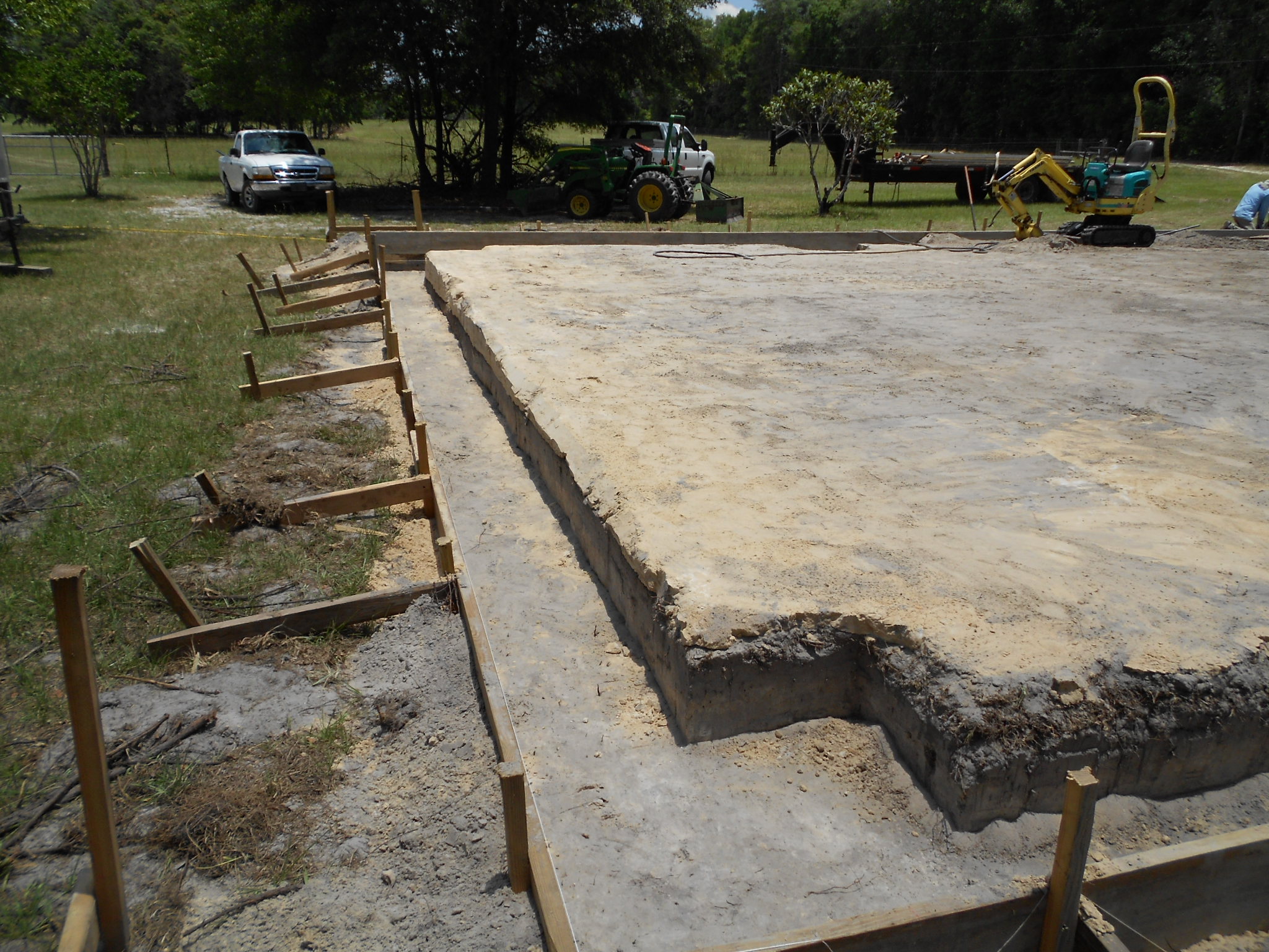

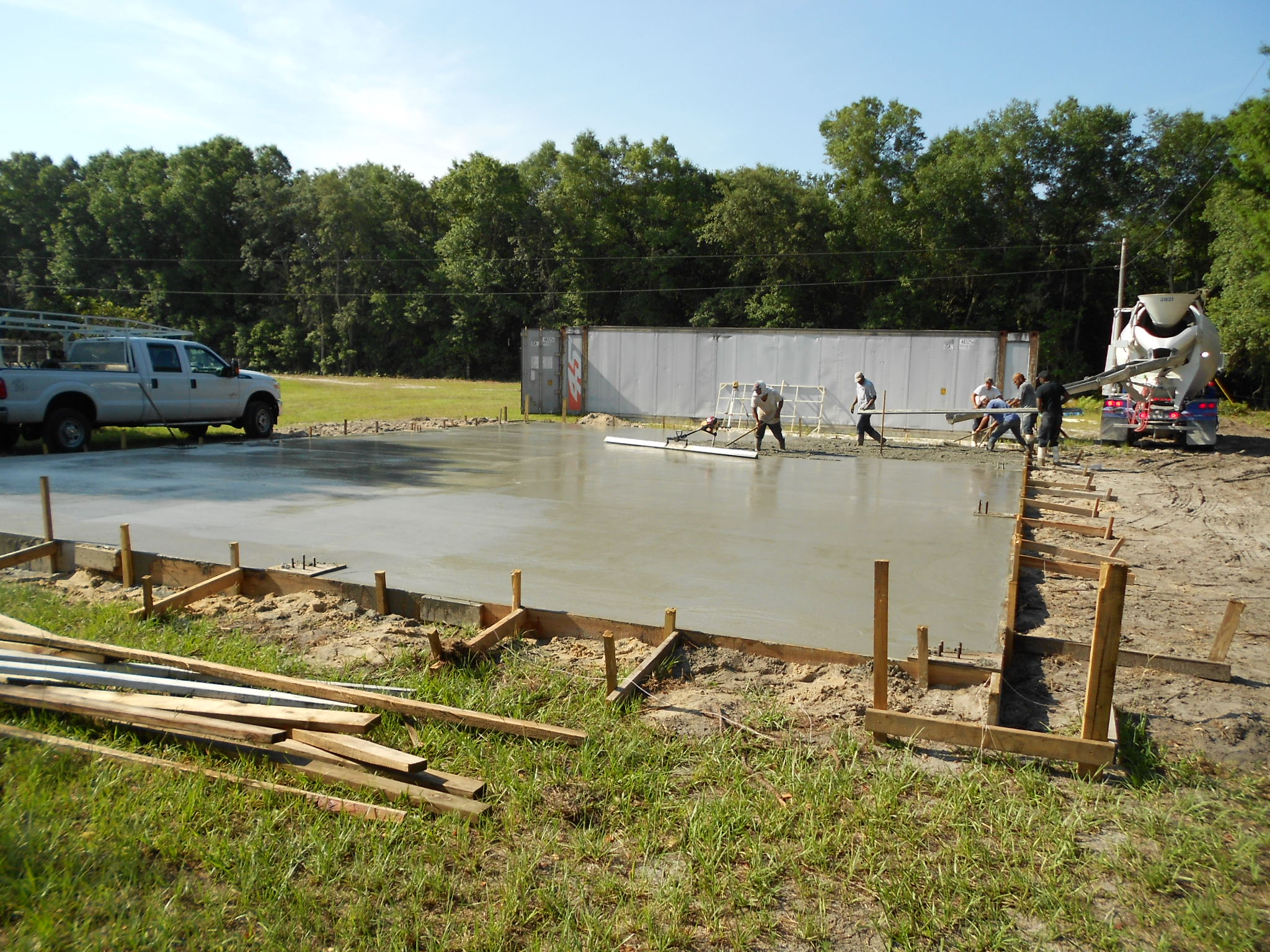

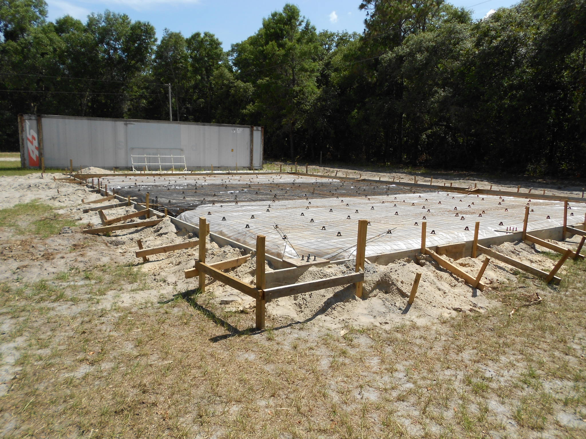

Like I said in your other thread, take lots of pics!!
Here is my 40' X 60' for my red iron building, 66 yards!!
1st- site prepped
2nd- re-bar and wire (per engineered drawings)
3rd- finishing up the pour

WOW...thats alot of concrete !! I do know red iron buildings take alot of concrete per engineered plans. Looks nice !!

Like the way the angled rebar was laid in on the corners and pier / post
