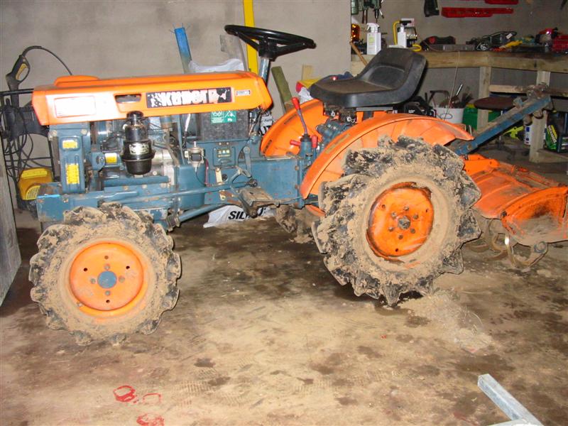

Some photos of the Offending article.
This one is the actual tractor

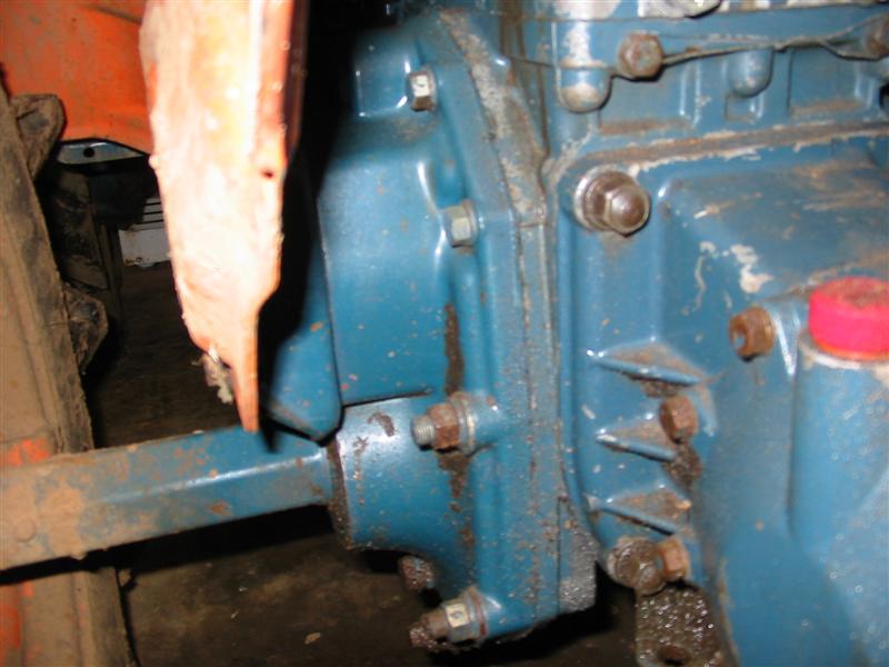

Photo of junction from above.
You can see oil staining on bolt heads and casing

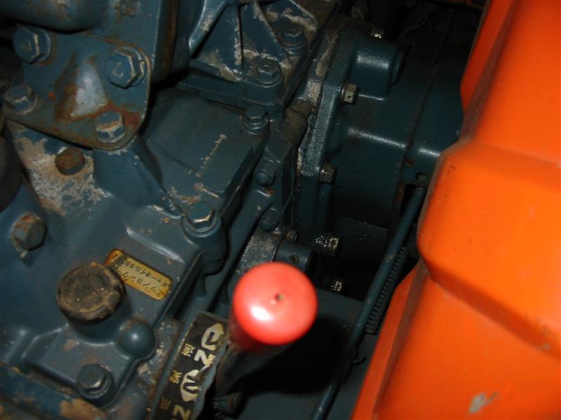

View from rear. Dry to the rear. But gives better close up of mating surface between brake housing and main transmission body.
Also in the photo is the mounting of the factory tiller. This bolts on with 4 bolts direct to the transmission over the PTO.
This is one of the counter rotating PTO's mentioned in previous posts.

I don't know much about the B6000 Voodoo so my comments may be out to lunch, but here goes anyway. If the leak is as small as you indicate, then why bother doing anyting about it? I know, I can't stand something not right either, but sometimes the fix just isn't worth it. Second, why is there oil there is the first place? Have you got a leaking engine seal or leaking differential seal. If there shouldn't be oil there, then just putting some more sealant between the mating faces isn't going to solve the problem, in fact it may lead to more substantial problems.

Ya know, this job is a piece of cake, and would save you money in the long run. If you pull the wheel and hub,
remove the brake rod, and the case bolts you can replace that entire gasket in well under an hour. If I'm not
mistaken, the grey market case gasket will match with the current case gasket. I don't think you even have
to pull the brake drum. Remeber now, the case bolts on the bottom, are through bolts, they are not enclosed,
they are actually in the oil, so it you are only leaking around the bolts, you may need to just snug them up a tad.
Very easy tractor to service. They still may have PTO reverser kits available for it also, if you have other implements
you would like to run on the unit.
