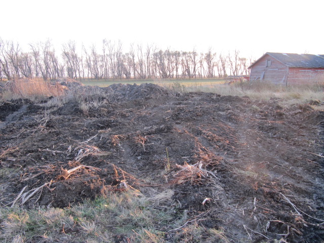

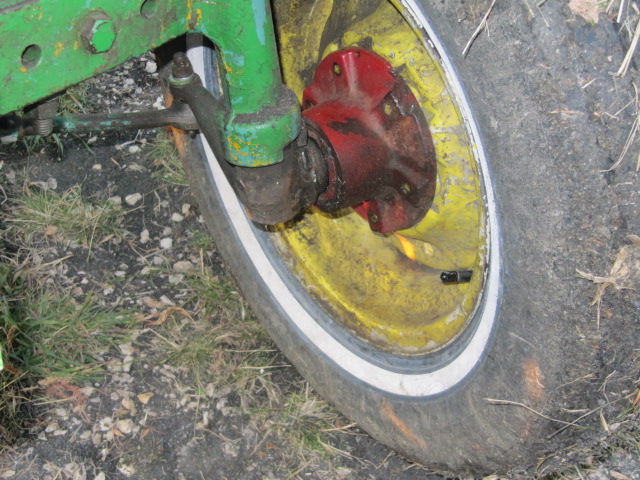

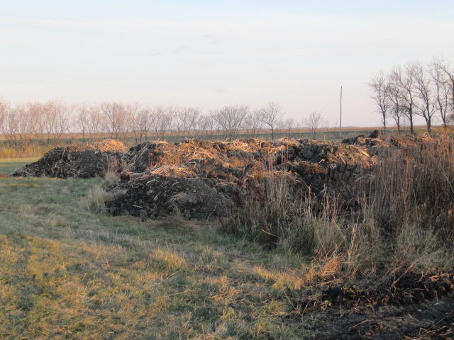

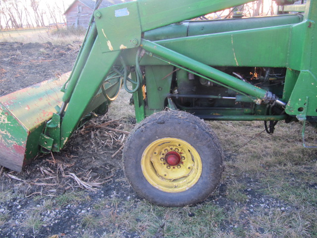

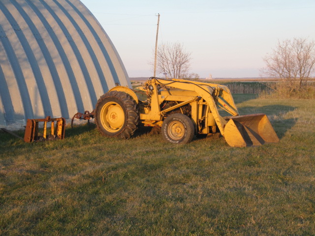

Yesterday and today I was finally able to get some seat time on the Oliver and put it through the paces. I had some roto-tilling to do and wouldn't you know it, that beast broke down.:mad: The drive chain broke and everything stopped. That was late afternoon yesterday. I put the fix to that and by noon today it was ready to go again and I was able to finish getting the garden ready for winter. I had to get that done before I tested the weight carrying capacity of the axle by moving some dirt.
I took the photos after doing some shoveling and IT'S HOLDING!!:thumbsup::thumbsup:
First two show the repaired wheel and tire (I pulled that out of a pile old tires we have here). The cash out-lay came to $35.00 and $20.00 of that was for the new tube.:thumbsup::thumbsup: As long as it holds that sure beats $250.00 plus shipping and brokerage fees I was quoted for a new part. Photos three and four show the startup of spreading some 2500 - 3000 yards of dirt we had hauled in. The last one shows the Ford sulking by the corner of the Quonset.:laughing::laughing: The Oliver simply does a lot better job of pushing dirt than the Ford. The Ford has chains on and when I'm using the loader to do heavy stuff I use the brush cutter for ballast. I just have the rototiller on the Oliver for ballast and I don't think it has a third of the weight of the brush cutter. Come Spring I'll probably put the Ford up for sale. No wonder it's sulking.:laughing:
