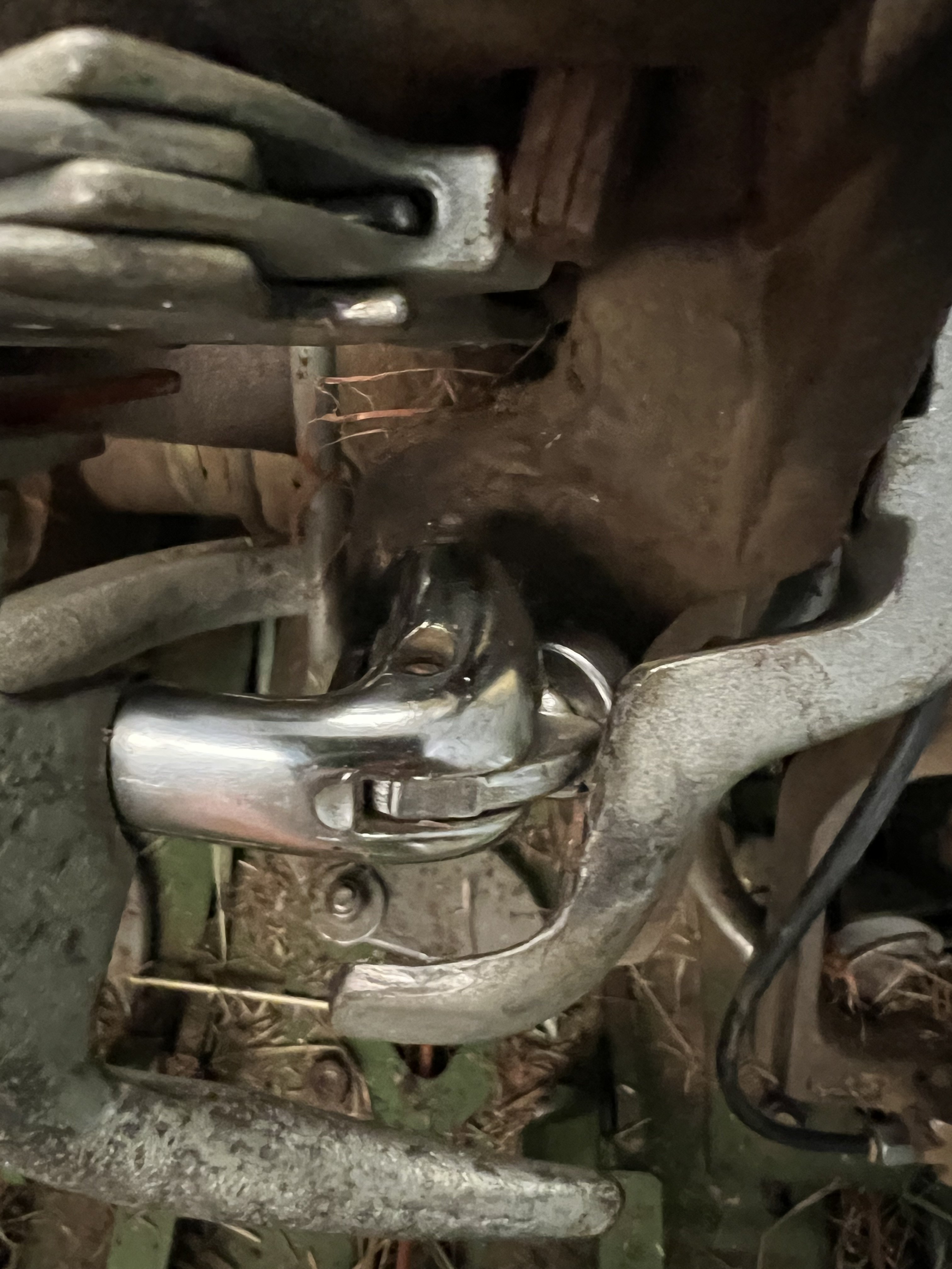

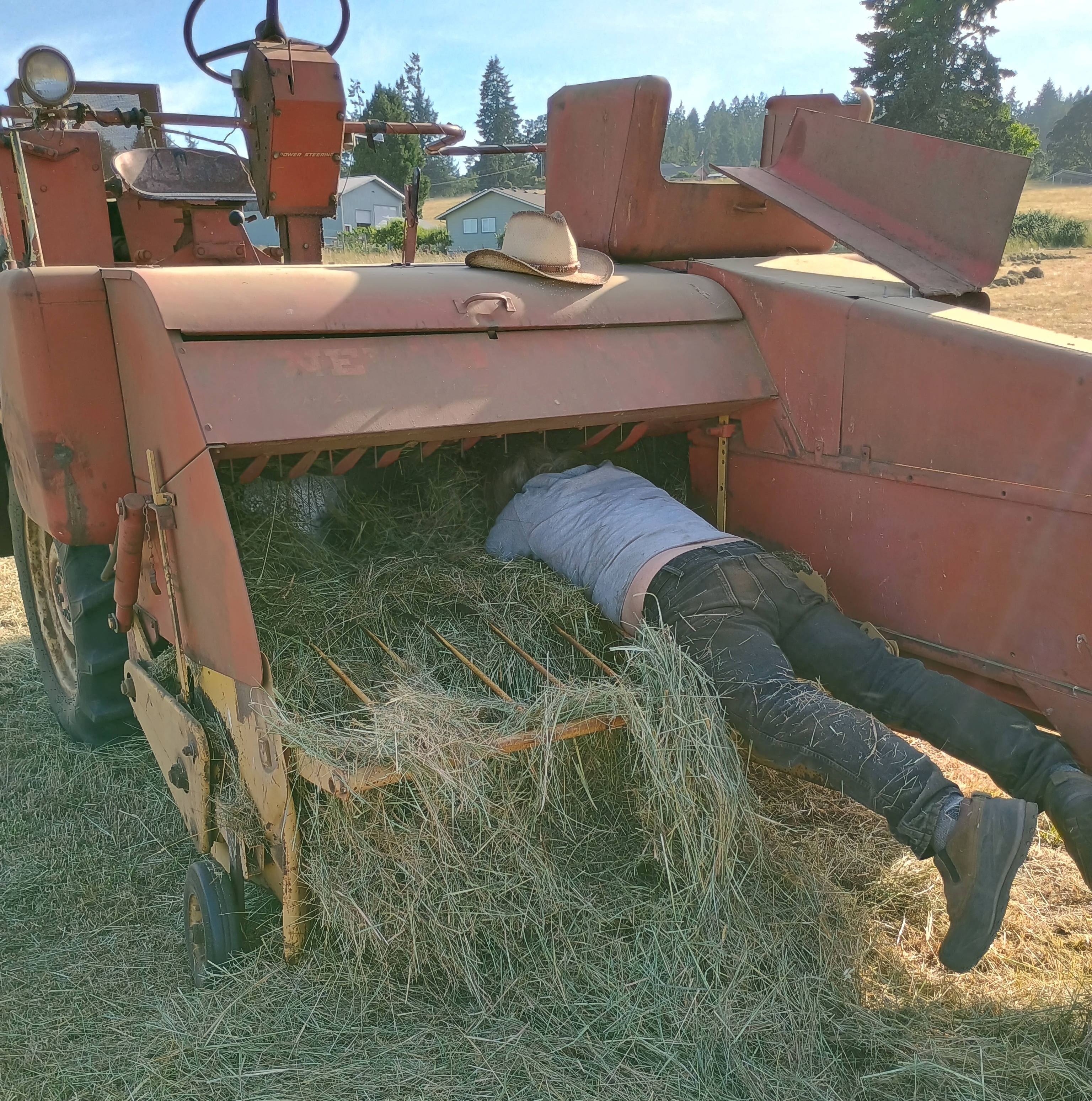

Ok, so I've broken a few bales, and bogged it down rebaling. No broken sheer pins, but had to clean out the feed chamber a couple of times.
I'm having a lot of troubles getting the knotters adjusted just perfectly.
If I get the Bill Hook tension too low, then I end up with half a knot. If I get the tension too high, then it doesn't release the knot. The two knotters aren't identical, and the right one is more sensitive than the left one.

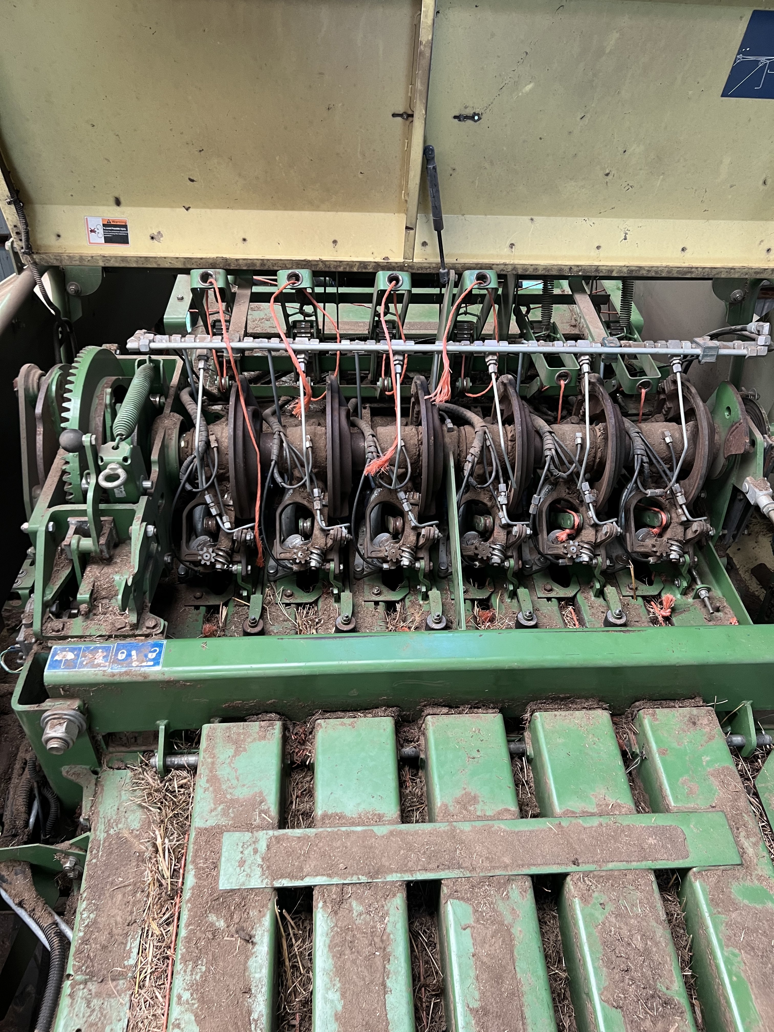

2 knotters is a walk in the park. Try 6 lol

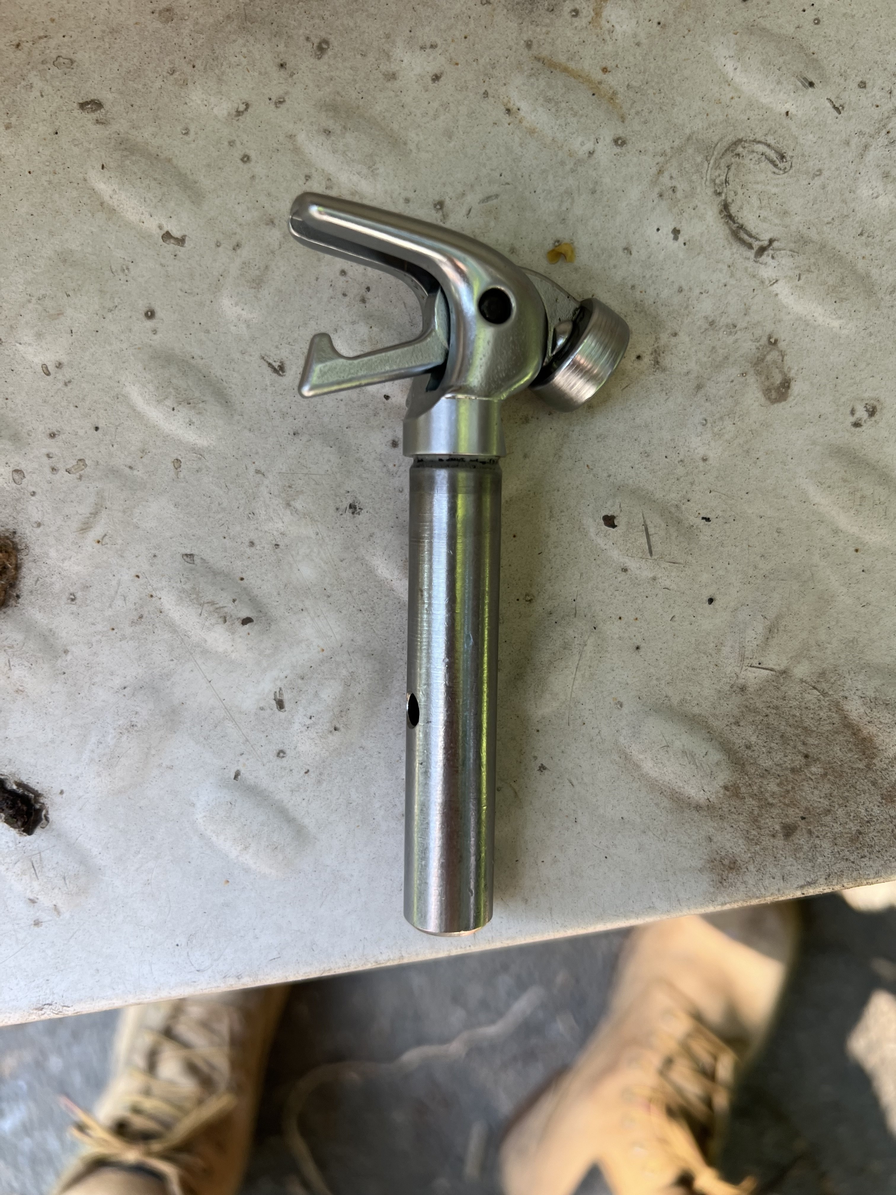

1749906434982-jpeg.3613767
That one is much flatter than my Bill Hooks. That is interesting.
I've sharpened my right twine knife. And the manual suggested blunting the bill hook slightly to make it close more. I did that, and a practice run yesterday broke only one out of a dozen bales (and I adjusted some after that as it only had a rough adjustment for the tension). Hoping for better luck today.
