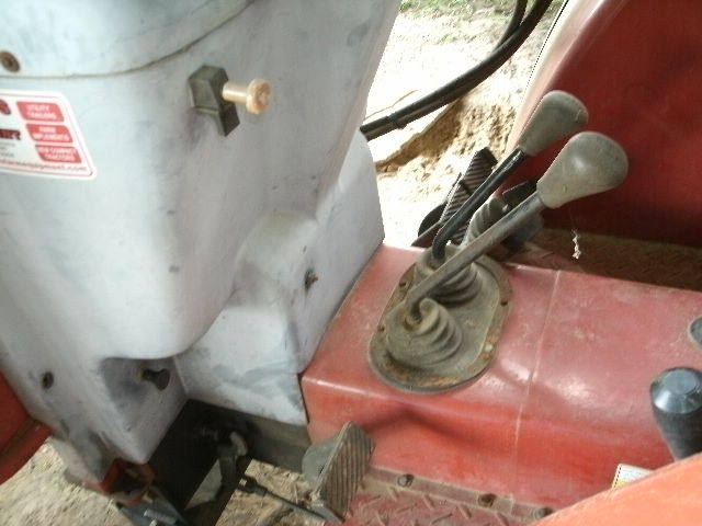

My daughter, recently separated, has asked me to do some maintenance on her Foton 404 tractor. Her ex used to take care of all this .

Can someone here give me a quick tutorial on getting this **** hood up ??

My hood release is a little pull knob lower left side of the cockpit plastic. A few inches up and towards the middle from the left step and almost directly below the emergency engine kill
   / Opening hood on Foton 404 #3
2000 model hood release, see picture below, BLACK knob ,lower left, hard to pull, hood will pop up on its own when released as it has two pressurised(sp) struts to hold it up. Not sure but picture may enlarge if double clicked.

Yupp exactly where mine is
   / Opening hood on Foton 404 #5
Well my 2012 tractor seems to have the bonnet release in a different place if I am reading the above correctly. Mine is on the left side of the tractor ( as you sit on it ) and is a black T handle just to the rear of the front wheel just below the bonnet panel itself. Its a lot easier to see if you bend down slightly and follow the edge of the bonnet from front to rear.

Hickory Creek, not that I know of by function, I am a first time tractor owner and the manual is a bit lacking as well. However if you look at the picture you provided in the center bottom I have a lever there that kills the tractor immediately when turned. It looks like yours is missing in the picture but mine has linkage that connects to the valve cover. I thought it was a different kill switch than the red switch because it kills the engine.
   / Opening hood on Foton 404 #9
That lever is the compression release used to facilitate easier starting. When you turn it, it lifts the exhaust valves so they stay open, relieving the cylinders of compression. The kill knob shuts off fuel flow to the fuel injection pump. You really need to order the manuals (three of them) for this tractor if you are going to use it properly and service it correctly.
