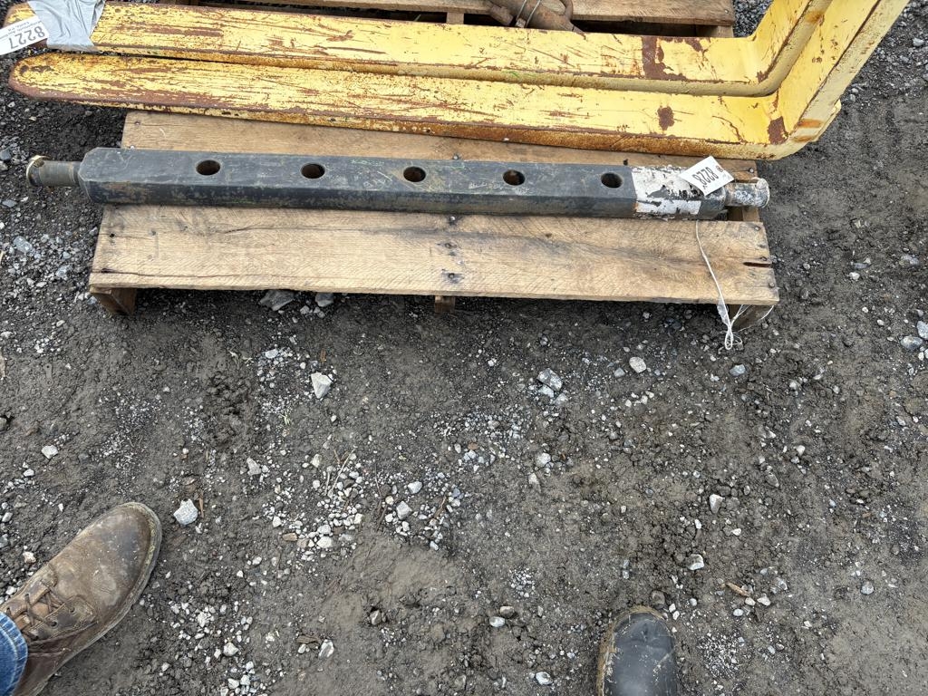

Missing a hinged floor plate from the backhoe to tractor.
3pt arms? Check if stored on frame.

Thanks Cal and Smokeydog - for the soot, oil and missing pieces. The oil maybe no big deal but it shows lack of maintenance but its a low hour machine so likely OK,
Yes, I also searched the photos for the light arms but could not find them. Thanks for catching the missing floor plate - I take a look and see what Messicks wants for that, or best case they just took off for pictures!
