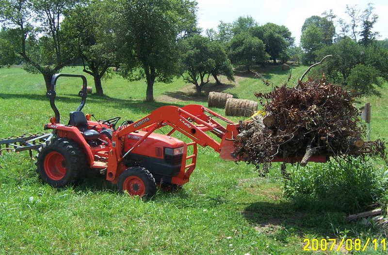

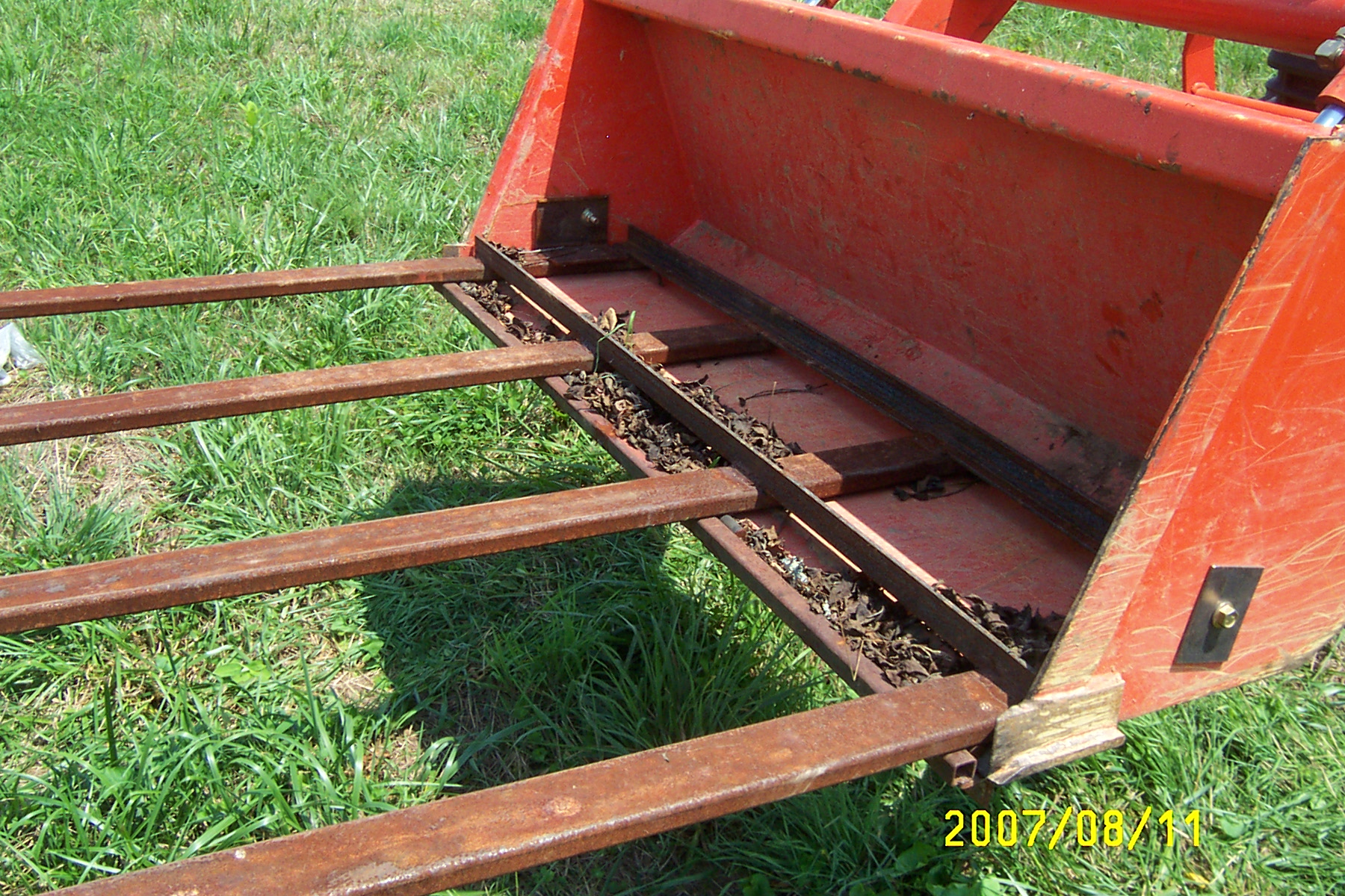

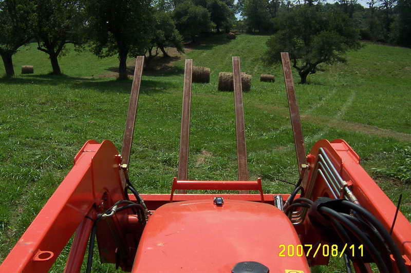

   / Optimal Shape of Brush Fork tines? #9
So my brush forks were a wee bit long but you can pick up a ton of stuff. It's rusting away (not sure where) once I got my grapple, these were forgotten about....

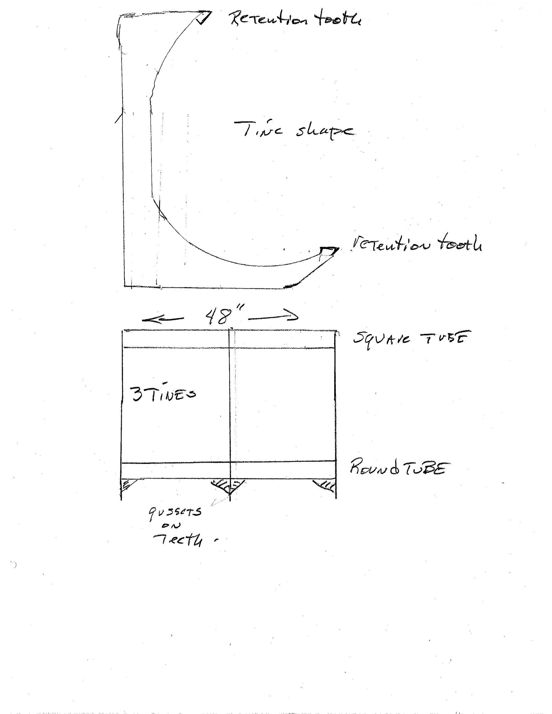

Honestly, that's a good design and a great example of the kind of forks that many have built here. Do you remember how long these forks were and what wall thickness of tubing you used? The details are worth noting here for anyone else thinking through the design issues.
Because I keep stabbing the ground, I'm sort of leaning towards a design that would act as runners that could be run on the round under the material but have a round tube to limit the depth that I could run the tines into the ground. I'm also thinking that I want something with a curvature to act as a cradle so when I tilt the tines backwards for transport, the material is going to want to stay in place. I would also incorporate a retention tooth at each end of the tine.
I think I need at least one center tine to keep from bending the front tube. Maybe two center tines?
I should have mentioned that my L2501 has the quick attach loader. My intention is to build forks for the QA mount so I am not limited by having to adapt forks to the Kubota bucket.
