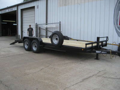

Thats a good price for a tilt bed car hauler. I just received my 20 foot car (tractor -no tilt) hauler from Trout Trailers in Porter Texas. It is a 12K GVW with 16" tires x 10 ply, dual 6000# axles with brakes on both axles with heavy duty jack on front with side wind, spare tire carrier and spare 10 ply tire, heavy duty rear stowaway ramps, 2 foot dove tail delivered to my daughters house with a temp. license tag for $3150 which was the best price I could find

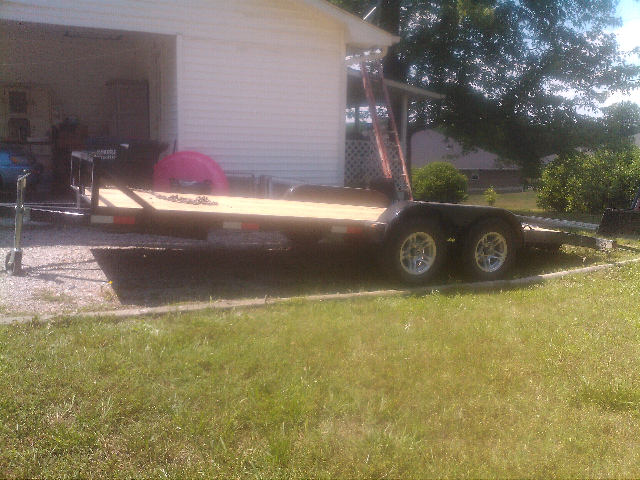

Those are some good looking trailers. I just had this one built, it's axles are only rated for 7500 pounds. And its not tilt, those are nice.

Nice wheels on that one. I have not heard of a 7500#rating dual wheel axles. Is it dual 3500# axles? or 5200# with deduction in capacity to 7500 net. Standard axle ratings are 2000, 3500, 5200, 6000 and 7000 for utility trailers.
   / ordering a new trailer.. #5
5 bolt rims, so I would guess 3500# axles and 500# of tongue weight.

Shoot man, maybe 7000#. 3500# axles I think is correct. But my buddy who built it said 7500, he may have mistakenly said that. But he did say if I ever wanna heavier trailer just some axles would be all I need. Trailer is built heavy out of tubing. It was manufactured at a place that usually just builds boat trailers.
