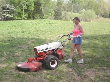

Gravelys (or DRs) aren't too tough to run; heck even a GIRL can do it!
