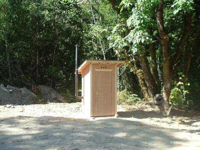

I spent 3 days of my 4 day labor day weekend building my first outhouse. It measures 4x4 on the floor and 7 feet high in front 6 feet in the rear. The roof is 6x6. I built it following the VIP latrine design with a tall black vent to suck air in through the hole and hopefully minimize odors. That chimney sure was sucking when the sun warmed it.
I had a large excavator out to my property to redig a deep ditch and while he was there I had him dig a 6 foot deep hole with his 3 foot wide bucket for the pit. The problem is that excavators don't dig holes, they dig trenches so I had a 3 sided hole plus a ramp. I built a wooden box cribbing and backfilled the box with the spoils. Drilled lots of holes in the cribbing. The seat is nearly 2 feet above the top of the cribbing so it is an 8 foot drop to the bottom. The thing about a deep outhouse pit is that if you somehow fall in, you ain't getting out which may not be a concern at your home but at a remote property I worry about liability.
We will have about 50 people out this coming weekend to get a good start on filling it up. Most will have RVs to poo in but might prefer the ASHAUS rather than stinking up their campers.

Ive dropped a few tools down there when building easy enough to get down when clean.
I don't think you want to use your ashaus as an RV dump The amount of waste will be unbearably nasty/melly and won't break down very fast, if at all soon. normally you "go" put on the ash/lime/sawdust and repeat esentially composting it without turning. you may even contaminate you ground?well?seepage somewhere? plus your ashaus would fill up quickly.
For RV you could bury a plastic/metal drum or two and create a small leach line...inturn you would have a mountain septic as we call it.
