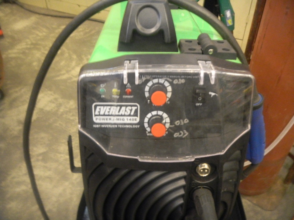

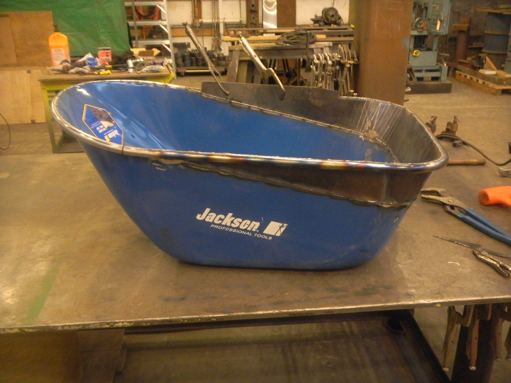

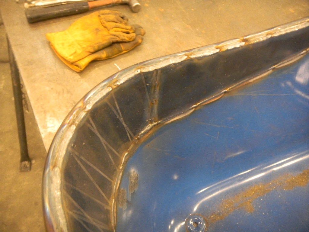

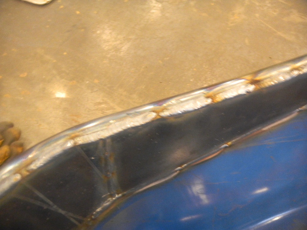

A guy ask me to help him put an extension on a wheel barrow tub. He is going to build a power wheel barrow. The tub is 17-GA, the extensions are 16-GA. The top rail is thin wall electrical conduit. He has a Everlast Power Mig 140E.
Trust me I've never been good at welding this thin of metal:eek:, but this 140E with .023 wire is making this project a piece of cake. Very impressed with this Mig welder.:thumbsup::thumbsup:

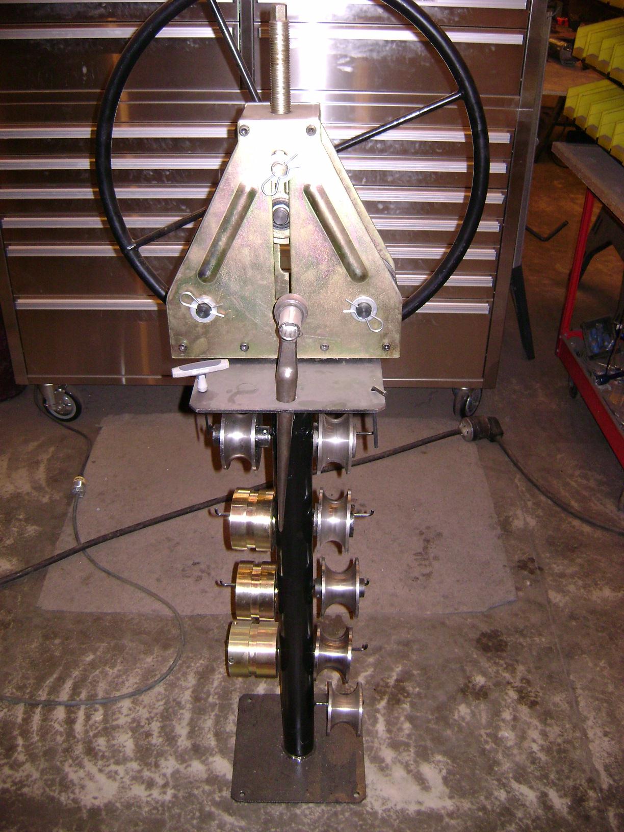

Very cool project... did you heat and roll the edge? Would love to hear how you did that!

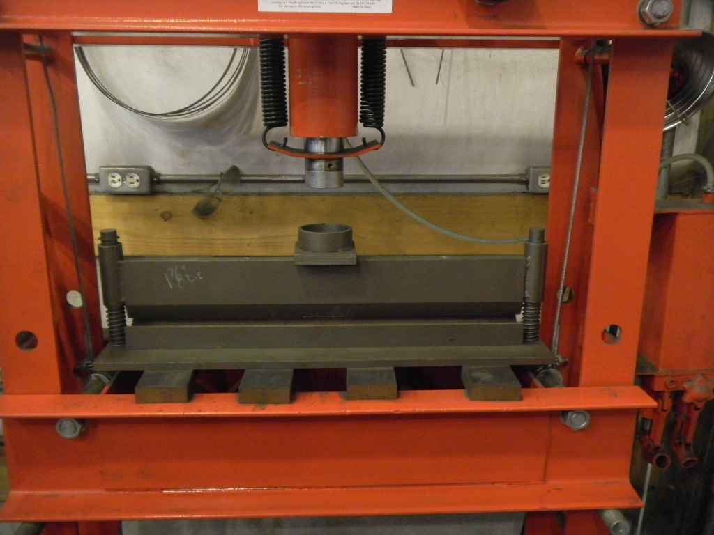

   / Out of my comfort zone.
Used the break and shop press for the 16-GA extensions. Used the roller for the conduit.
Gotcha... I had to look again at the original pics... I first thought I saw the you were forming the rim in place which I thought was crazy... but I wouldn't put it past you! :D

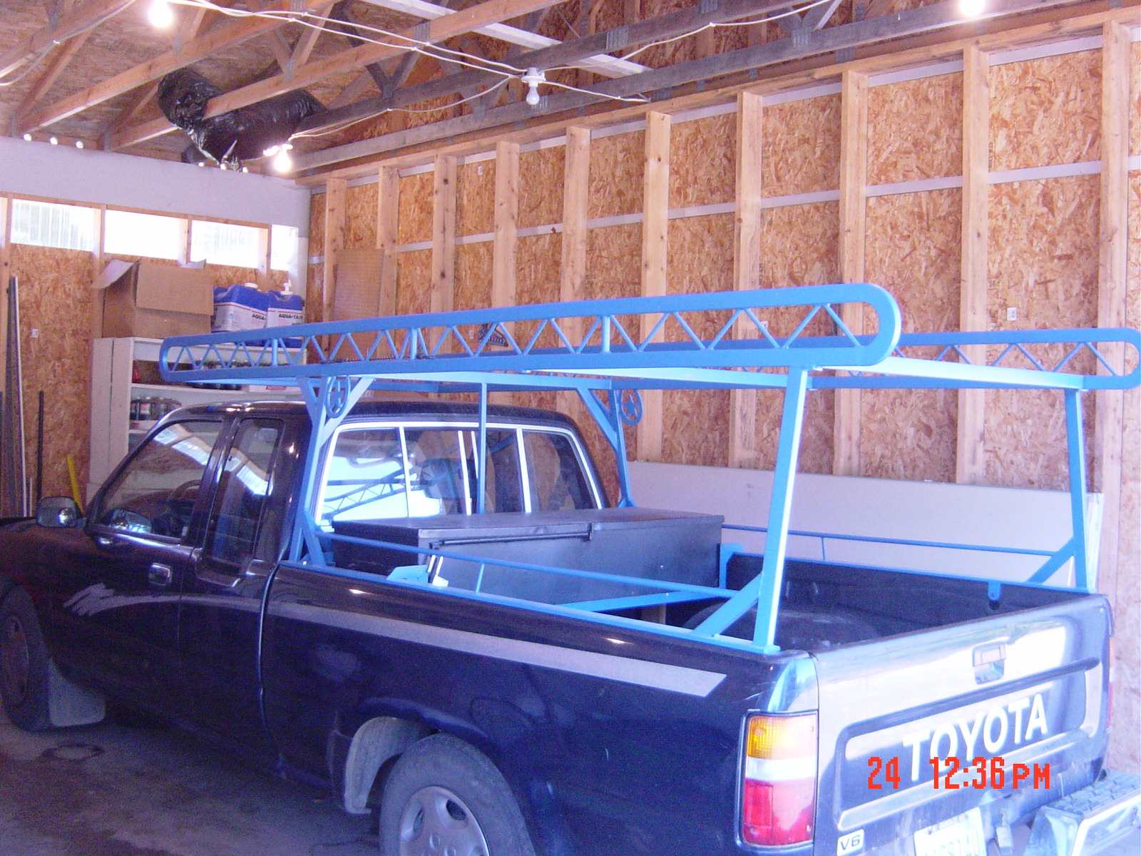

When I built this lumber rack. I had a Linde VI-206 Mig welder. I had nothing but trouble running .023 wire in it:thumbdown::thumbdown:. If I would have had my Miller Dynasty 300 Tig machine at that time I would have just Tig welded the whole thing.
