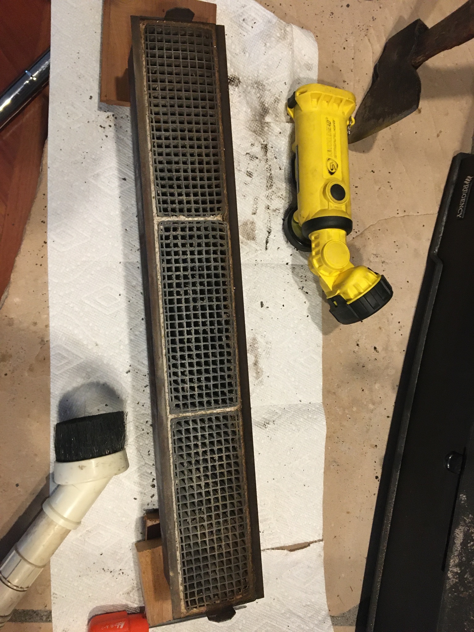

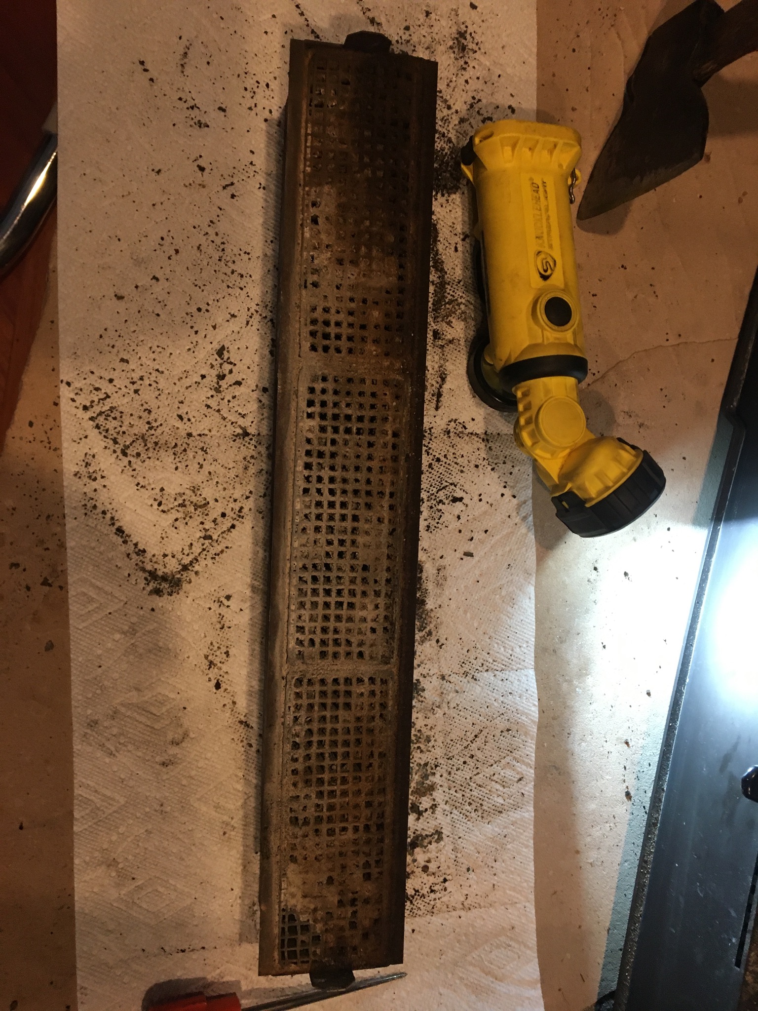

Well my EPA Certified CAT stove was refusing to burn, or at least refusing to at anything above what amounted to shut off combustion air. I noticed it was not putting out much heat the last few nights but our weather moderated so I was not too worried. This morning I had a heck of a time getting much heat out of it and noticed pretty quickly that the wood burned well when the CAT bypass was open, but not with the fumes going through the CAT. So I stopped feeding it and let it cool down. Sure enough, the CAT was plugged. For those that are lucky enough not to have to have an EPA stove by code, the CATs are a cartridge that the fumes go through that generates more heat as the byproducts combust on it. The tree (unsure of species) I am burning now is not CAT friendly apparently. I typically run all season without plugging and a vacuum cleans it up. Not this year. So I am leaving it out until I get this tree burned up. Before and after pictures with a basic vacuum job.
