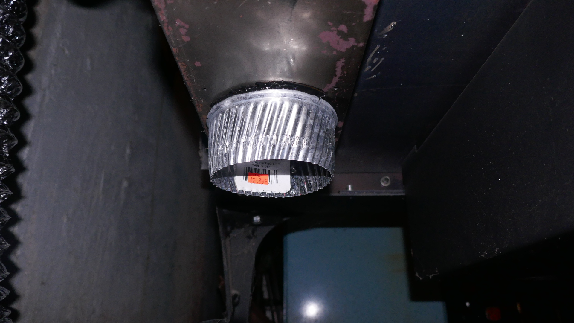

So I installed an outside air intake for $25. Drilled a 4" hole through the sill and attached all the hardware and tube directly to the specified port at the bottom of the wood stove. I rigged it so I could shut it down for comparisons. Ran like this for a week. Here is what I found for my particular set-up:
1.The oai did absolutely nothing for the temp of the house. Temps remained the same with it or without it.
2. With the oai running, wood was used up in half the time. What was previously an 8 hr load of wood became a 4 or 5 hr charge.
3. Here is the most important thing: although the temp in the house did not alter between the two methods, the house "felt" warmer without the oai being attached.
I believe the interior currents of the house allowed an air flow that was more sweeping toward and around the wood stove which carried more surrounding heat for the rest of the house as the stove was using interior air for combustion. I have no proof of this but it is what it felt like.
Convection currents were much quieter in activity with the oai and thus, so the heat movement. My stove is considered a "convection" type as opposed to a radiant type with most of the heat coming from the top off the stove.
I'm glad I tried it and it was worth the small investment to find out.
For my particular set-up, an oai was not conducive to a more comfortable house.
Also, I was not a fan of the reduced time of burn.
What was interesting is that the wood stove had a better draft when I left the 4" pipe adapter at the borttom of the stove. I guess this kinda acted as a "carburetor spacer" would to create better air flow into the stove. And yes, even this reduced burn time but not nearly so much as with a direct outside air flow coming into the stove.

^ Thanks for Sharing your experience!

Its really hard to measure the differance a Outside Air Kit makes in just a week. Change in firewood, outside temp or damper possition just to name afew can skew things. Bot to mention how well the house is sealed.
For my house a 1930 house that we rehabbed about 6 years ago an OAK made my house alot warmer, less drafty and i burned less wood. I built mine my self out of metal from my garage and a piece of aluminum dryer duct.
In theory these have to work. Your chimney constantly has air from your house going right up and out with out one. That air is alreaty heated and is now replaced with cold outside air. If your house is so tight you dont think your getting cold air in you would also not have smoke going out the chimney, it would leak out of every crack or seam in the stove.

Do you have an airtight stove with draft control on the outside air??
Yup. Deezler makes a good point about the door seal. I replaced mine about 3 years ago and door still seems tight to shut.
The point nyone makes is also valid about using it only for a week. The difference was so out-right, I didn't need further experimentation.
House was "less" comfortable. House being a log home is super drafty but the house currents were more "still" with the oai. Stove being in the cellar may have made the particular difference as opposed to being in a living space. The heat output was simply too "unidirectional" going straight up. It seemed to need the extra pull of yanking interior intake air and moving heat around better.
Whatever it was created a noticeable difference. Perhaps the largest detriment for me was the extra wood being used. The week I made the study had a couple nights in the mid teens. Both following mornings the main floor of the house was at 64* with and without the oai. Coals were considerable less after the 8 hr nighttime burn with the oai.
No matter what premises anyone makes on this forum, the one thing that remains constant is "the devil in the details". What works for one doesn't necessarily correlate for another. That is why I tried to include my situation with particular set-up.
