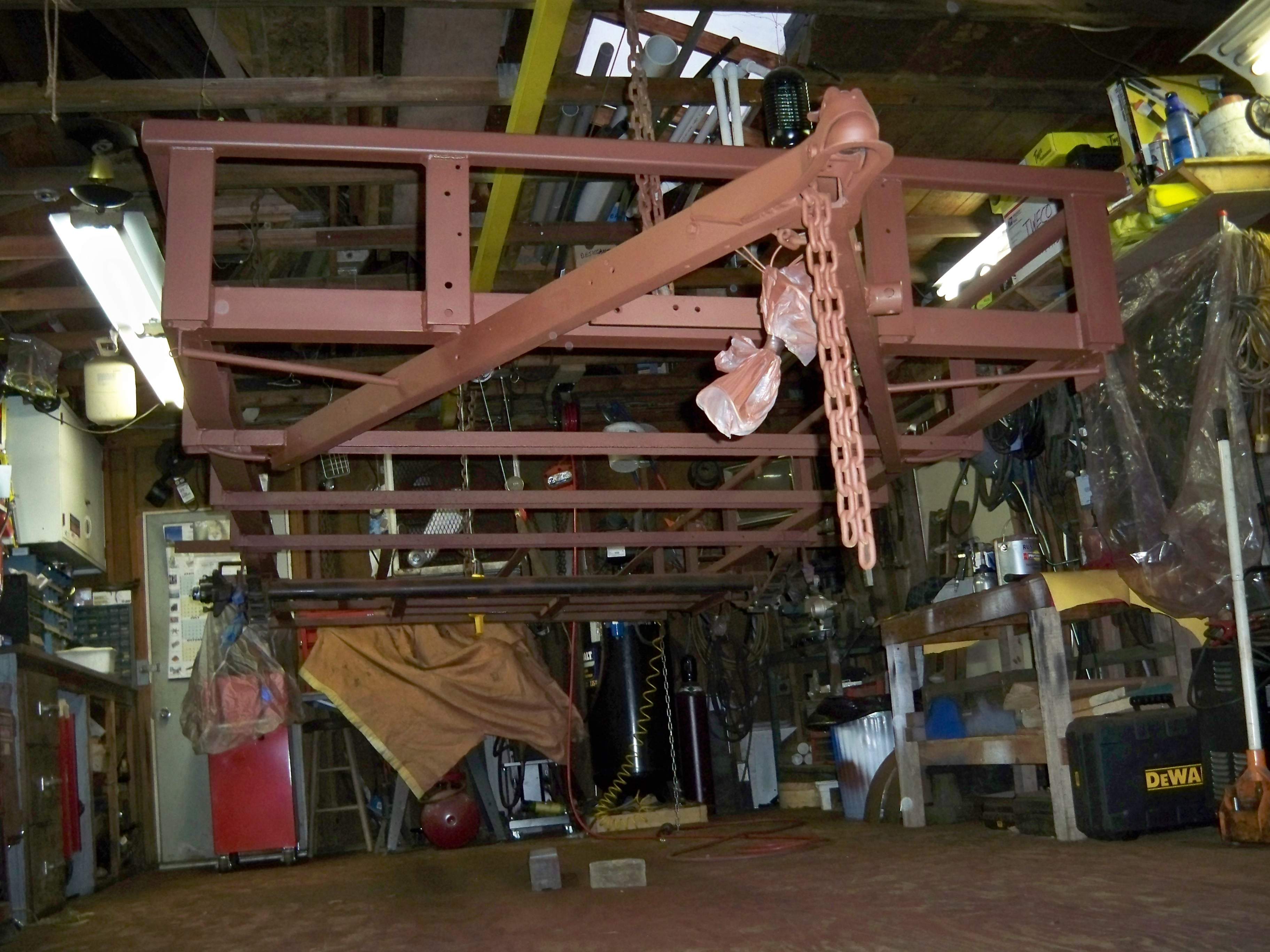

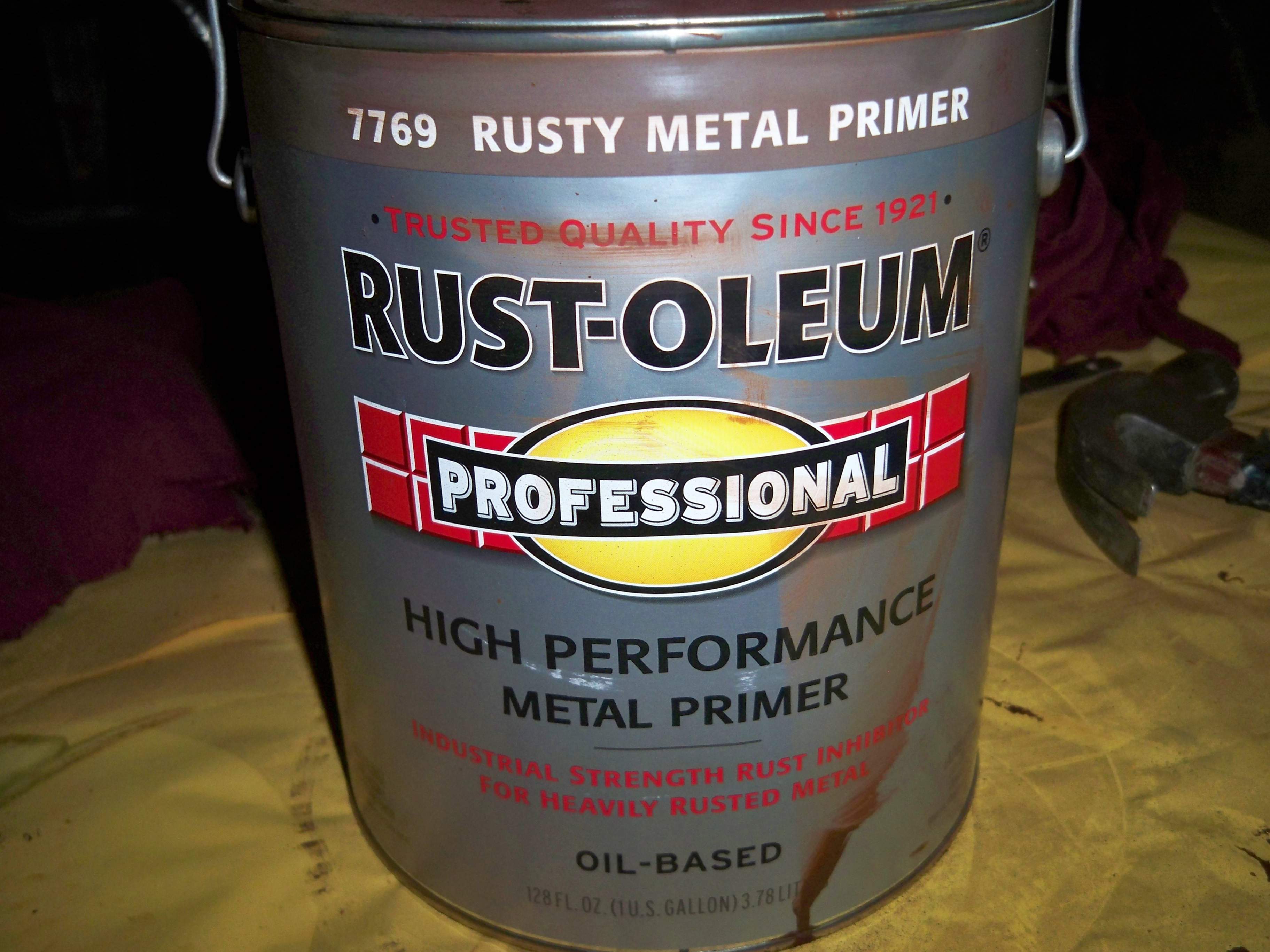

I've have good luck with Rustoleum rusty metal primer from Lowe's at about $28 a gallon. Good coverage, good drying time, and easy sanding. I have applied it directly over rust for something that didn't need it but have also used on prepped metal if cleaner finish was desired. All done with old siphon feed spray guns, most all now are gravity feed. Just remember to mix to the right viscosity, apply in thin coats, and not all at once so paint can cure properly.

I wish the company that made my 2 axel trailer would have primed it like you have done!!
