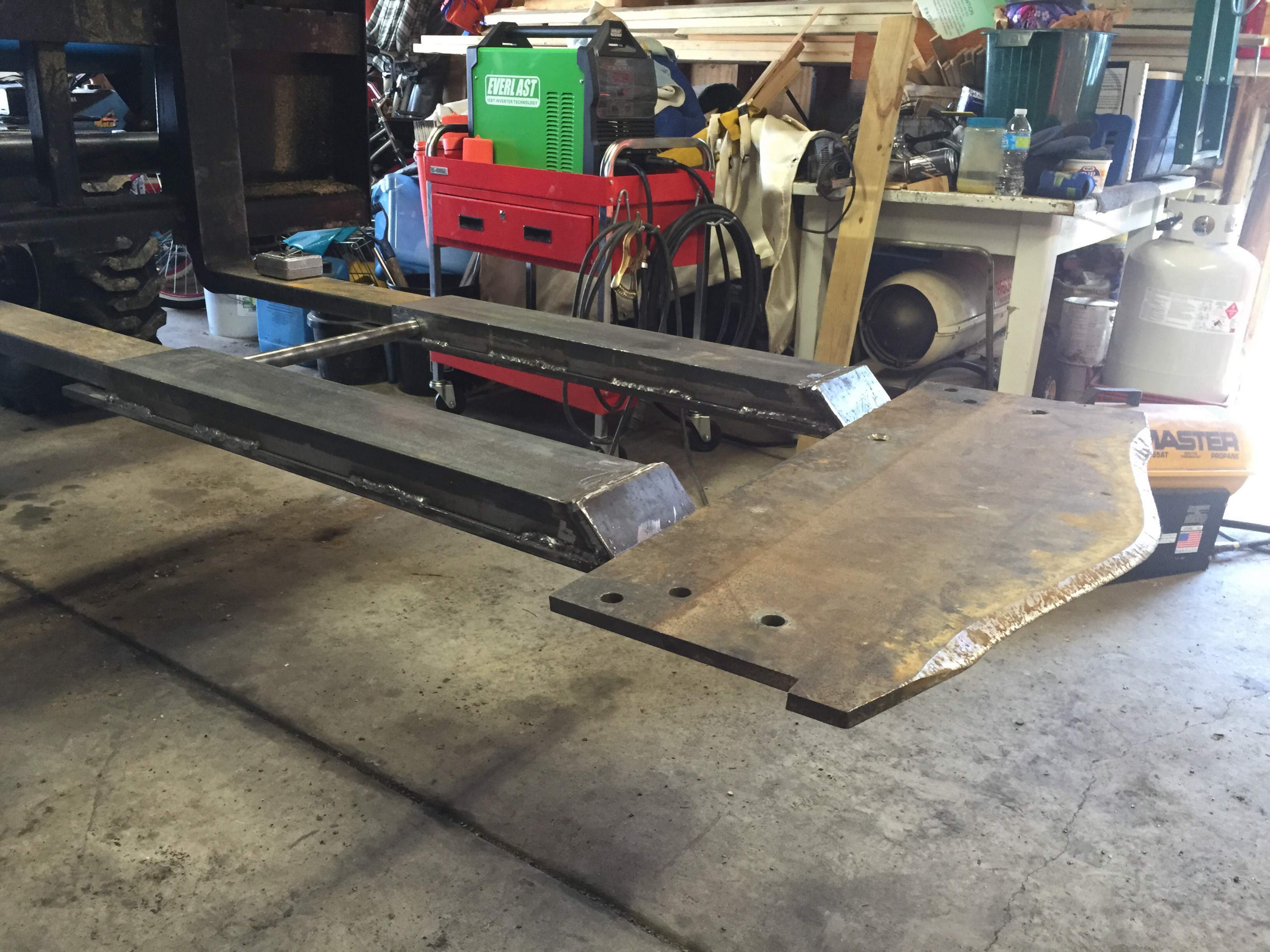

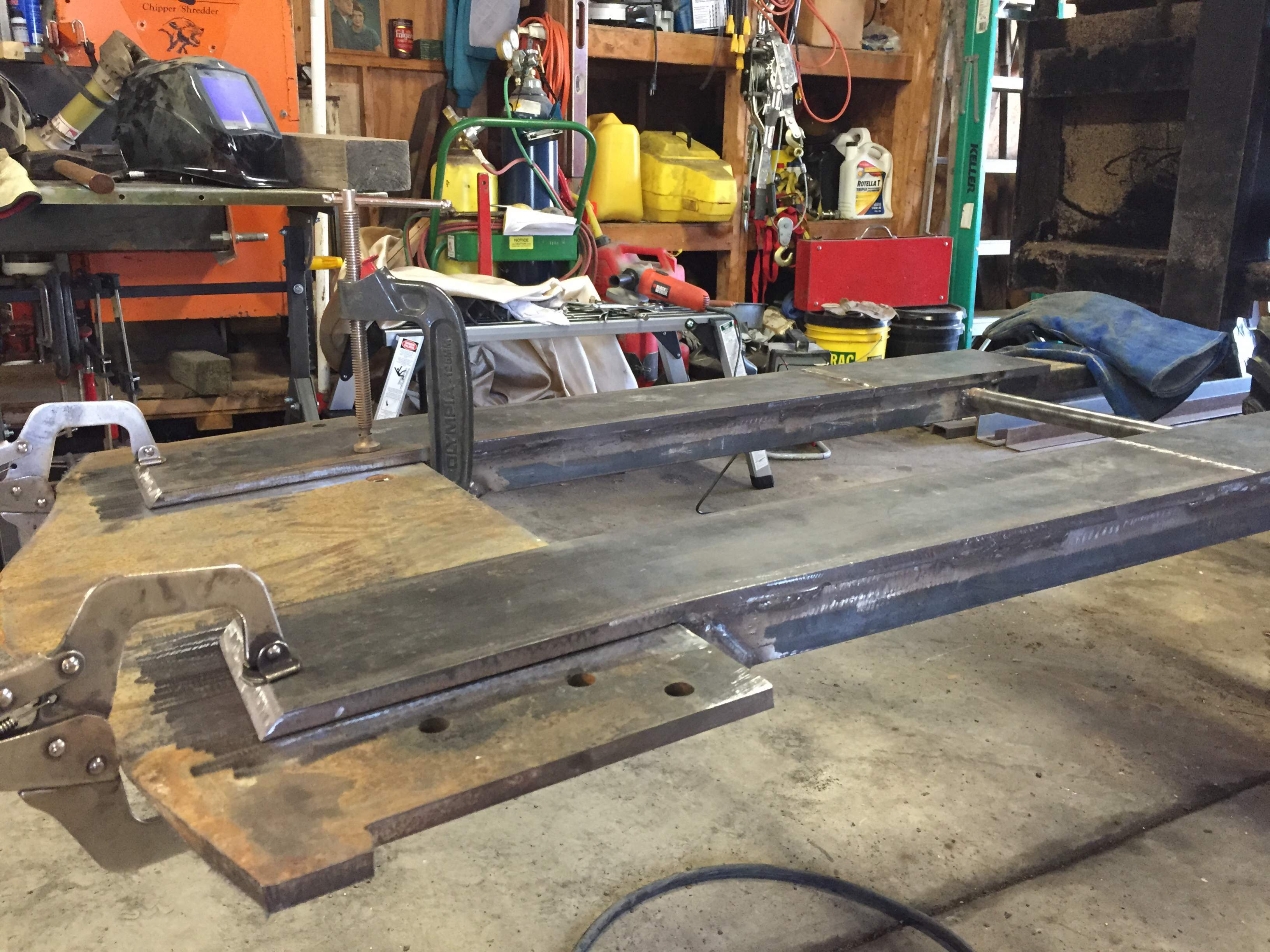

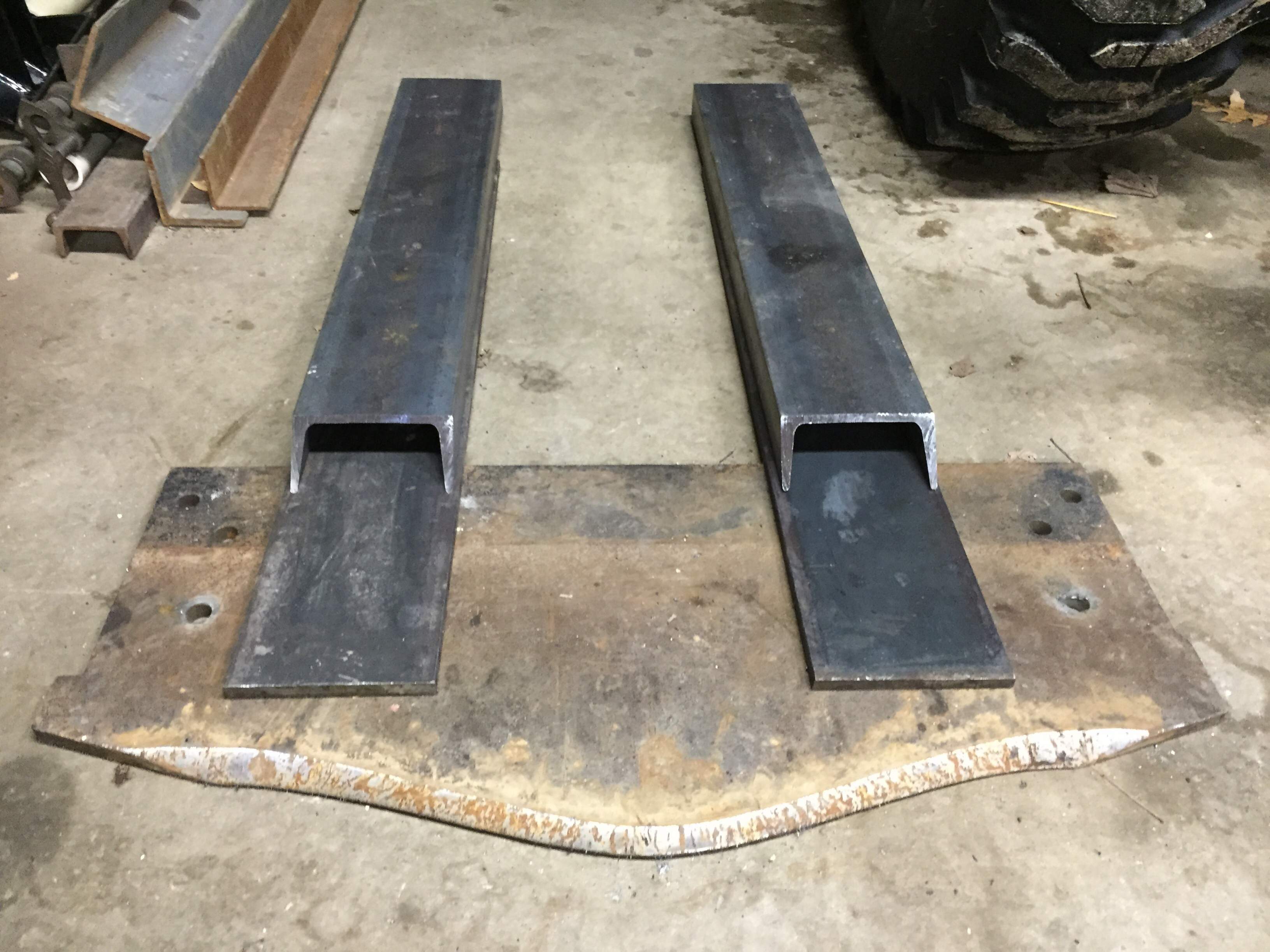

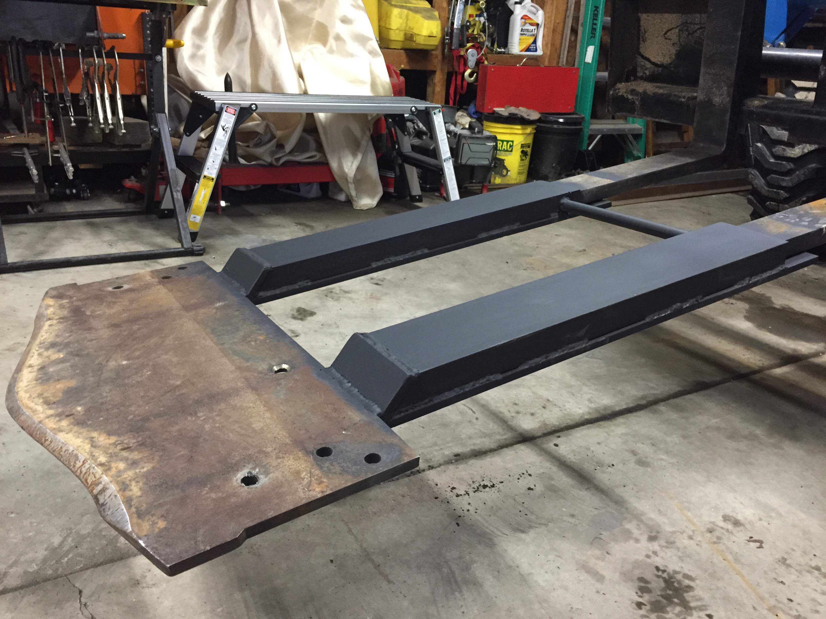

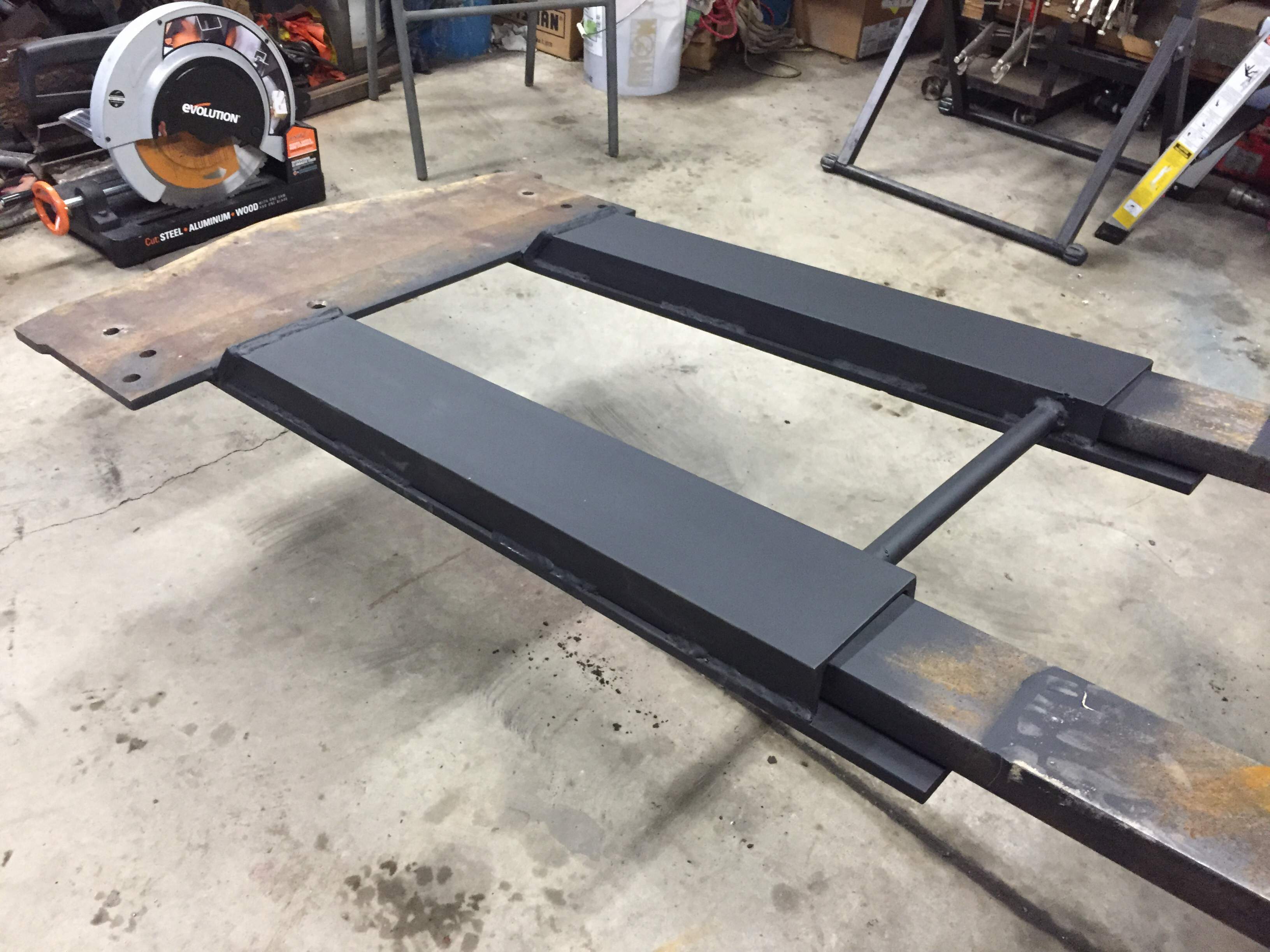

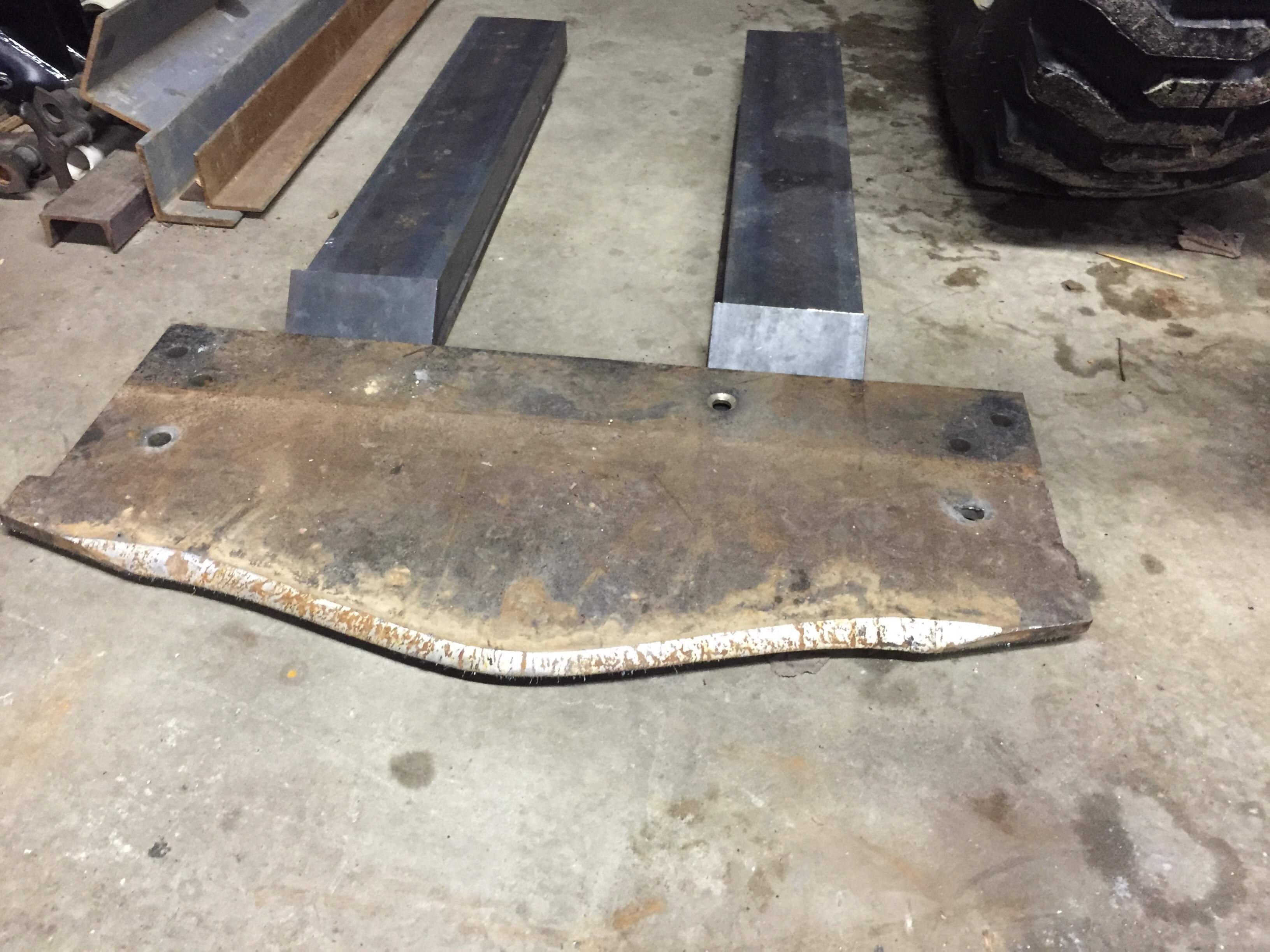

I stopped by my local scrap yard and found this piece of 1/2" plate with a beveled edge on it and thought it would make a good spade/shovel attachment. They also had some nice 1/2" x 5.5" plate and some 5" channel. I have been wanting to build something like this to slip on my forks to pop out some nasty thorn bushes we have growing all over our place. $46 worth of scrap steel in it, and lots of much needed welding practice! :)
