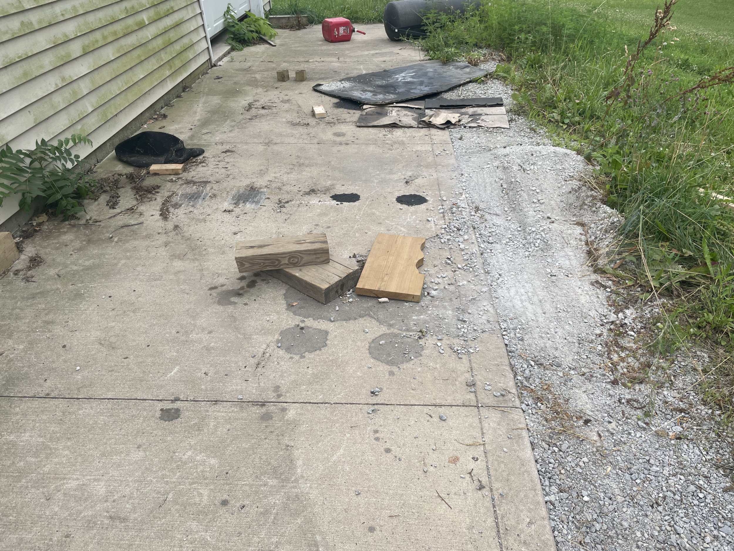

Anyway, I couldn't get the air brakes to release the parking brake before leaving for our most recent trip. Three wheels were fine but one of the rear duals was still locked. This was after sitting for about 10 months. I have never had this problem before. I read online that I need to knock them loose with a sledge, but you really can't get to them. I hired a guy from a local repair place and he thought he was going to fix it with 2ft rod and a hammer and ended up needing an air hammer. Even then he only got the top brake shoe loose. Then we needed to use the engine to break the other shoe loose. The problem is that my bus sits with one pair of tires on gravel.
The locked tire was on the left of the picture on concrete and the pair that would spin was the one on gravel. As you can guess it dug a hole. I needed to jack up the rear and replace the gravel before it finally came out.
Suggestions on how to avoid this in the future? The truck place said I need to move it once a month, even if it is only going 10ft. That isn't really an option in the winter here. I think last year I moved the bus after a week of working on it in the driveway so my theory was that the brakes were cold and it was a damp day. This time I drove the bus enough to get the brakes hot before parking it.

Yes, they are all greased and once the shoe was unstuck from the drum the brakes operated smoothly. But yes it is probably time for me to go crawl around under that thing and grease everything again.
Shoes just rusted to drum and need a little coaxing. Make sure they are off so you can tap loose.
I am not sure you are really picturing these things. ;-) The drum is 16.5in diameter and the shoes are 10in wide. The backing is heavy steel and the material is at least 3/4" thick. They were rusted to the drum and "tapping" won't be noticed.

In this case, these are old Rockwell Coach brakes. There isn't a dust cover and you can directly see the shoes from under the bus. Unfortunately, they are mostly blocked by this train-like frame that holds the rear differential and the 4 air shocks that hold the coach itself.
When I say we pounded on them with a 2ft rod and a sledgehammer that was directly on the shoes themselves and they didn't budge. With everything fully aired up and the brakes disengaged.
It took an air hammer on the side of the shoes directly to get them loose and then only one of them because we couldn't get a clear site of the other shoe.
To address another comment removing the tires is a major undertaking that I don't have to tools to do and doesn't actually provide much more access to the shoes. Just a nicer place to stand while working.
