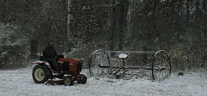

   / pasture rake? #8
Like this?
   / pasture rake? #9
That's the ticket. That's known as a dump rake in these parts. Meant for horses (as in one or two) so don't overpower it.

   / pasture rake? #10
del,
Would that have been an dump hay rake or side deliver hay rake.
