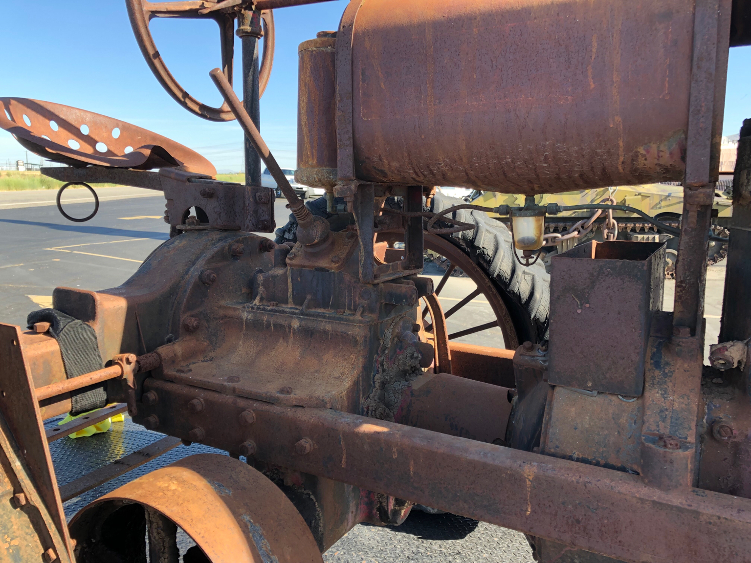

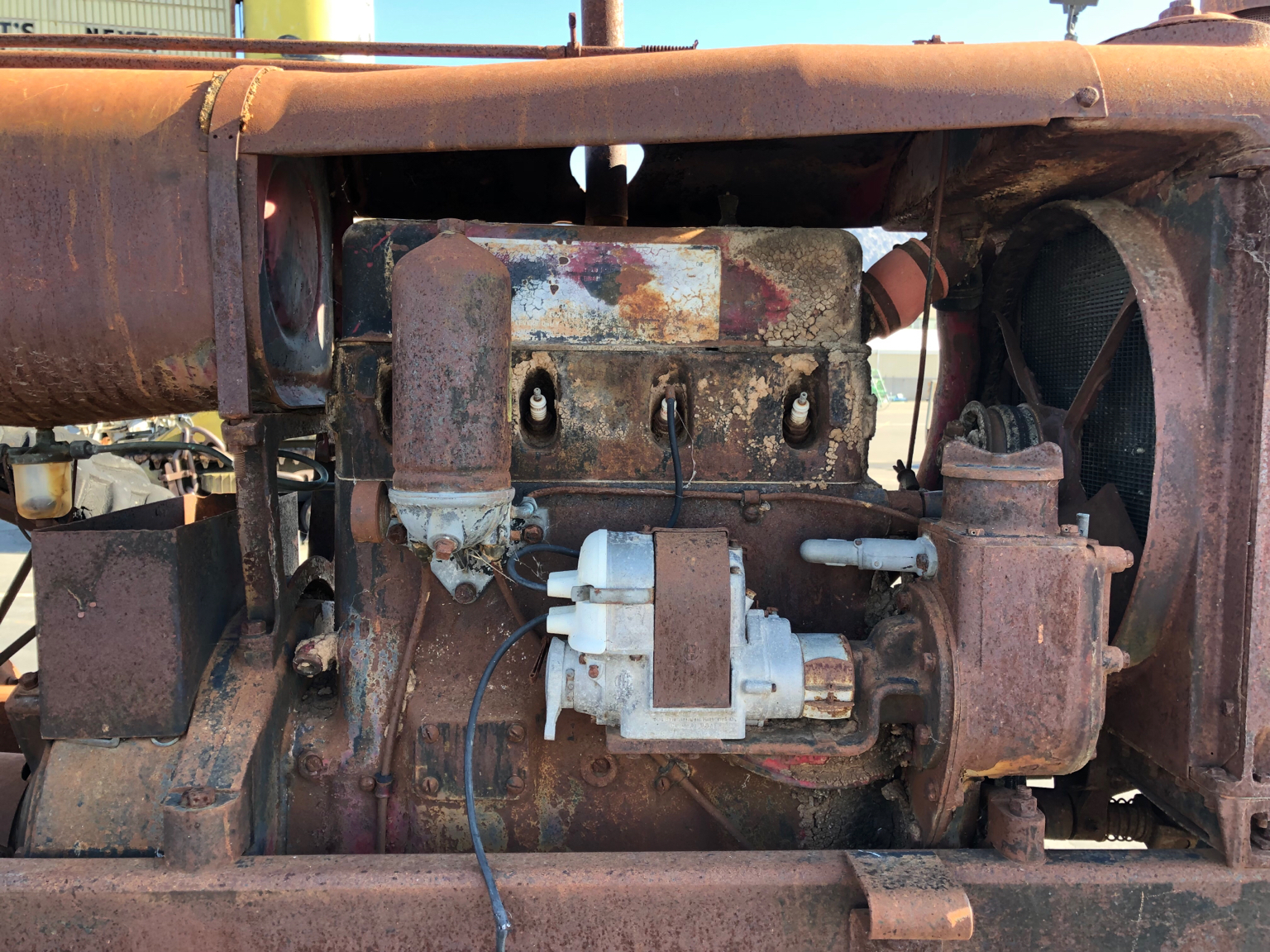

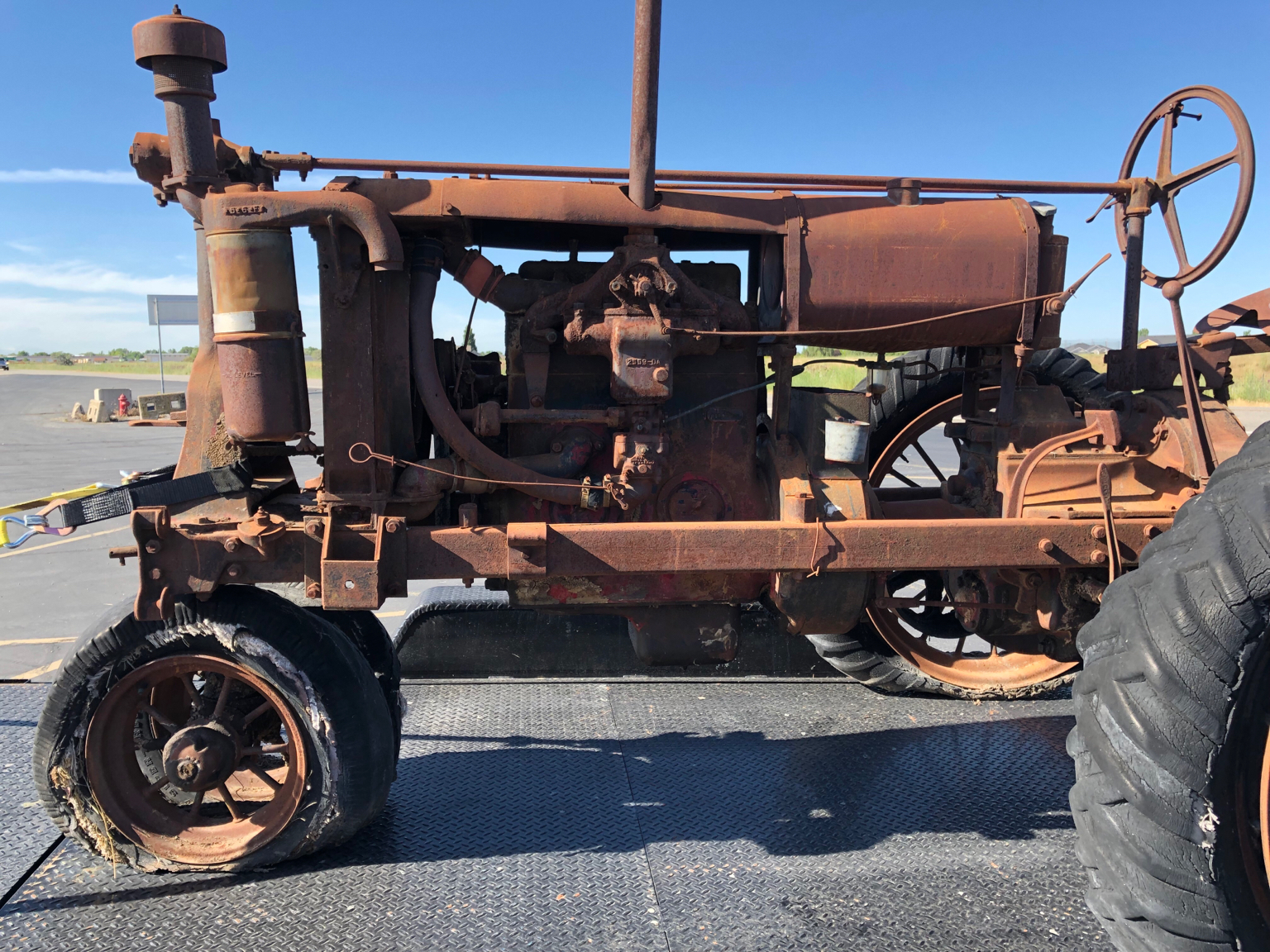

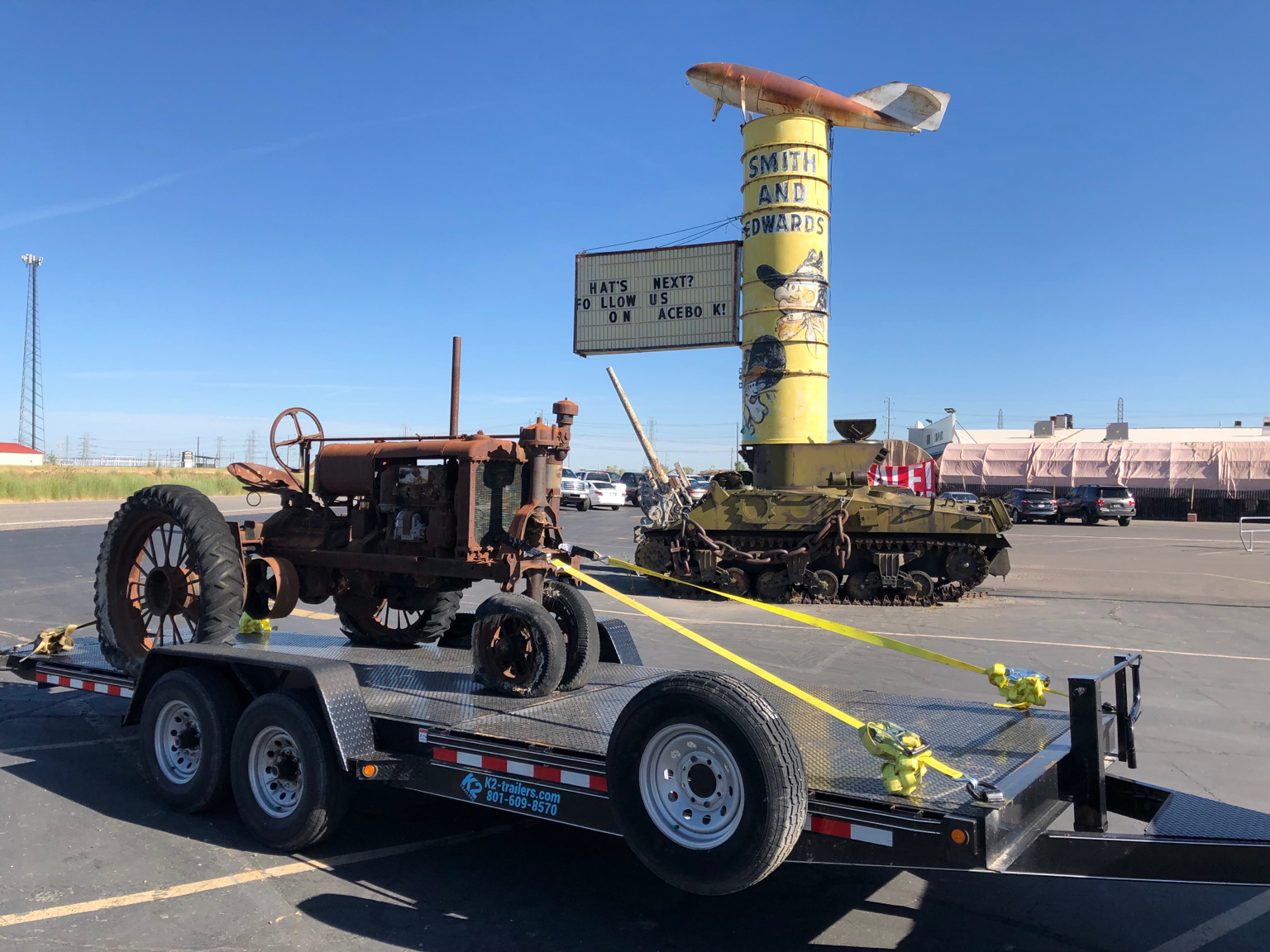

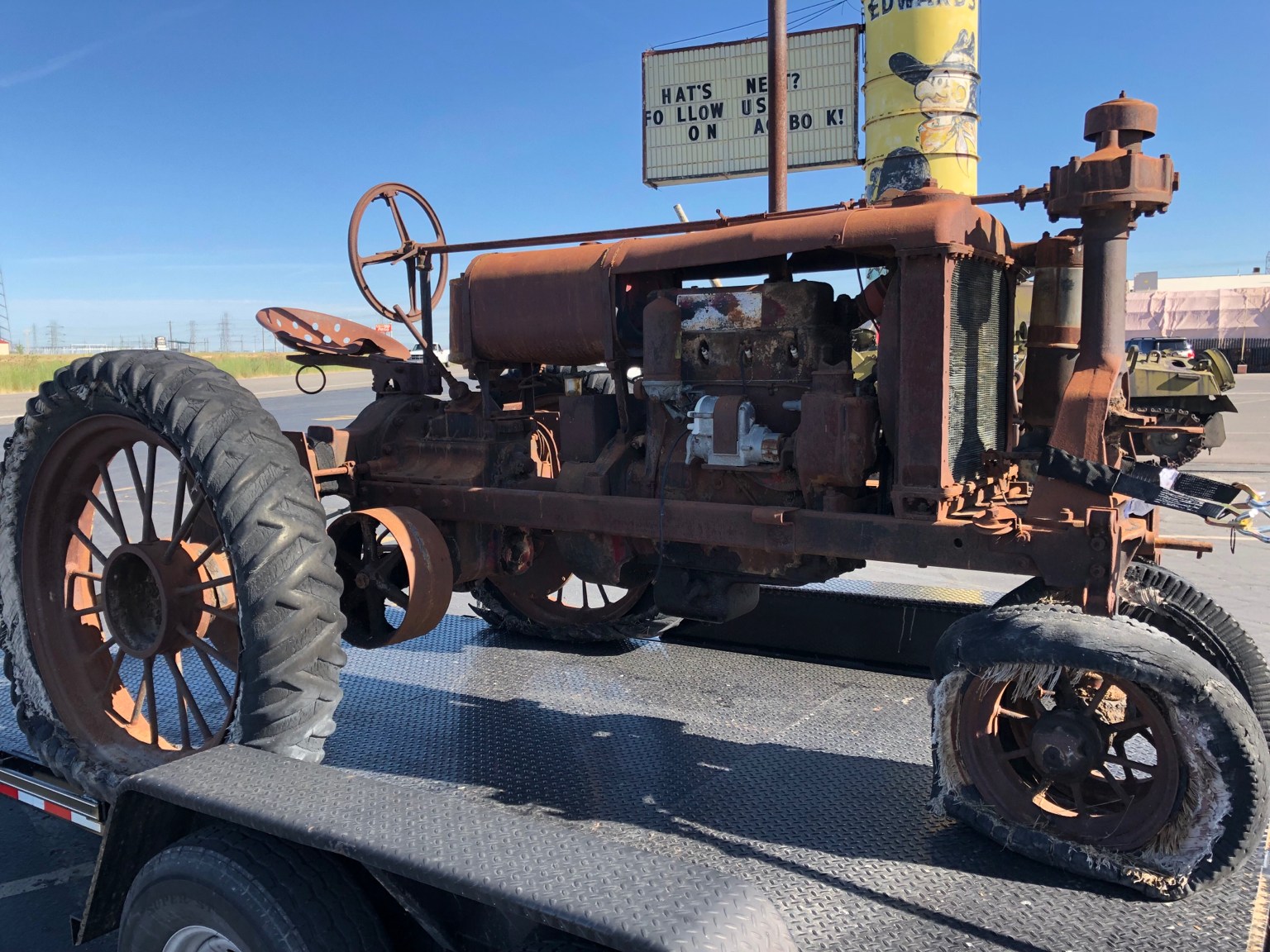

I’m not sure what year it is, but there is a little red paint on the steering gear support, so I think that means it is 1936 or later. I haven’t found the serial number yet.

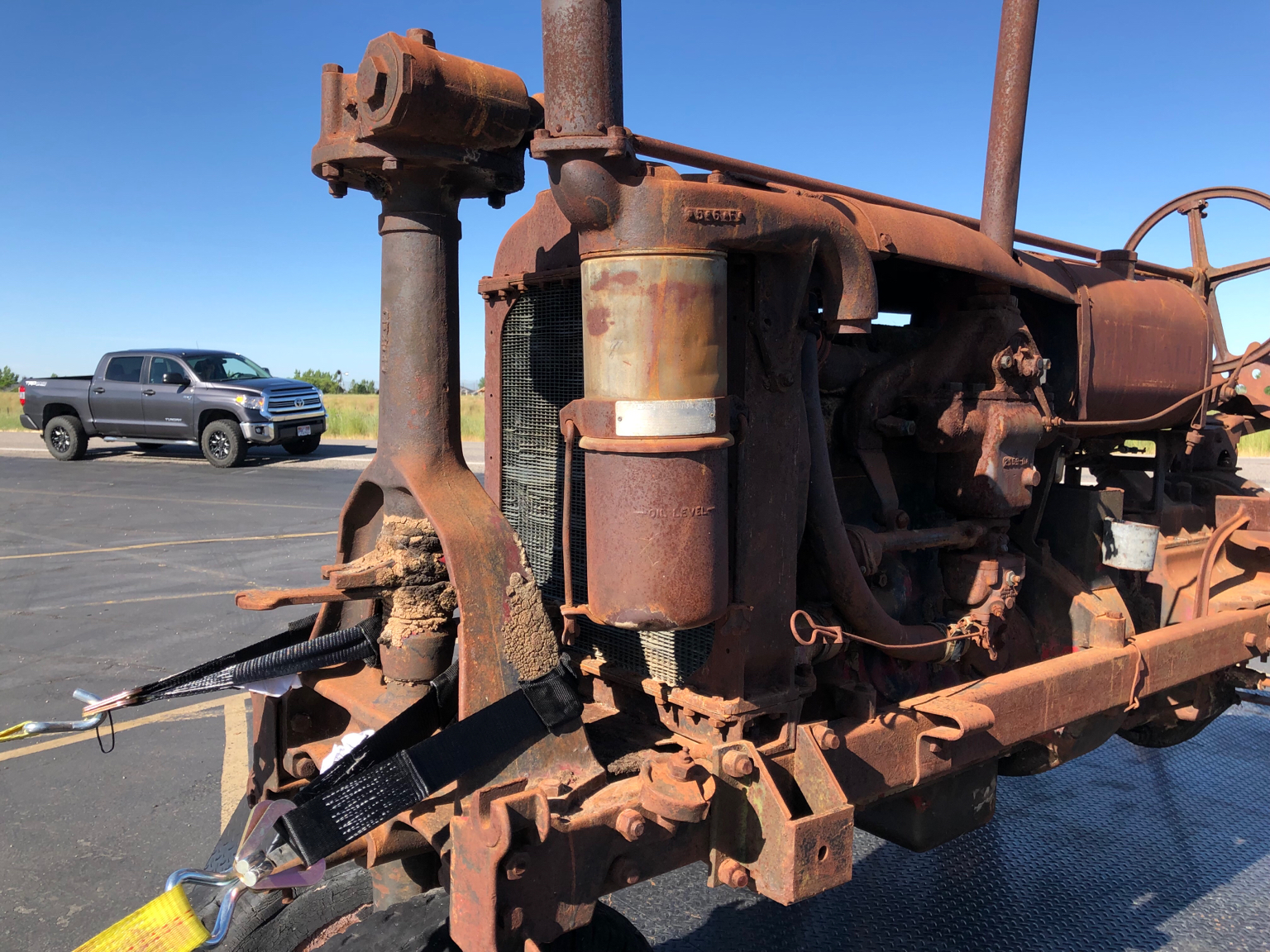

It had been sitting for a least 20 years, but the guy always had intentions of fixing it up, so the exhaust was kept covered, all the caps are on tight and the intake hose was disconnected and stowed under the radiator. The engine rolls over, the clutch seems to work, the PTO lever moves, the gear selector finds 4 gears, the left brake works, the steering works, and the front wheels turn.

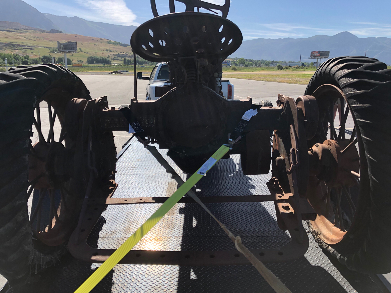

The guy had a big service truck and we picked it up with some straps and set it on my trailer. Should have had the wife shoot some video of that.

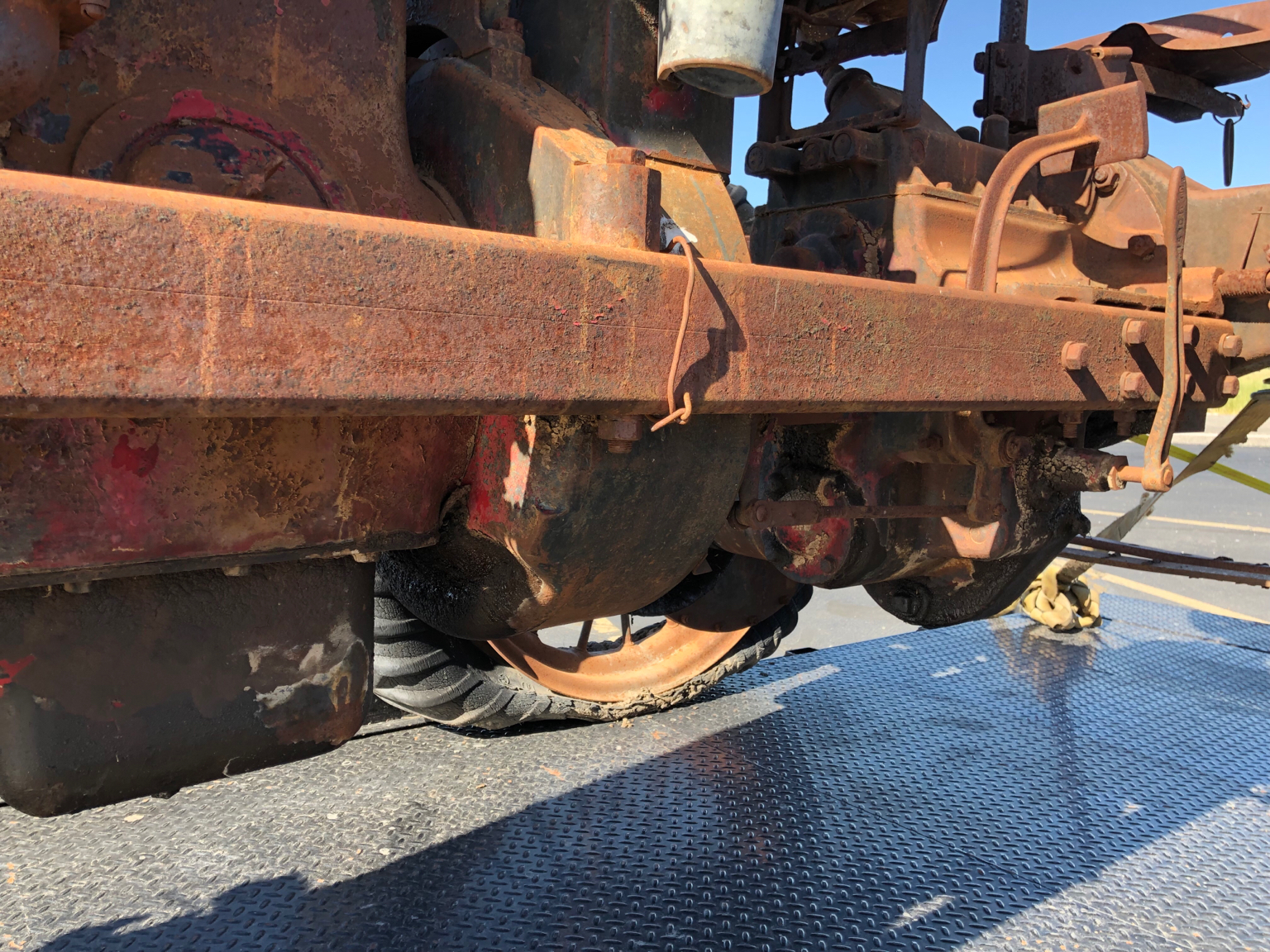

My current problem is that I need to get it off my trailer (tilt deck), and the right brake is locked up. When I tap the cover with a hammer, I get a dull thud. When I tap the left, it rings pretty good. I’d like to get the brake freed up so I can roll it off the trailer vs. drag it off.
I have removed the two bolts, squirted PB blaster under the lip at the top, and used a couple of eye bolts and nuts to try and pull the cover, but I’m not having any luck getting it to move. I’m at the verge of stripping the threads. I added more PB, and tapped all over trying to break the rust loose.
Short of destroying the cover, is there something else I need to try to get these off?

That looks more like an F-20, rather than an an F-12. Not an F-14 either. They are basically an F-12, running higher RPM's to get 14 hp. It's not a Regular, as they had open steering gears. Doesn't look large enough for an F-30.
As far as the brakes, you may try more PB, and try rocking the brake lever back and forth, and see if you can get it to move. release that side. If it's similar to an F-12, which I have the brake mechanism is fairly simple, more like a cam action to spread the shoes. More than likely, the drums have rust in them, possibly the linings have swelled, or came loose. It may also help to turn the wheel backwards, then forwards, may help break it loose. If memory serves me right, those brakes, much like the next generation of band brakes worked better going forwards, than back. So pulling backwards may help force the shoes inward.

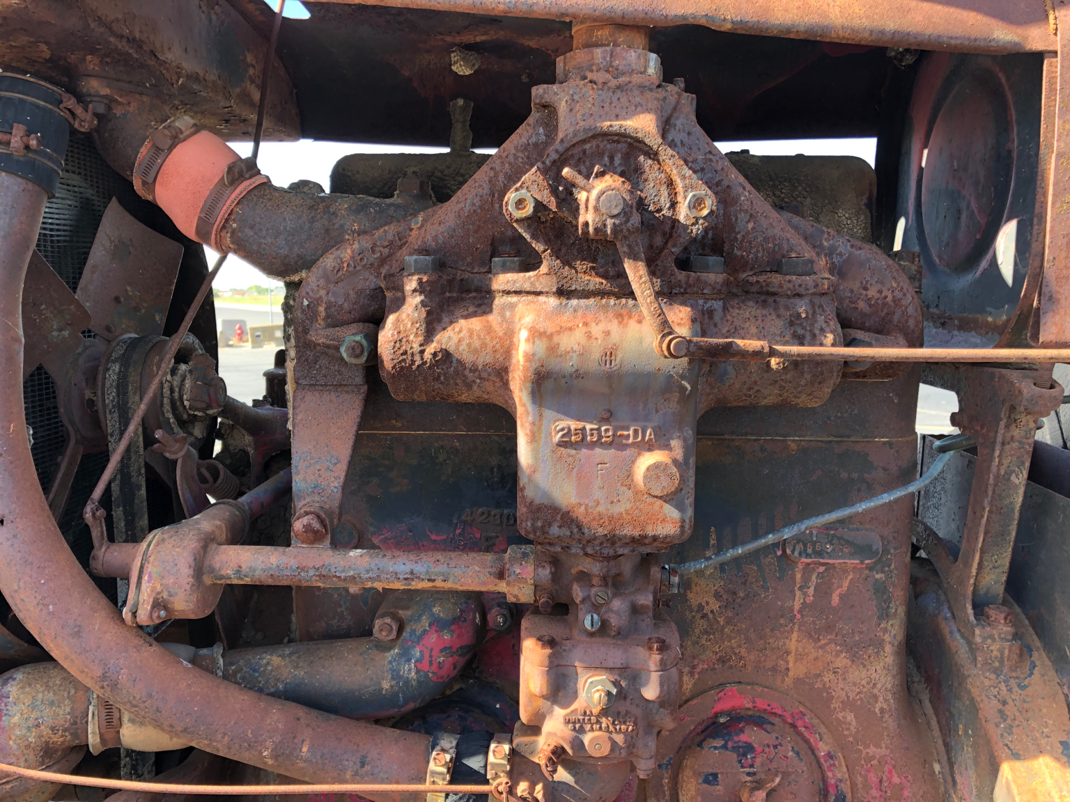

I think you are right on it being an F-20. The seller said it was an F-12. I have been reading the manual for the F series tractors and couldn’t figure out why it says an F-12 should have a down draft carburetor,when this one clearly has an updraft.
   / Picked up an F-12
The ID tag is missing, but the serial number on the frame and engine match, and make it a mid-1936 model F-20.
With my neighbors help today, we were able,to get the brakes freed up. The left is in good shape, but the right had filled about half full of rust and was locked up tight. Ended up getting about half a quart of rust dust out, but the brake drum did come off and the shaft is in good shape, but the drum and shoes on that side will need to be replaced since they were so badly eaten up. Good news is it rolls free, so I tilted the deck of the trailer and it rolled off. Probably the first time the wheels have turned in 20+ years.

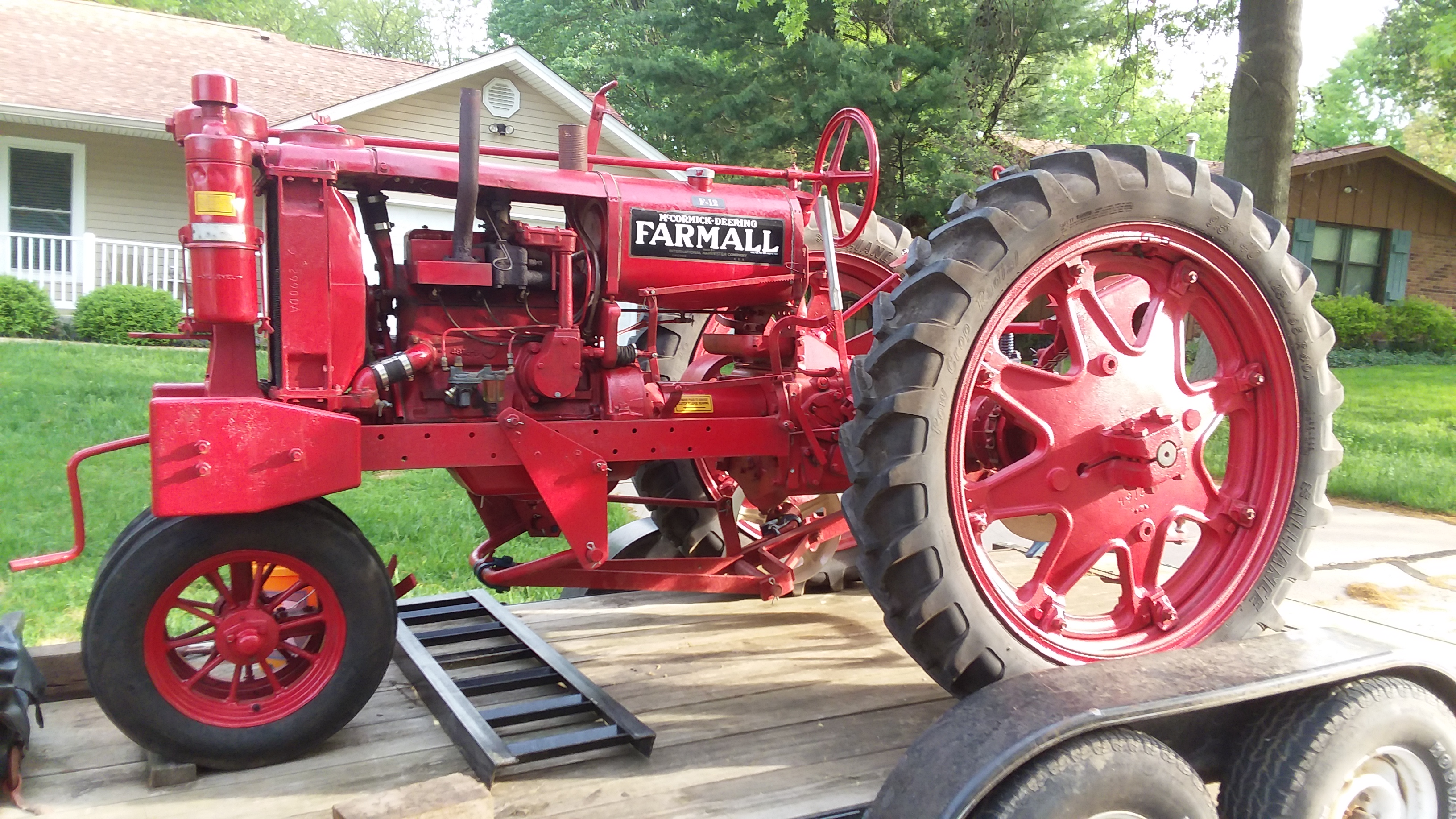

We had several of these on the farm, way back in the day. Is this a hand brake model? I think most of the early ones were and it looks like it has the hardware for the steering connected turning brakes, although the cables are gone. This was really convenient for field work but could be dangerous under some conditions.
