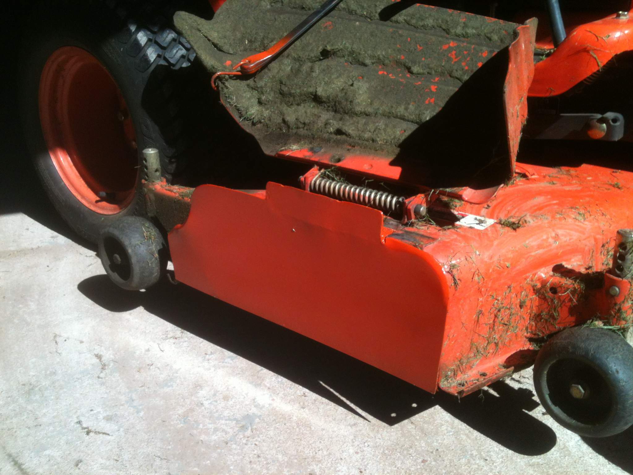

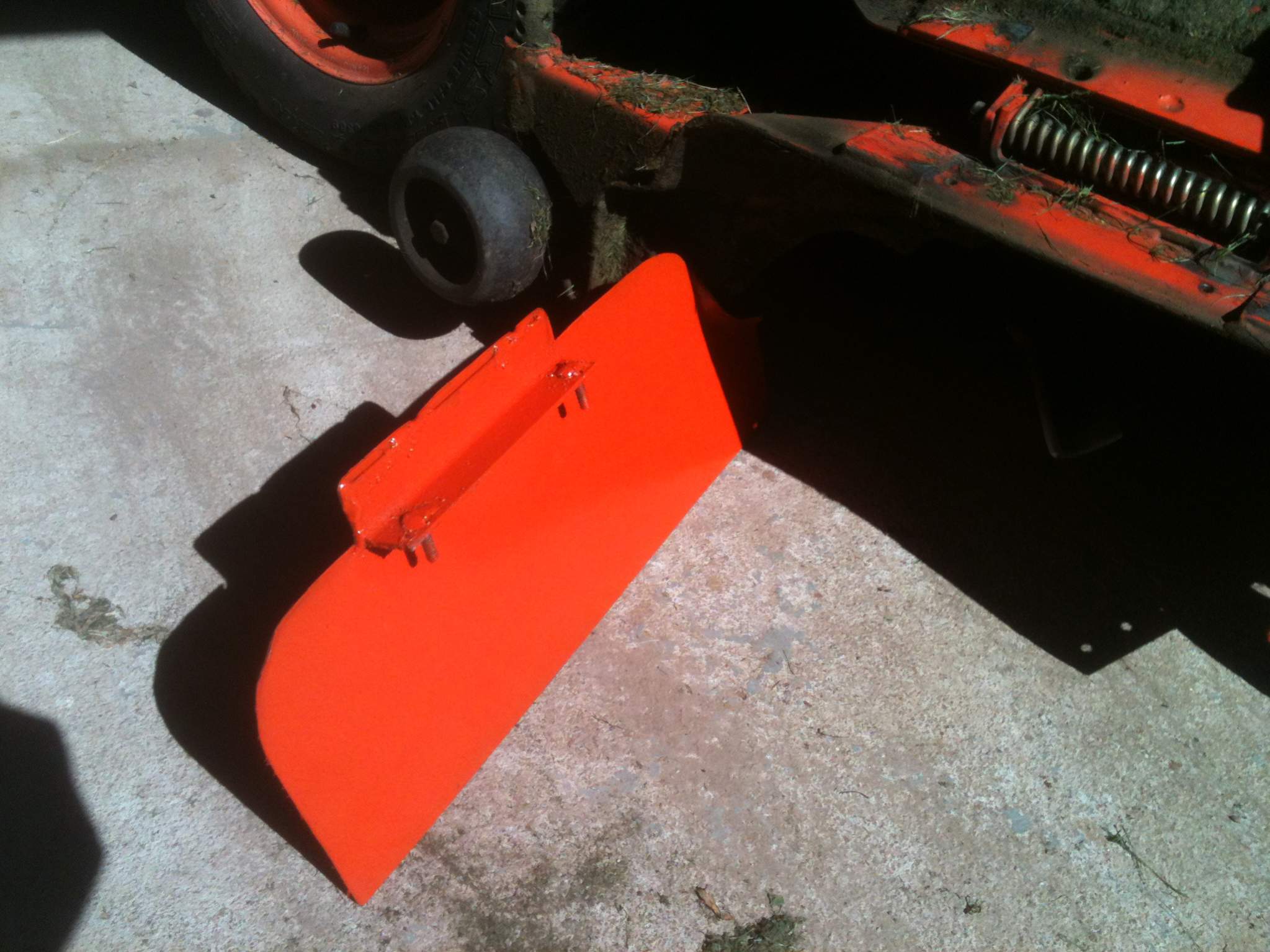

007.jpg009.jpgI converted my BX into a mulcher by making a plate that covers the opening of the mower deck. Only cost a few bucks to make and it works really well.
