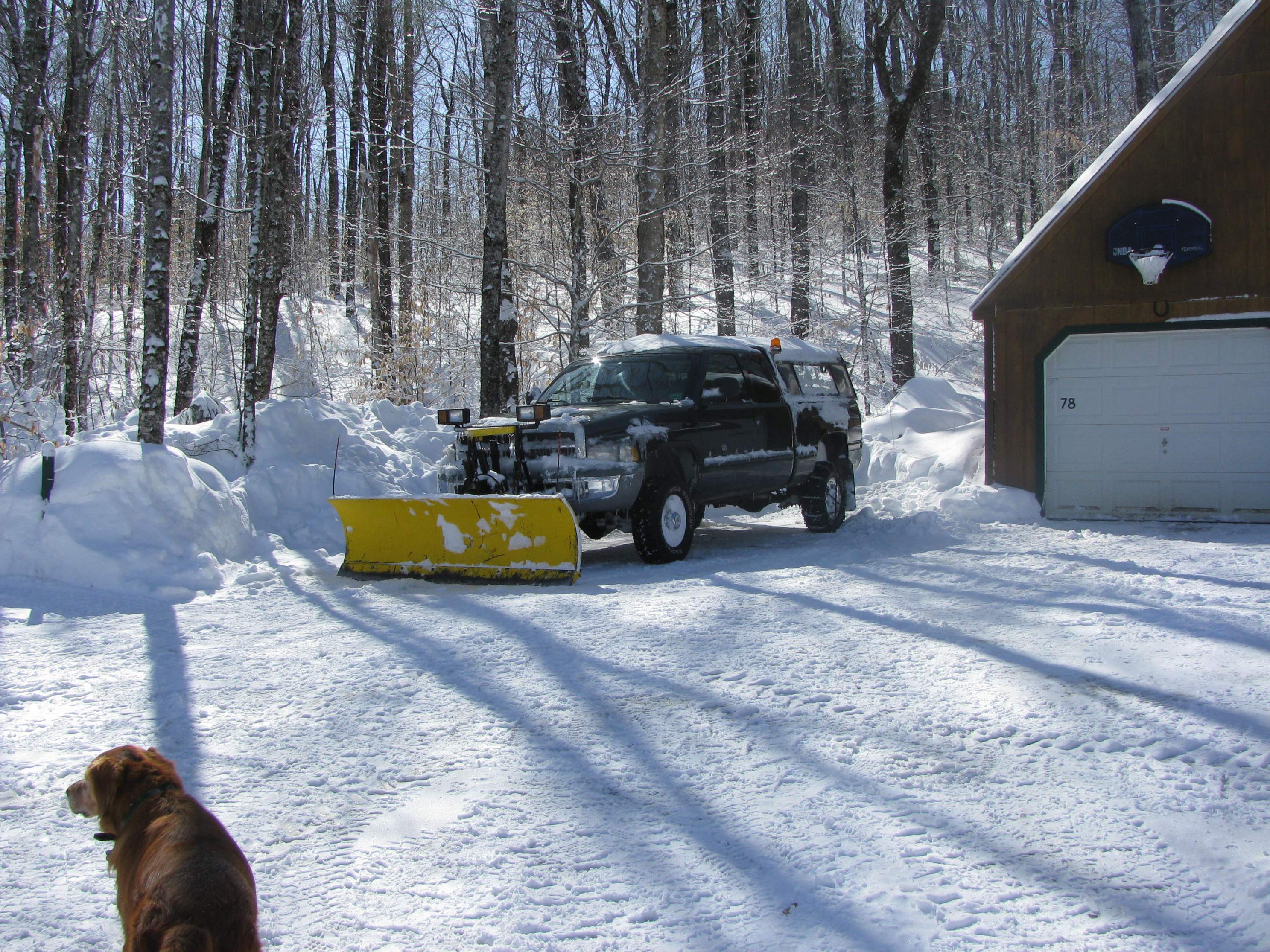

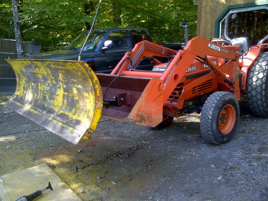

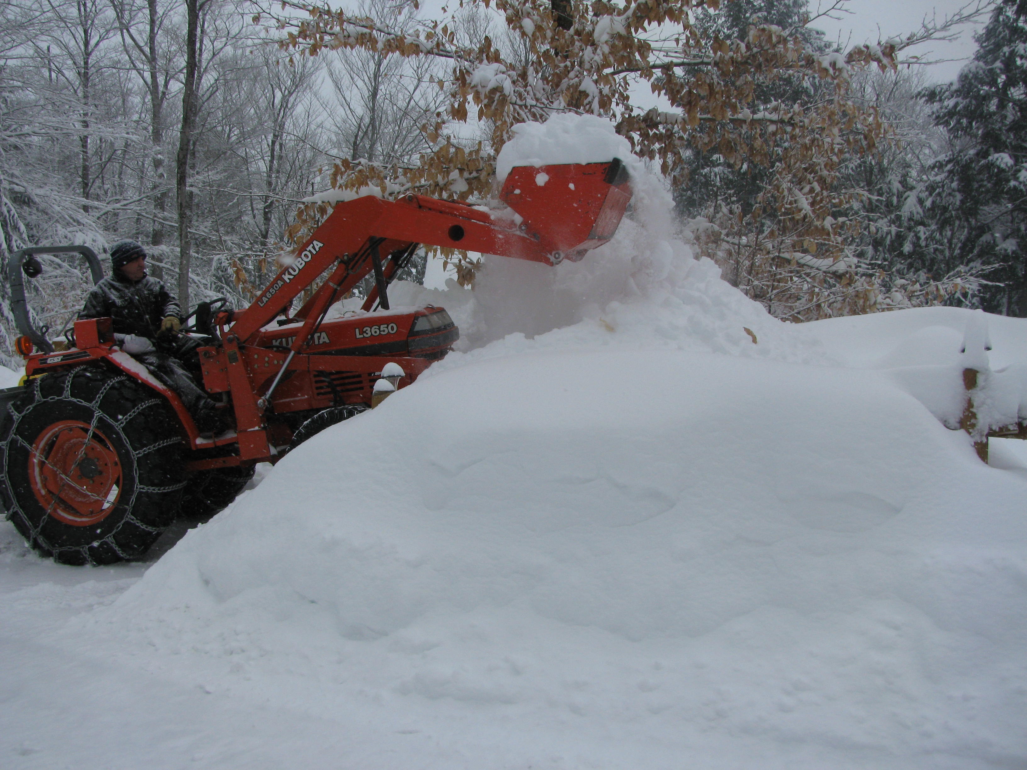

IMG-20140924-00206.jpgGetting ready for winter. my new add on a 7.5 ft. Fisher plow, already for yellow paint. I finished painting the bucket, the frame and plow mounts, primed the plow. Now working on new hoses to go to the rear remotes as well as a cross over cushion valve. drained the cylinders yesterday and filled with UDT 2. also pictured is my 1 ton dodge with 8 ft plow. I am in the process of welding a 3 point hitch on the plow frame so it will be able to go front or back on the tractor with power angle. when on the front I have a 1/2 ton counter weight made in a 55 gallon can.IMG-20140924-00202.jpgIMG-20140924-00204.jpgIMG-20140924-00202.jpgsnow 006.jpgsnow 006.jpgIMG_7565.JPG
Did you put a plate behind the angle brackets that attach the blade arms to the bucket? If not I'd worry about it deforming the bucket.
there is a very large piece of steel on the back side of the bucket (part of it) and the plates are bolted in right where the loader arms attach.
