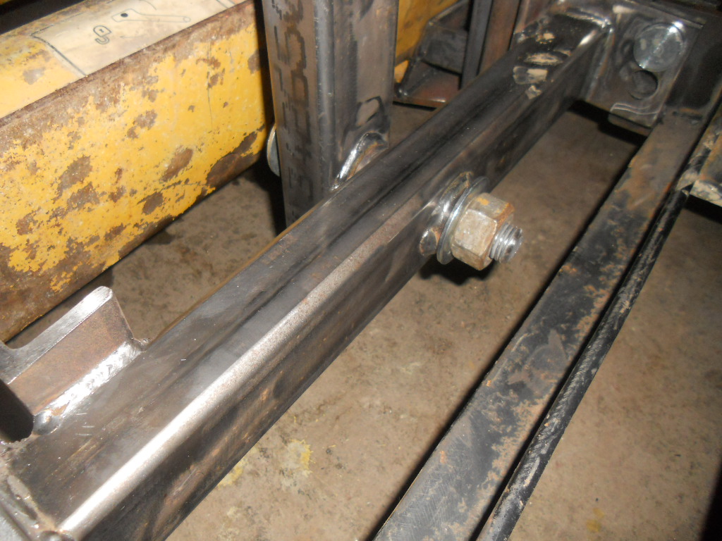

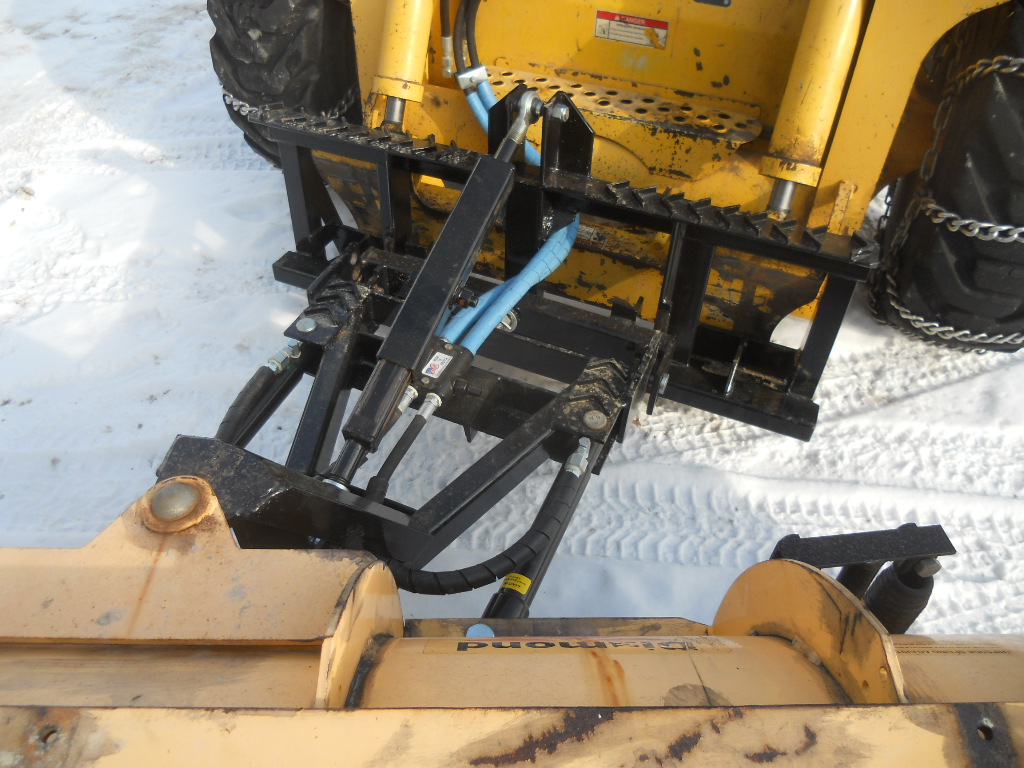

What is the provision for lateral yaw float?
There is none. I thought hard about adding that in to the mount, but my last "V" didn't have that and I really "horse" my plows later on in the season pushing the banks back that can get very hard & icy. Now if I had a machine shop tools I'd be tempted to put a very heavy center pin for a few degrees of lateral rotation. Now I'm limited to some heavy wall DOM tubing and a 1" or there about bolt. I did that on a straight blade I built a few years ago and it performs well, just not sure if it would be the same on a "V" blade.
Here's a few pics of that one, look for the nut/bolt in the center.

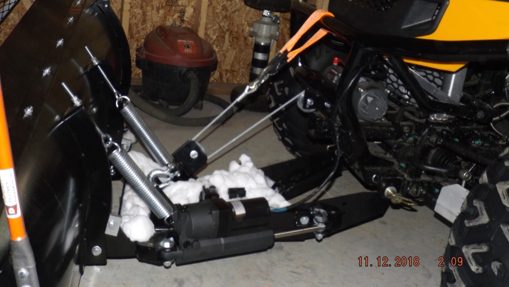

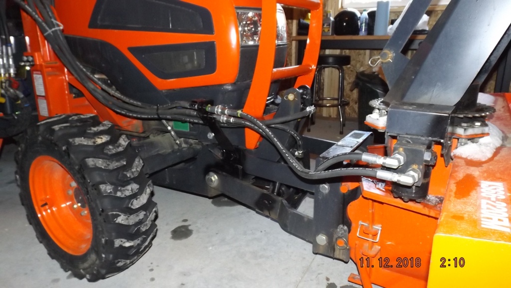

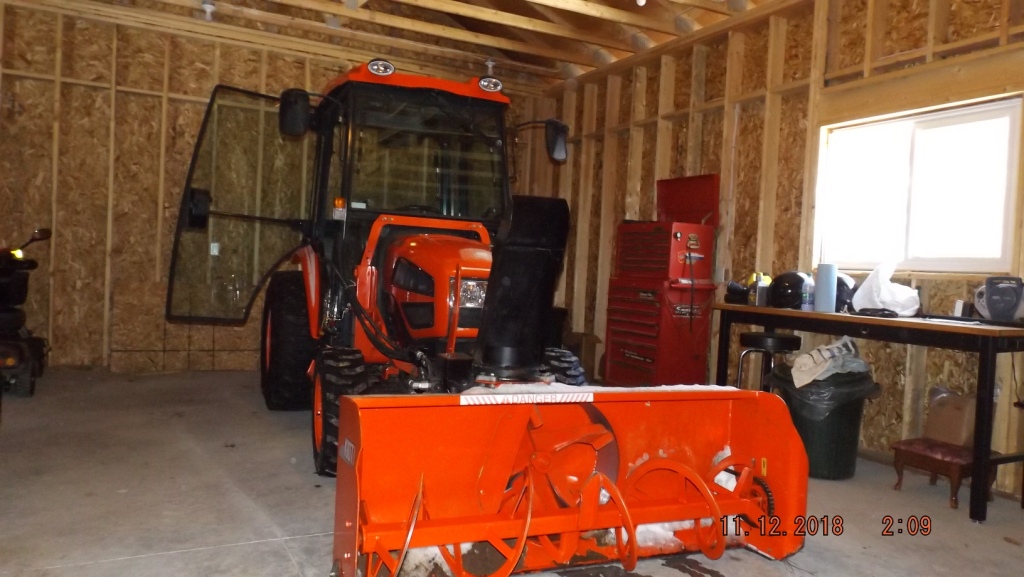

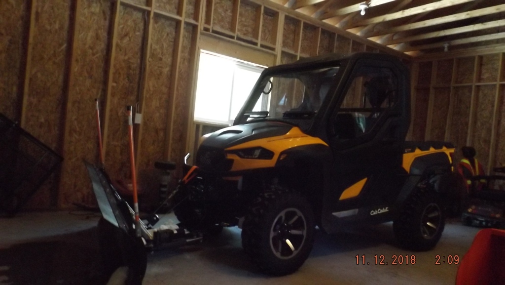

Here they are
2018 Cub Cadet Challenger 750 side X side with 72" Denali snow plow with Hydro turn ( angler)
2014 Kioti 30 HST with 66" Front Mount Snowblower with hydraulic shute and heated cab.
