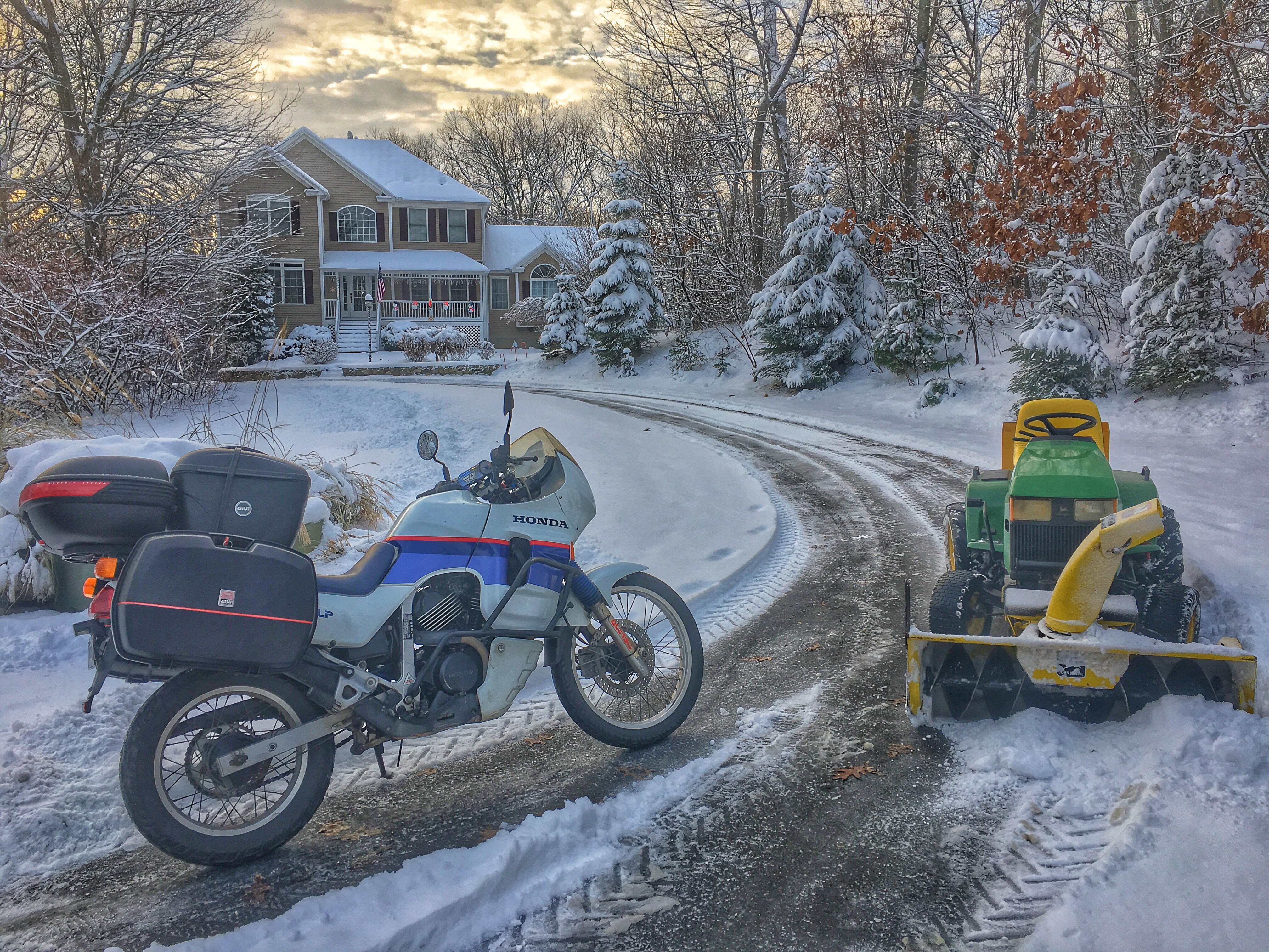

I’m celebrating my 11th season with my 1993 JD425! Can I Live?

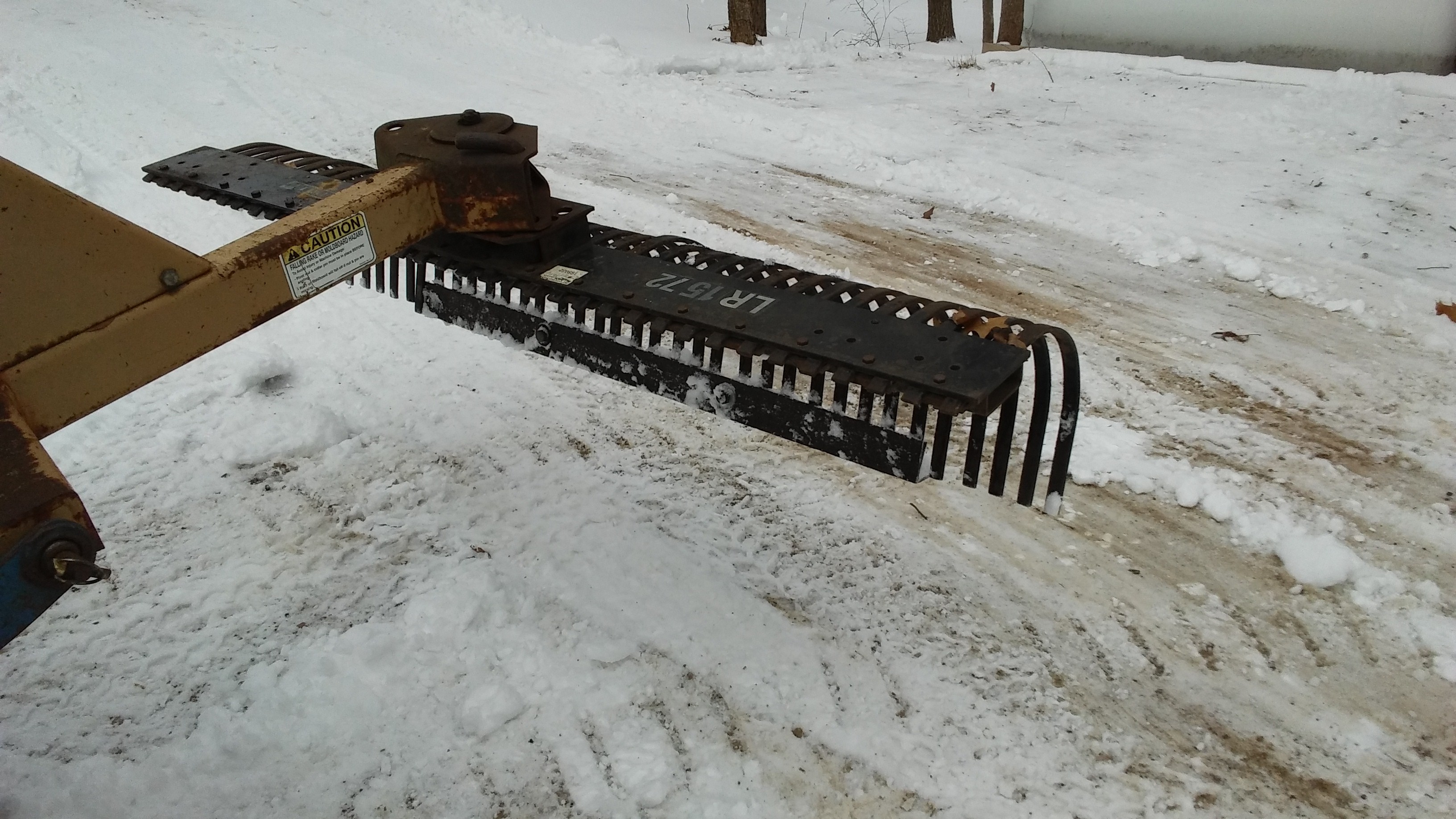

Not good pictures.
Not being sure the idea would work, I used what I had available.
A section of bed frame.
Bolted to the cutting edge of a 5' ATV plow I have on my tractor.
After seeing how GOOD this worked, I tried attaching some 3" to my york rake and it also works GREAT.
Yes, your drive sounds like it would benefit from the angle iron.
This does NOT scrape down to bare earth, it slides over the ground without digging in.
Later in the season when the ground freezes, you can take it off to get a better job if you want.
