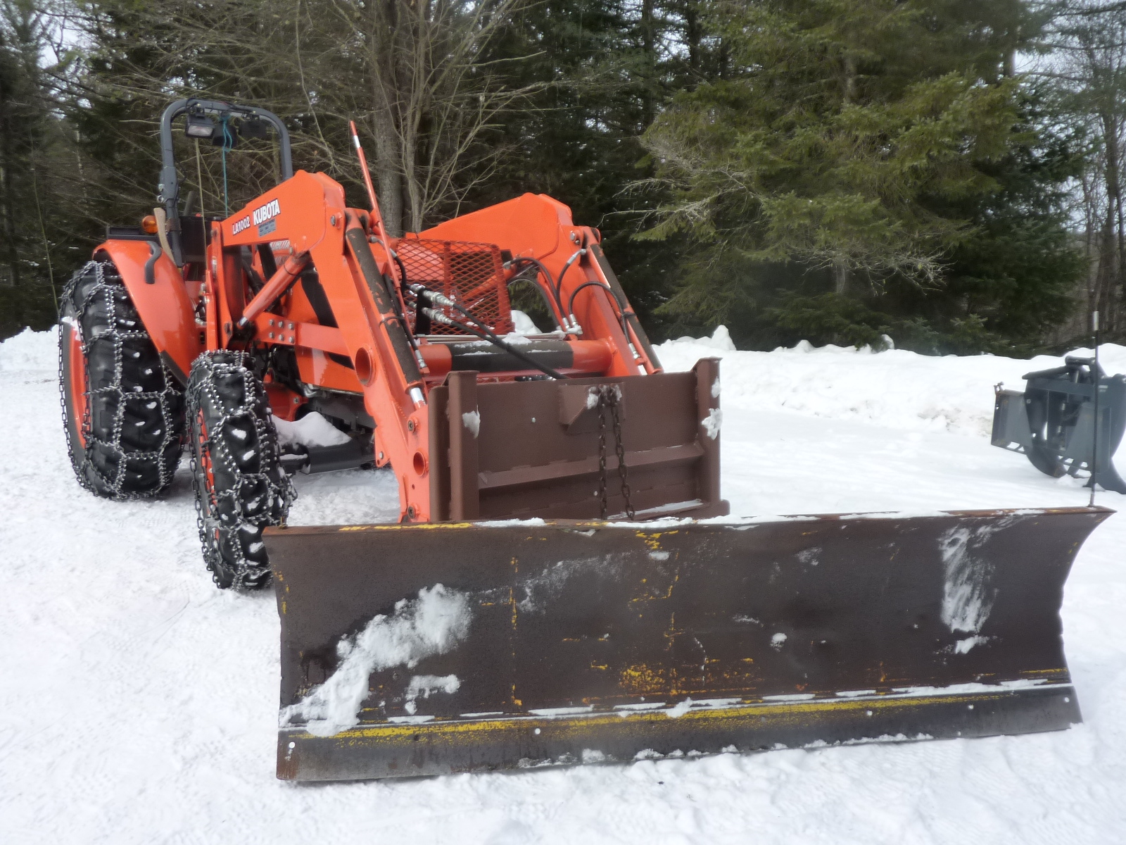

Not good pictures.
Not being sure the idea would work, I used what I had available.
A section of bed frame.
Bolted to the cutting edge of a 5' ATV plow I have on my tractor.

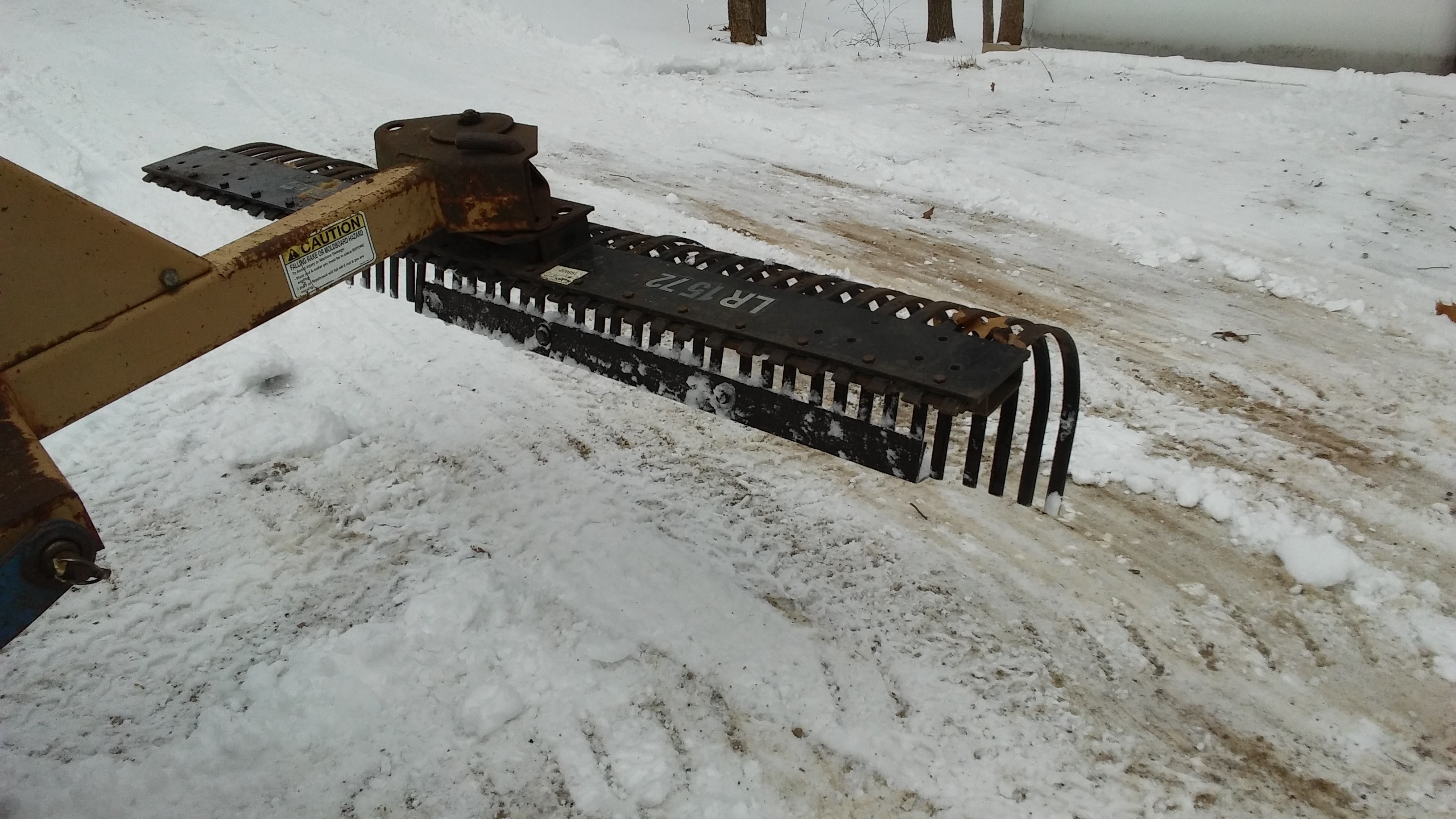

After seeing how GOOD this worked, I tried attaching some 3" to my york rake and it also works GREAT.
Yes, your drive sounds like it would benefit from the angle iron.
This does NOT scrape down to bare earth, it slides over the ground without digging in.
Later in the season when the ground freezes, you can take it off to get a better job if you want.
Thanks for the pics and the feedback. Looks like a great idea and easy to implement.

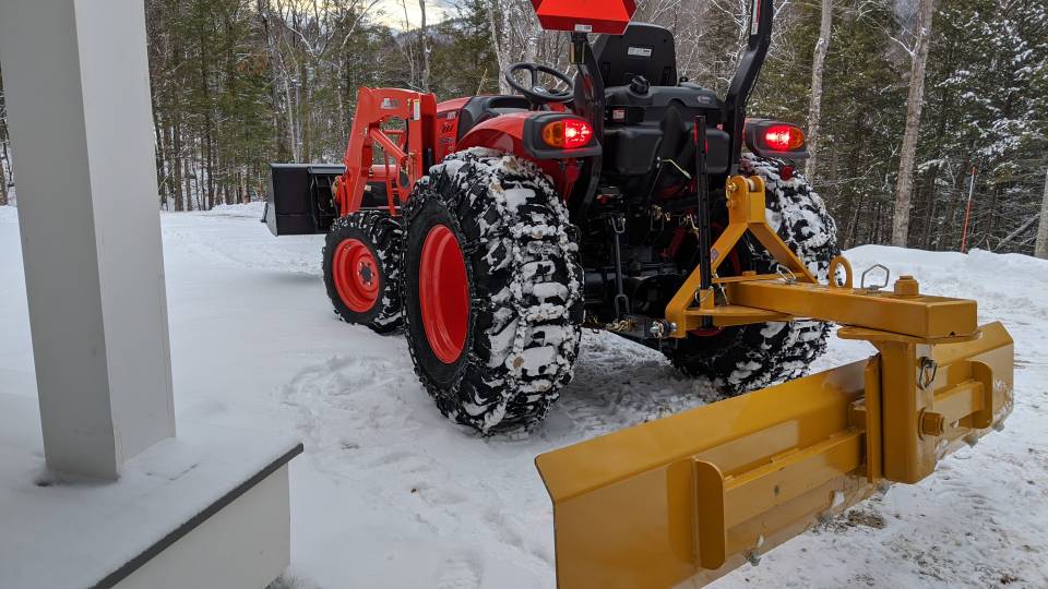

In front of my CK2610HST is a 450' driveway going downhill at 19%. Behind it is a 7' wide Everything Attachments 6-way Scrape blade. Those are OFA-8 chains on the loaded rear tires. View attachment 631113
Nice Chains... You dont bounce much and you get better forward motion without slipping sideways.
   / Pictures of your snow weapons #5,196
So true. Between my rough driveway and the fact that tractor is don't have a Mercedes like suspension, I barely notice a difference when the chains are on. And although my driveway goes downhill, it's also on an embankment, which means a sideways flip would surely result in a roll. I love these OFA-8 chains.
