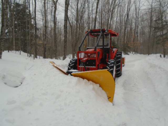

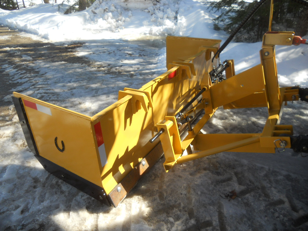

I don't remember if I posted this before, I built it 3 years ago. It'll pull or push, most of the time I have it pushing. Where I need to back up against garage doors I'll turn it to pull so I can get close.
I can move snow with the front or back and hardly move an inch without one end or the other moving snow.
Do I see three sets of attachment points for the back blade that you can offset to either side? And I think I see 2 sets of attacment point that you use for the push or pull option. Correct? Jon

The Tach-all carrier is supposed to lock in via a lower pin. I don't see an attachment point on you Box. Do you just grab under the upper hooks and let the box pivot on that?
Not able to off set it, and yes the "hooks" on the box mirror each other.
There's 3 of those hooks, then a vertical pair of 1" pins that drive down into a heavy wall pipe, otherwise it can swing by those hooks. I have a hydraulic top link that aids in the hooking/un hooking.
   / Pictures of your snow weapons #5,700
Tatch all carrier? Did I inadvertently copy something that exists?:laughing:
I'll post a picture of the linkage when I'm back on the computer.
