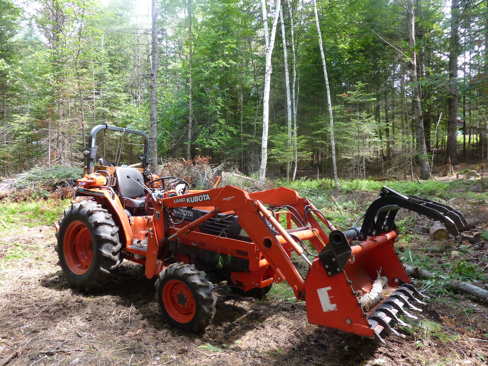

I did a search on here, but could not find anything about having a pin on grapple. I don't have the skid steer type QA bucket, mine is a pin on. Does anyone make a standard pin on type of grapple where I would remove the bucket and then attach the grapple hardware to the FEL arms and use the bucket hydraulics to work the grapple? Sorry if this is already made but I couldn't find it on the EA website. I have a new L 2501 Kubota with 4x4 DT and FEL. Just wondering right now. Thanks for any help. I would like to get something like this in the spring.

I bet WR Long can build you a pin on grapple. They built me pin on pallet forks for for my Kubota. I had to order through a dealer though. I don't think they sell direct to consumers.
   / Pin on Grapple? #3
I got my WR Long 48" pin on from Everything Attachments. They had the hydraulic valve kit and free shipping. They even offer a discount if you buy the grapple and the valve kit together. I have the Kubota B1658 Quick Attach pin kit which makes swapping to the FEL a lot quicker.

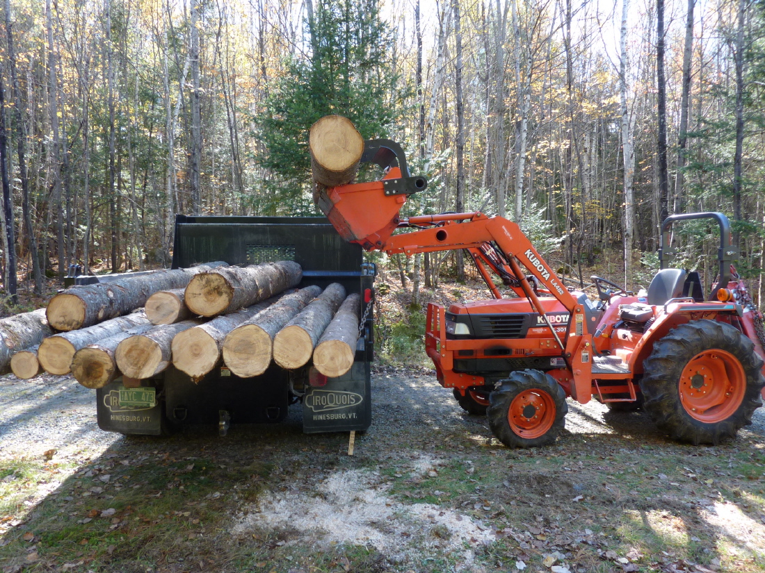

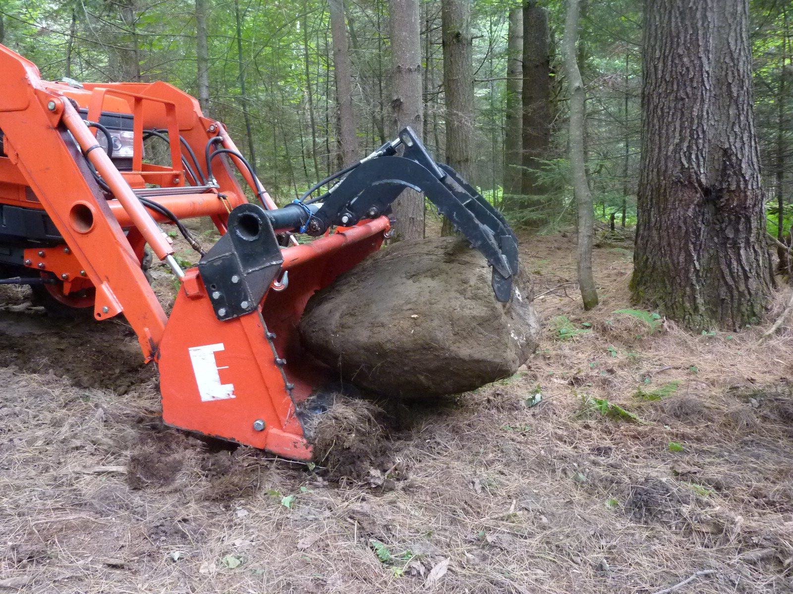

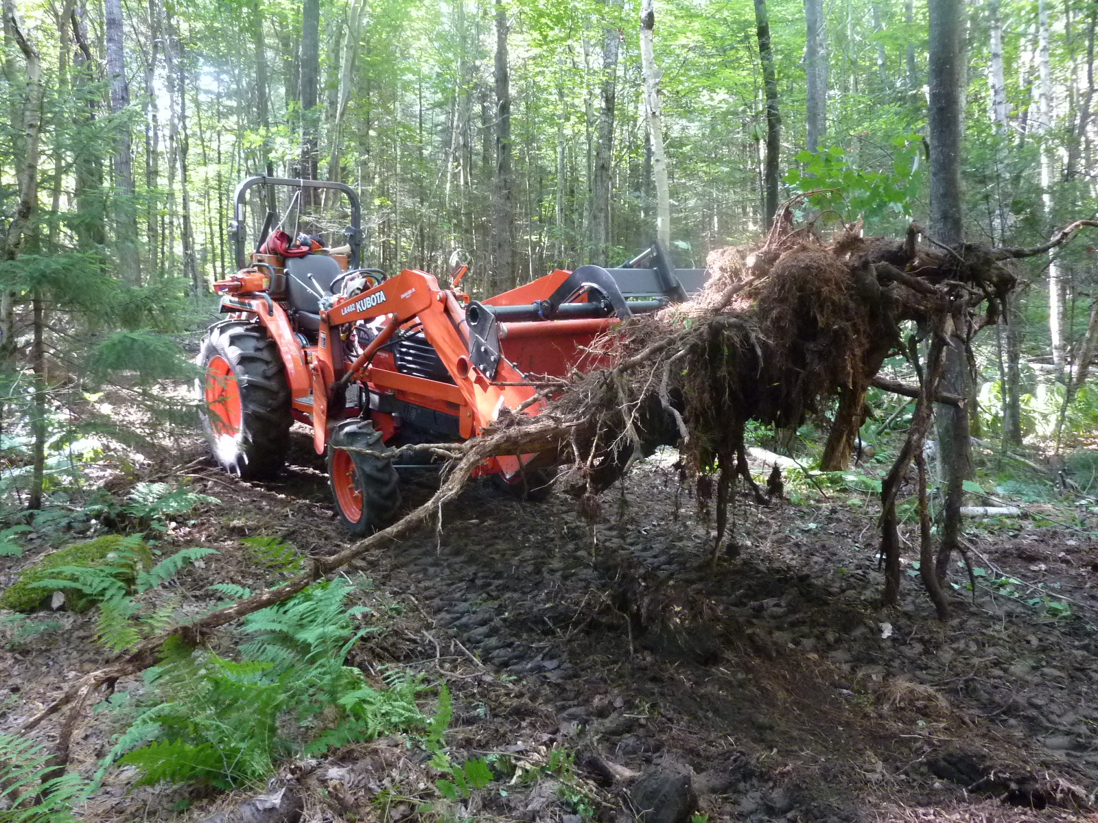

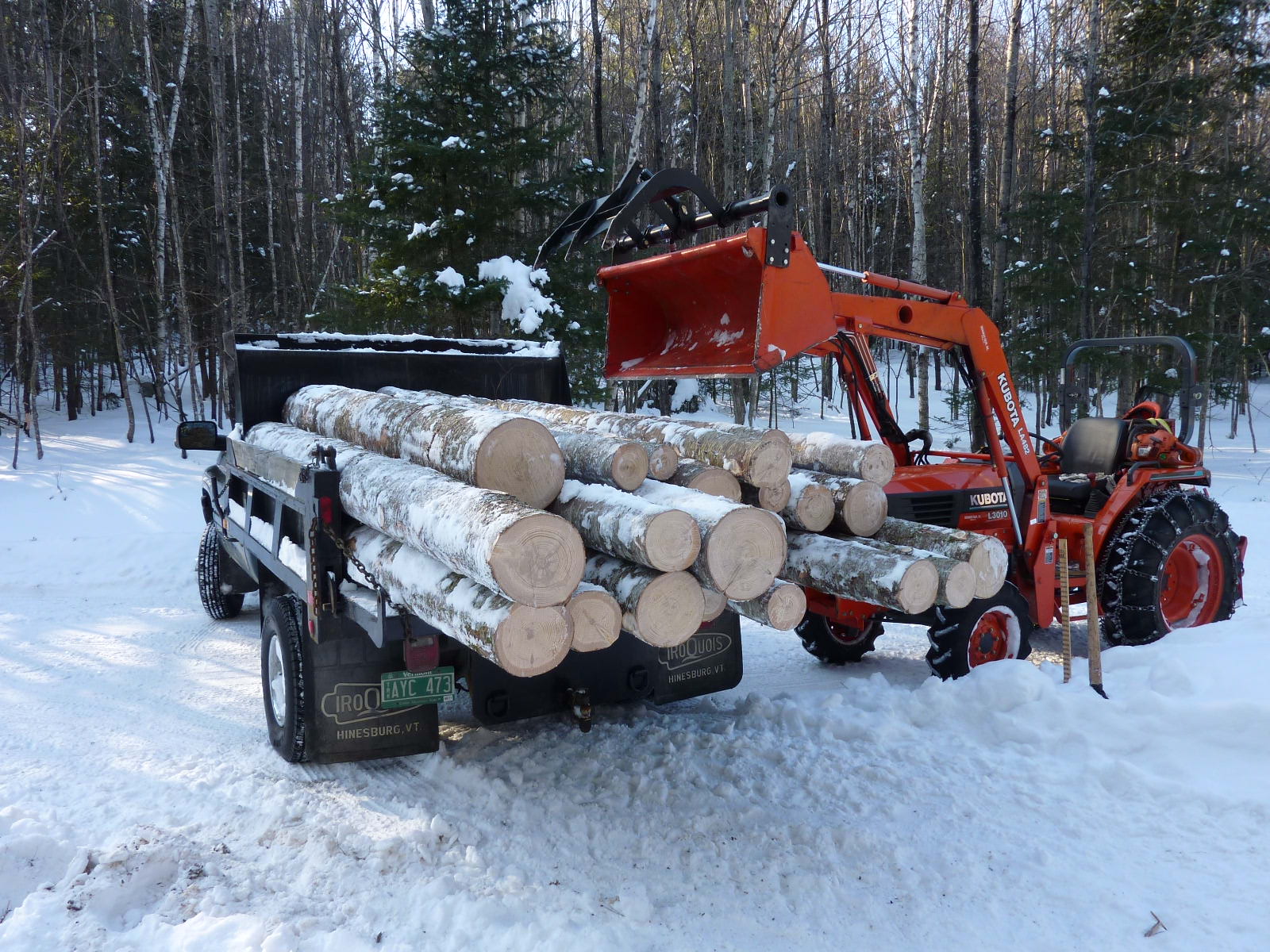

Have you thought of going this route?? There isn't much I can't do with this set-up.
gg
