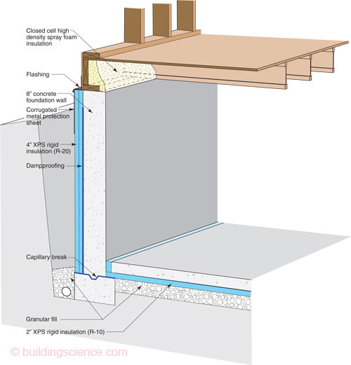

You should run rigid foam insulation up the outside of the block from the footing to the base of the wooden wall and cover the top of it with flashing between the block and wood, like this...
http://insulation.owenscorning.com/...s-crawlspaces/foam-insulation-exterior-walls/

Moss that looks good but if possible I'd rather the exterior of the block be exposed up at least 8", in the summer it's easy to trim against with a string trimmer or lay mulch up to and in winter snow and melting snow lays against it.
   / Planning To Build a Shop/Garage, Insulation Question #9
Mossroads graphic is awesome for a building with a cellar, but not for a building with a poured floor with block or poured walls. You're on the right track but you want the floor to rest on compacted soil up to the wall, or even better, on a shelf. I wouldn't have insulation board between the floor and wall, if that's what you're thinking.
You can solid insulate the exterior of the foundation walls up to grade, insulate under the floor, then insulate the interior of the walls over grade. I don't see any reason you can't insulate the interior with solid from the wall to the floor except you'll have to build out the walls or have a shelf. You're electrician might not like it much.
