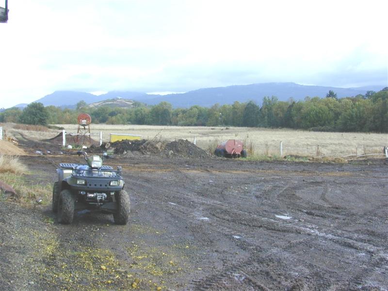

Can I ask what you would expect to pay for a 60X500 barn pad and how you think they would do it? I included a photo of the field that will become barns.

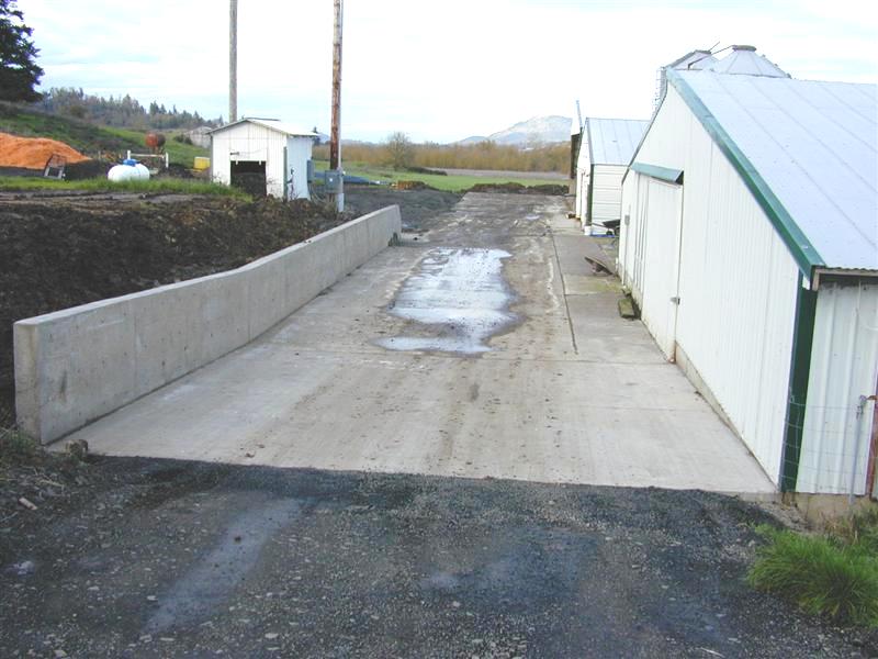

This is another picture looking down our road in front of the existing barns. The front of the new barns will face the camera in this photo. I did the excavation, gravel placement, and concrete for this road. Actually I had a crew help with the flatwork. My wife and I built the forms and poured the retaining wall ourselves. She was unusually nervous when we poured that wall. It was the first of four walls so she got more comfortable later.

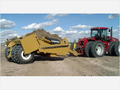

These pull behind scrapers usually are an open bowl type without the paddle. I found a picture of what they used.
Eric
