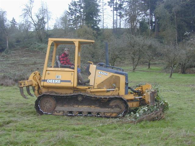

You all love pictures so I included one of me clearing out blackberry bushes with my dozer that I got for this project.
Eric
