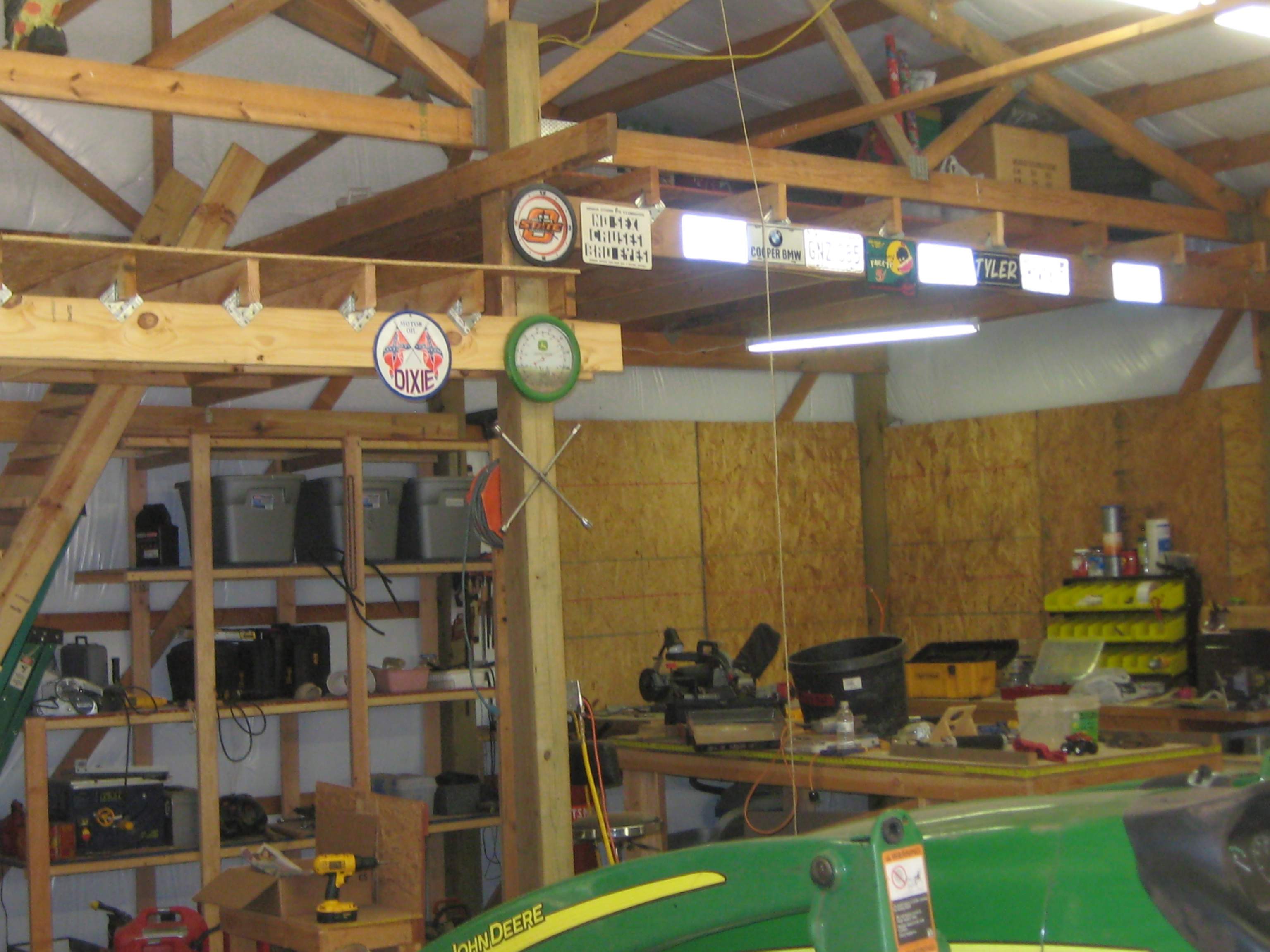

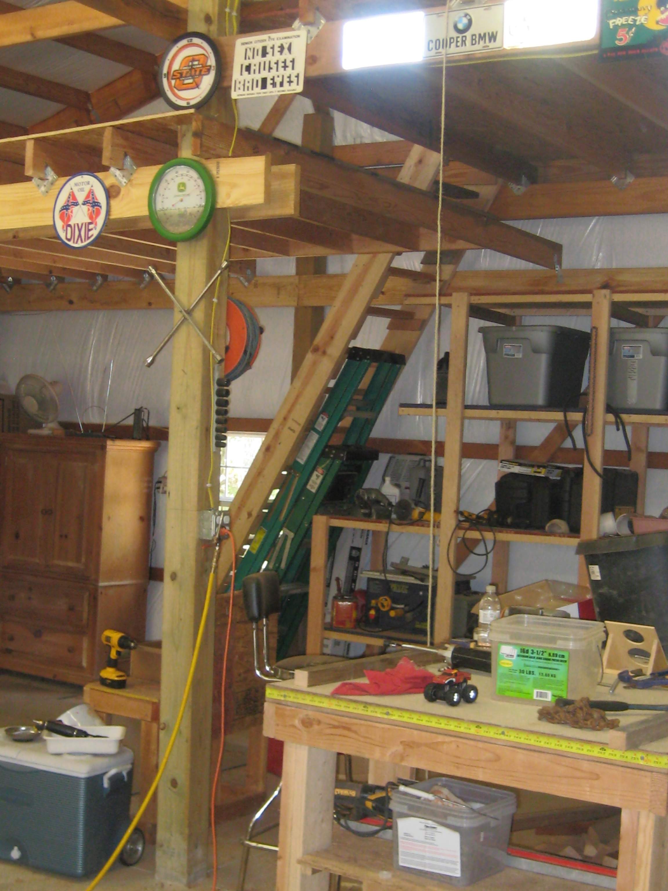

I sunk a post in the floor before I poured my concrete and then attached it to the truss overhead for my loft. I used a 2x8 nailed to my back wall and then hung joist hanger on it and set my 2x6 joists on top and then laid my flooring on top of that. Here is one pic showing the post and placement just after I finished my project and before I even got my joists up. I've since put in a second loft on the other side and built some stairs to make it easier to access. I will work on getting a few more pics for you.

Here are a few more pics
