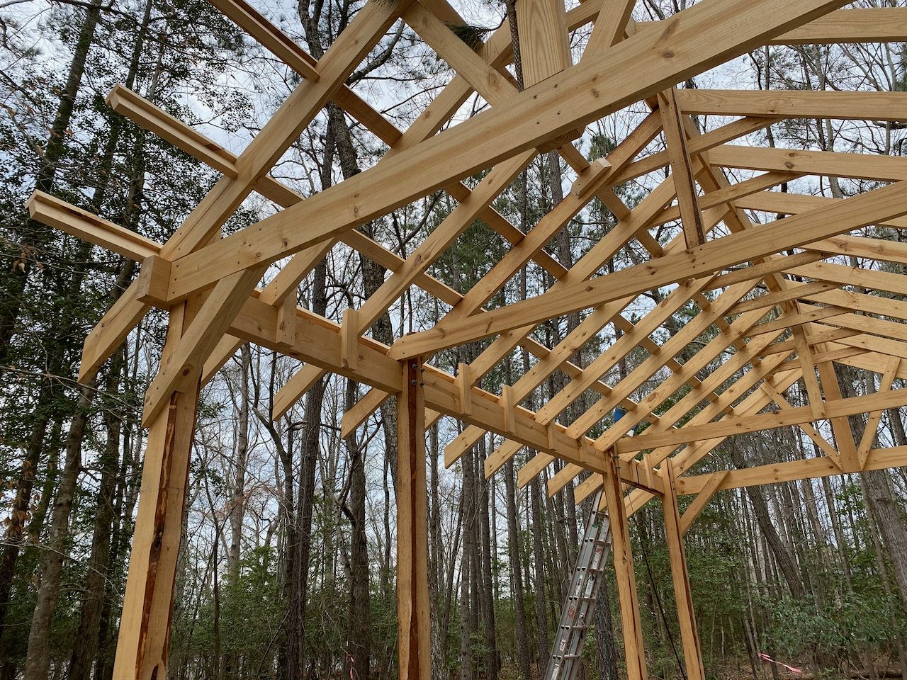

I always use 1/2" through bolts for header to post connections (and notch the posts). Some of the new timber screws are structural rated and should be fine. Just read the fine print to make sure they are structural screws and not simply for landscape timber work.
I have been using GRK structural screws in various places and really like them. Both Amazon and Home Depot have decent prices on them (cheaper to buy in bulk).
In the photo below, I used 1/2" bolts for header/post joints, but everything else is a GRK structural screw, ranging from #10 to 1/4" to 5/16" sizes.

GRK and FastenMaster (TimberLok/LedgerLok) seem to be good.
Points to GRK for using standard Torx bits.
Lowes also carried some other brand that looked like GRK, but the metal resembled cheese when you went to drive it in (Spax?).
Air/Pasalode nailers are faster, but dont get the strength that a bolt or lag does.
Structural lags are way faster and (from our destructive testing at work ;)) a pair of structural lags through the end of a 2x into a 4x4 or larger post will hold as well as a thru bolted connection (ie: the end of the board fails before the screws rip out).
