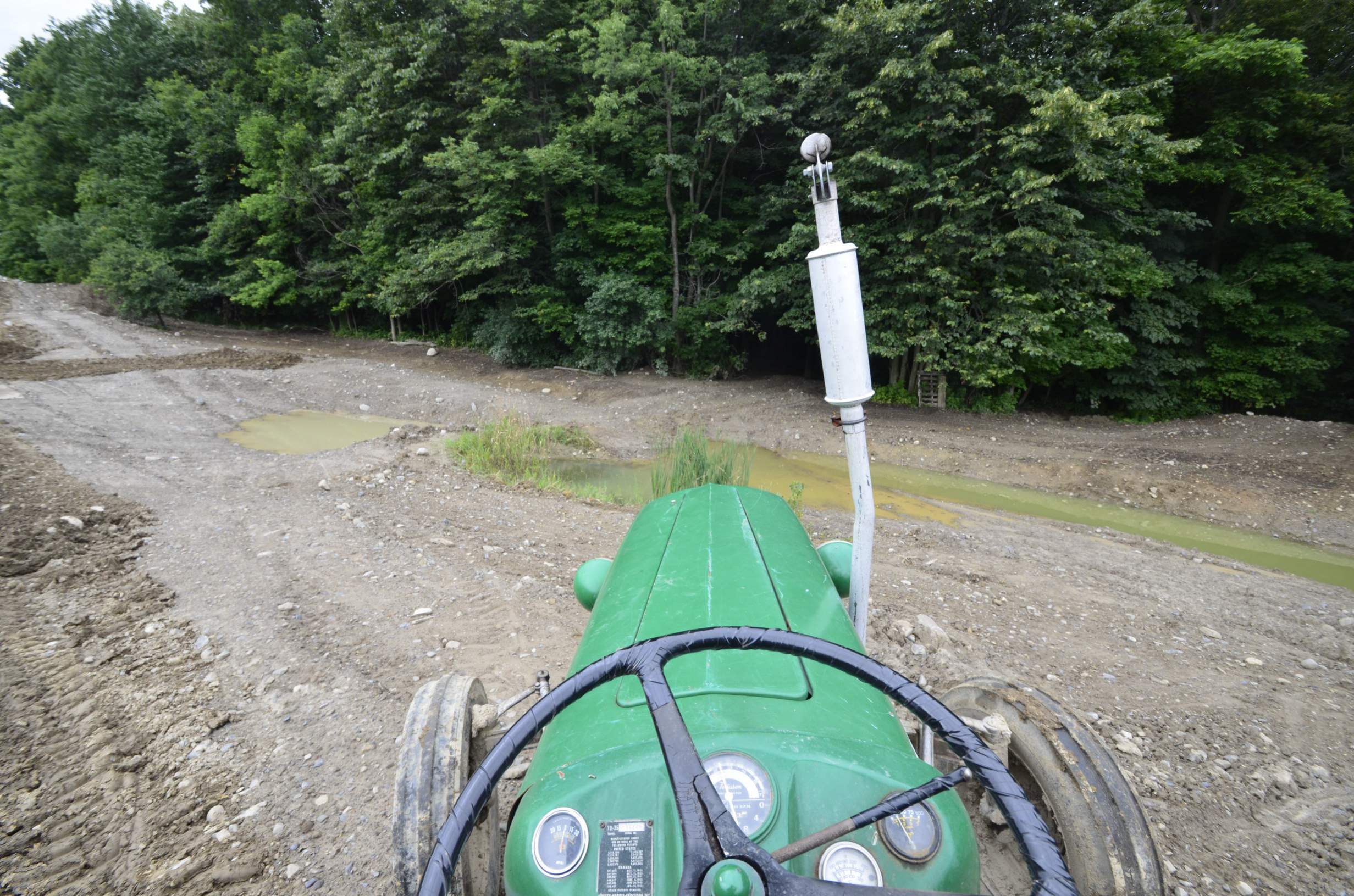

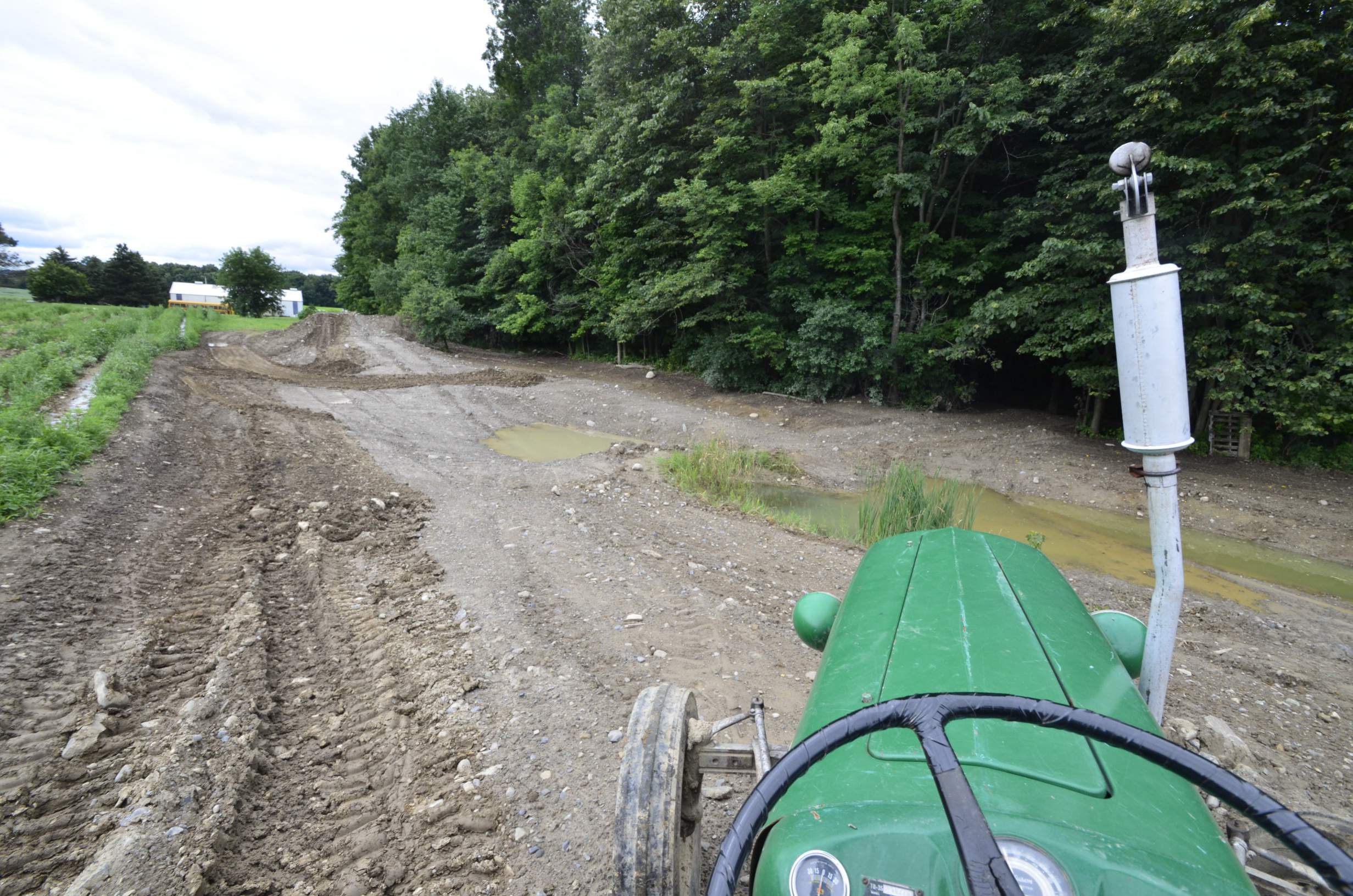

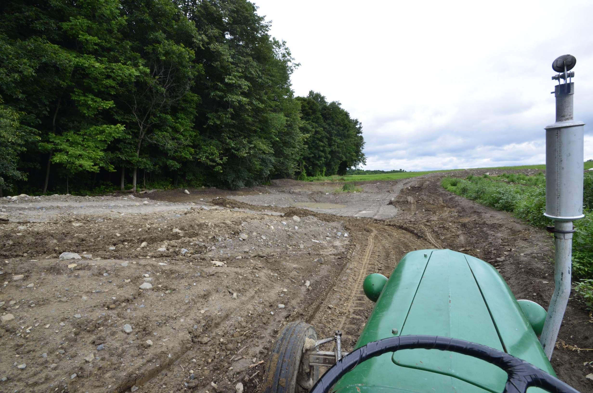

I am in the process of digging a farm pond with a box blade, back blade and scoop.
I am really impressed with my new 1959 Ferguson TO35 it has 14" loaded tires and runs pulling circles around my Tiashen TS354c 4wd
I clearly did not have a clue how long it would take to excavate a 50'x 250' x 8-12' deep hole.
But this tractor is up to the task and I am having fun...
Oh yeah and quickly learned why it had bright shiney new draw-bars when I bought it.
They are not intended to push a box blade backwards... After the third time of bending it I welded a 1.5x1.5 angle the full length.
Added an adjustable sway-bar because it is stronger... don't know how I lived without it before.

I figure Sept - October with 10-12 hours per week after work and weekends.

Looking at your tracks. It looks to me you should pull from the middle out wards instead of dragging dirt across the length. That way your hilling the sides and not having to pull the dirt as far. Good luck. It can and has been done with a box blade. Takes time though. BTW, stabilizer bars would help secure the box when backing up too. It's risky pushing dirt because if you hit a rock slab you could do severe damage not only to the empliment, but lift arms and upper hitch. -kid
