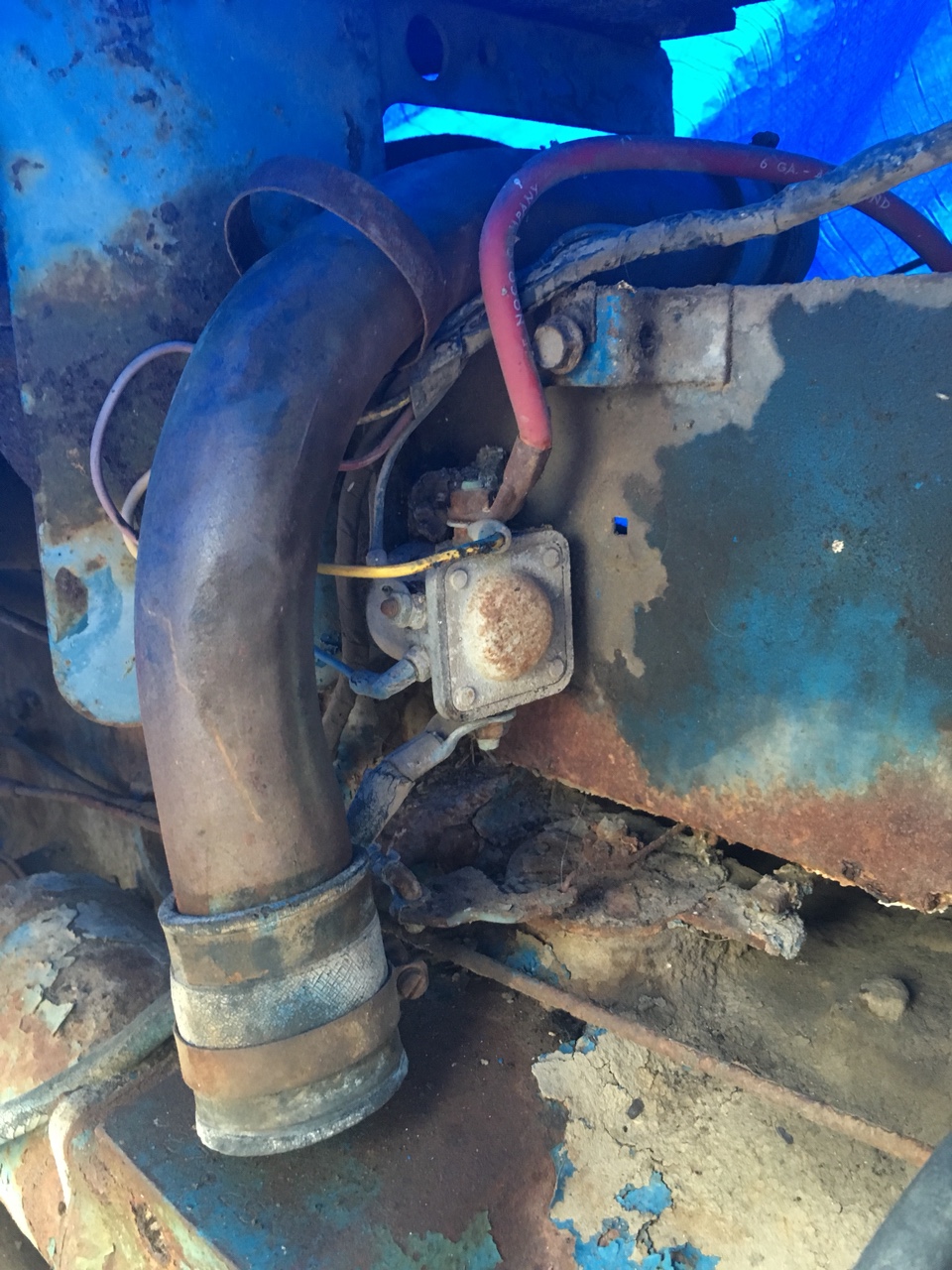

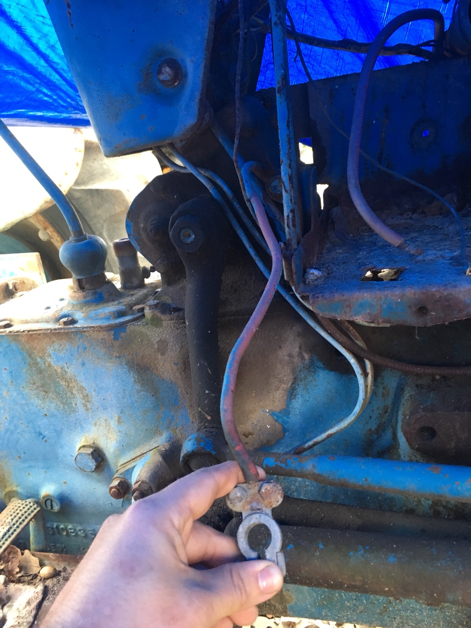

This Ford 4000 was converted to 12v at some point in time. The main issue is I don’t know how to tell whether it’s a positive or negative ground. Here’s a couple of photos I got this morning before the rain set in.
Any tips or ideas are appreciated.

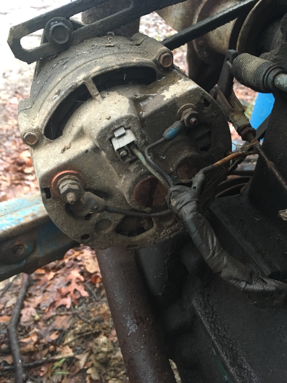

Good old 4 cylinder. Currently has a alternator on it. It’s wired, but that’s one of the issues that’s with the tractor. Or so I was told.
   / Positive or Negative Ground #4
All but certain to be negative ground. There’s few alternators in the world set up for 12V positive ground and no good reason to use one on that tractor.

If you have an alternator, presumeably you don't have a seperate voltage regulator so, one less thing to consider for voltage and/or polarity.

Here’s a picture of the alternator fellas. Not the greatest picture. Raining and bit cold today. IMG_1933.jpg
Name on the bottom is Delco Remy
