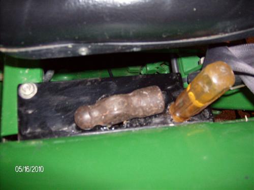

Right now I don't have a tool box on my JD 2305, and I wonder where I could put one. I carry a couple hand tools in the cylinder for the manual on the ROPS.
In addition, sometimes I want a spade, a rake or a mattock. How do you carry long-handled tools?
I'd like to see your solutions to this.

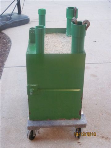

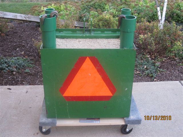

I can't find the photo's right now, but if you have the ballast box.......which you should..........stand up pieces if 4 inch drain pipe , in the corners, before you fill the box with concrete. Instant tool holder

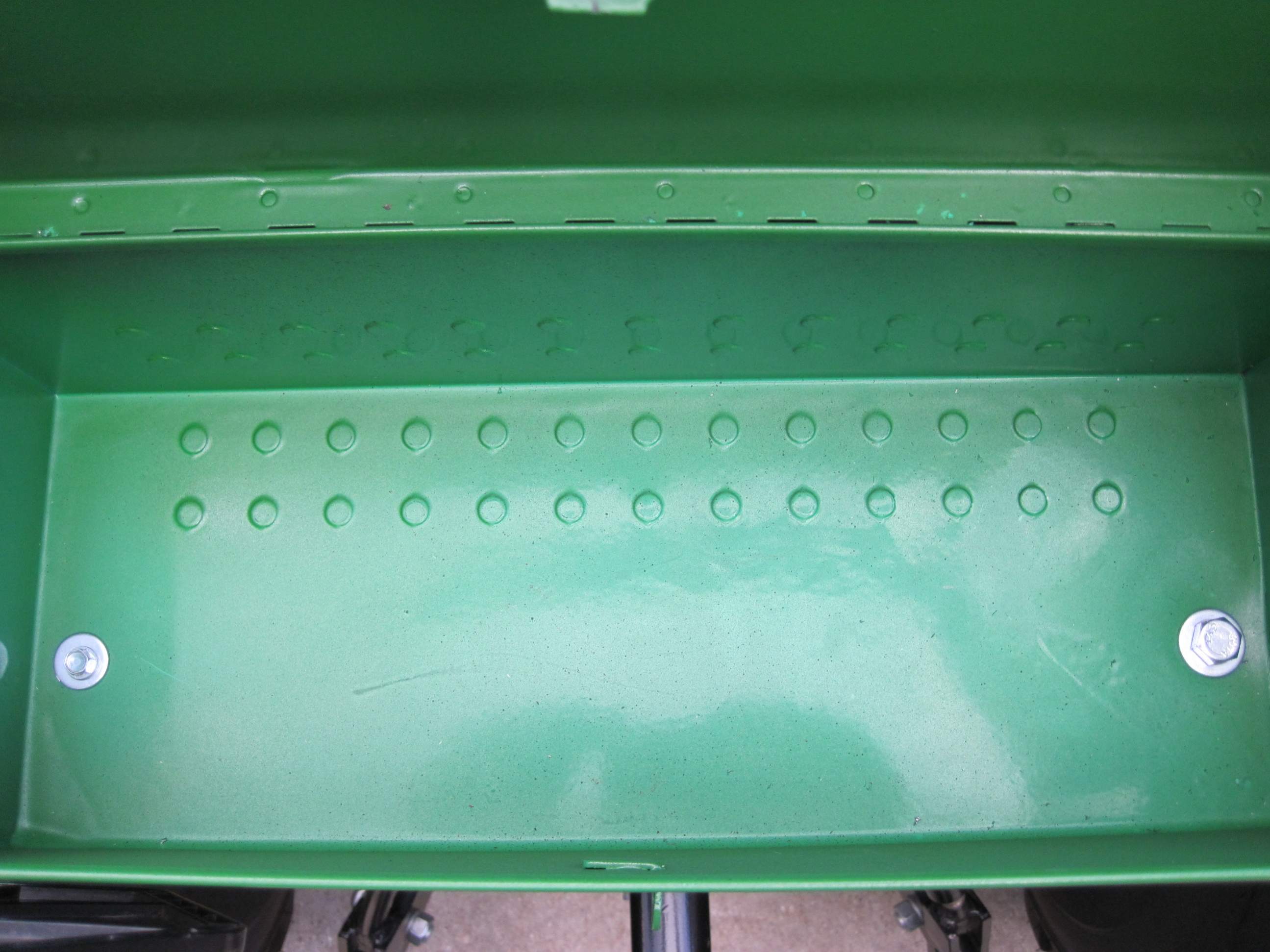

Good morning,
This is what we did for our 2520. I wanted something that mounted behind the seat yet did not create an interference with the seat or the 3 pt arm. My preference would have been plastic but I found this generic metal toolbox at our local Fleet Farm.
I did paint the box as the green on it was closer to an Oliver green vs JD. Not a big deal. The installation was quite basic in that I used an existing hole on the rear frame and then similar to the extinguisher mounting, drilled a hole on the left hand side and used a #12 self tapping screw. Once it was secured to the frame, I added a rubber mat at the bottom for less rattle. I did need to add some washers/spacers on the SMV sign in order that there would be no interference with the opening and closing of the lid.
The toolbox measures 16 x 6 x 6. The main reason for the toolbox was to have a place for my chain, my Kubota tow strap and a few tools (channel locks, vice-grip, & screwdrivers).

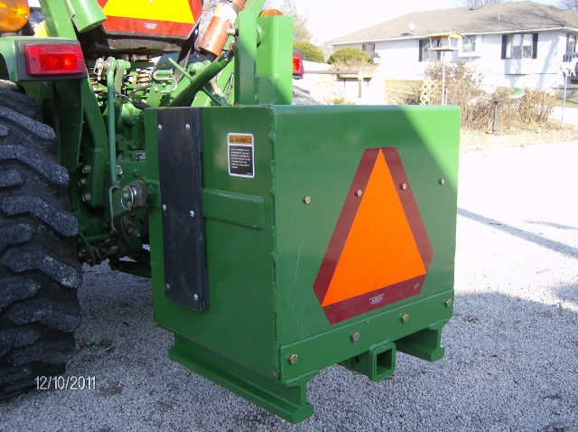

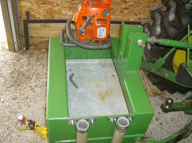

I dont know if you have a ballast box or not but as Don noted, we also carry our tools in PVC pipes installed in our ballast box

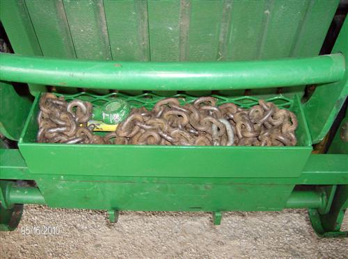

Slightly bigger tractor, but this is what I have on my 790:
Plate w/ tubes for hammer & big screwdriver/prybar.
Ammo box clamped to loader frame.
Chain tray between grille guard uprights.

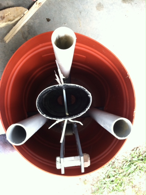

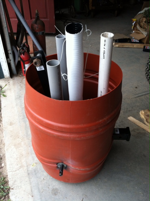

I've finally started my weight.
After looking for a metal one on CL without any luck, I decided to use a barrel I had.
I'm using 2" pipe for shovels and rakes and the 4" drain pipe for chain saws and snow shovels. I will of course cut the pipes once the cement has dried.
I'll have the cement added soon.
