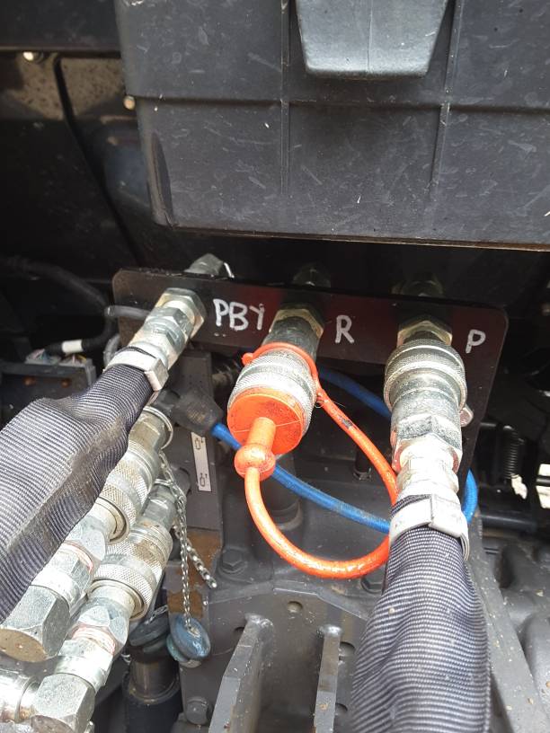

This is how Massey sets up their power beyond, my 1742 was identical to my 1755. I included some pictures for clarification.
So the backhoe lines plug into the pressure and return ports. If you want to drive the tractor or use the loader you have to discontect the hoe lines and plug the PBY line back into the pressure port making a return loop essentially. When Massey installed the backhoe and power beyond, they placed two warning labels on the tractor specifying that if it wasn't put into loop while operating tractor that catastrophic failure would occure, one on the rear window above the ports and another on the windshield above the dash.
Talked to the service manager about it and it has to do with the was the power beyond plumbs into the trans.
What I was wanting to do to save time (and constant mess from hydraulic fluid from conecting and disconnecting) is put in a series of valves that will accomplish the same task as connecting and disconnecting the lines.
View attachment 669239View attachment 669240

I think there was some misinformation or confusion along the way.
With the backhoe attached, and lines connected to the backhoe, you can still drive the tractor and use the loader just fine.
Once you take the backhoe off the tractor, is when you have to close the circuit again by connecting the PB hose to the P port at the back of the tractor. So the fluid will then feed the 3 pt valve, remotes and back to the tank (transmission).
The only thing in common between the hydrostatic transmission and the loader/3pt/remotes/backoe hydraulics, is the fluid. They share the same fluid which is stored in the transmission (acting as a tank). Other than that, it's two completely separated systems.

I think maybe didn't accurately clarify what I was trying to do, and why. I'll add some further info.
The bypass I'm envisioning (hydraulic rated ball valve or something similar) is for when the backhoe is still connected to the tractor.
What I want to do is essentially be able to dig with the backhoe, jump in the cab, drive the tractor and use the loader to move dirt and get back on the backhoe and dig some more holes. That's the scenario in a pretty package so to speak.
The problem is this....
The Agco tech, service manager and the afixed warning labels are telling me that when you are using the power beyond, whether for a hoe, log splitter, ect that you have to disconnect the attachment and loop it back before you can use the loader or drive the tractor (except for creeping forward IE digging a ditch.
That is a huge pain in the **s when you are doing a job that requires using the hoe and loader back and forth.
Because of this i was thinking making a circuit with tees and valves to switch back and forth without having to turn off, relieve pressure, disconnect, reconnect over and over in a day.
