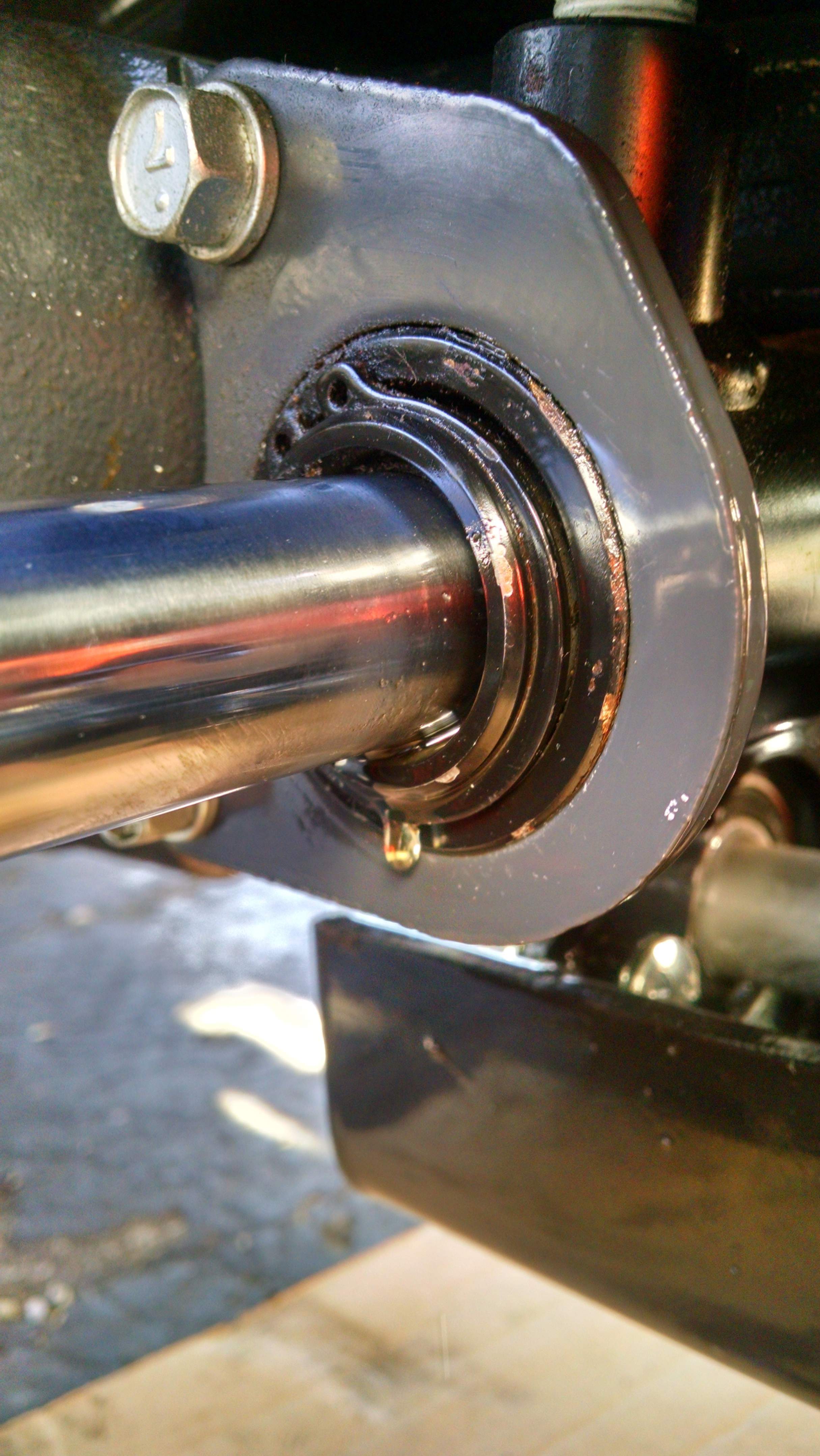

Noticed a few drops of oil under the front axle today. Left side of power steering cylinder leaking oil at 38 hrs. Will be stopping at dealer Tuesday to arrange for repair, but just wondering if anyone else experienced this issue.

Check the hose connection above the power steering unit. On mine the connector above was seeping a bit of oil and was a little bit loose. So we tightened it and it seems to be ok now. The connection is just above the oil seal on the unit and the oil seeps down and it looks like the seal is leaking. When we looked closer the oil was coming from the connection above but its hard to see up in there.
   / Power Steering Oil Leak BX25D #7
It's a known issue. Ask the dealer to replace the cylinder assembly under your warranty. To my knowledge, there is not a new part number so more than likely you'll get the same cylinder assembly, unless they've changed vendors or materials and use the same part number-which with Kubota, is entirely possible. At one time, the cylinder assemblies were back ordered, so before you take it in, ask them to check the part number's stock in the warehouses.

I have the same leak looks like. BX25d
Was a little low in fluid - so did a change front and back to some new UDT2
Once I filled up the level back to where it should be the leak was worse.
I think I'm out of warranty but not sure.
The entire cylinder assembly doesn't have to be replaced does it? Just the seal kit on the one side - maybe the head too but not sure.
040 K2063-16530 HEAD
060 K2063-16580 RING
070 K2063-16590 RING,SNAP
080 K2063-91650 SEAL KIT
