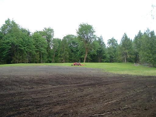

I agree, the shaving will remove your topsoil. Following stump removal, a nice heavy discing will chop the remaining roots up into little bits as it smooths out the surface. Regular mowing (of 70 acres!) will keep undesirable regrowth from happening. Even if you did remove every last little root from the soil, the natural regenerative process of trees will regenerate brush if you don't mow it. I don't see a need to spray anything so long as you can mow it.
The conversion is a common project. I am slowly getting my smaller piece converted too. In the photo, you can see roots still sticking up every now and then. I removed only what rooty stuff came up while grading. I had just finished planting fescue which is now a couple of inches tall.
We would all love to see pictures.

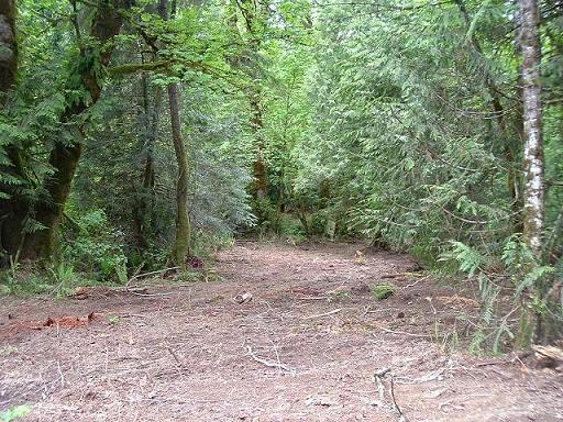

It only takes time. Mine started off as nonwalkable jungle. Over time using a small dozer, and with a little help from a logger I was left with something that a tractor could put into shape.
Here's the before.
