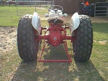

as for fender profile... my naa has 16.9-24's on it... and they fit fine.
you do know you change the rear tire spacing by the way you bolt the center to the rim, and the center to the hub. you can dish the center out.. or put the center on the inside of the rim.. both add space from the tire to the fender. you can flip the tires side to side to keep tread going correct direction if flipping centers.. etc.

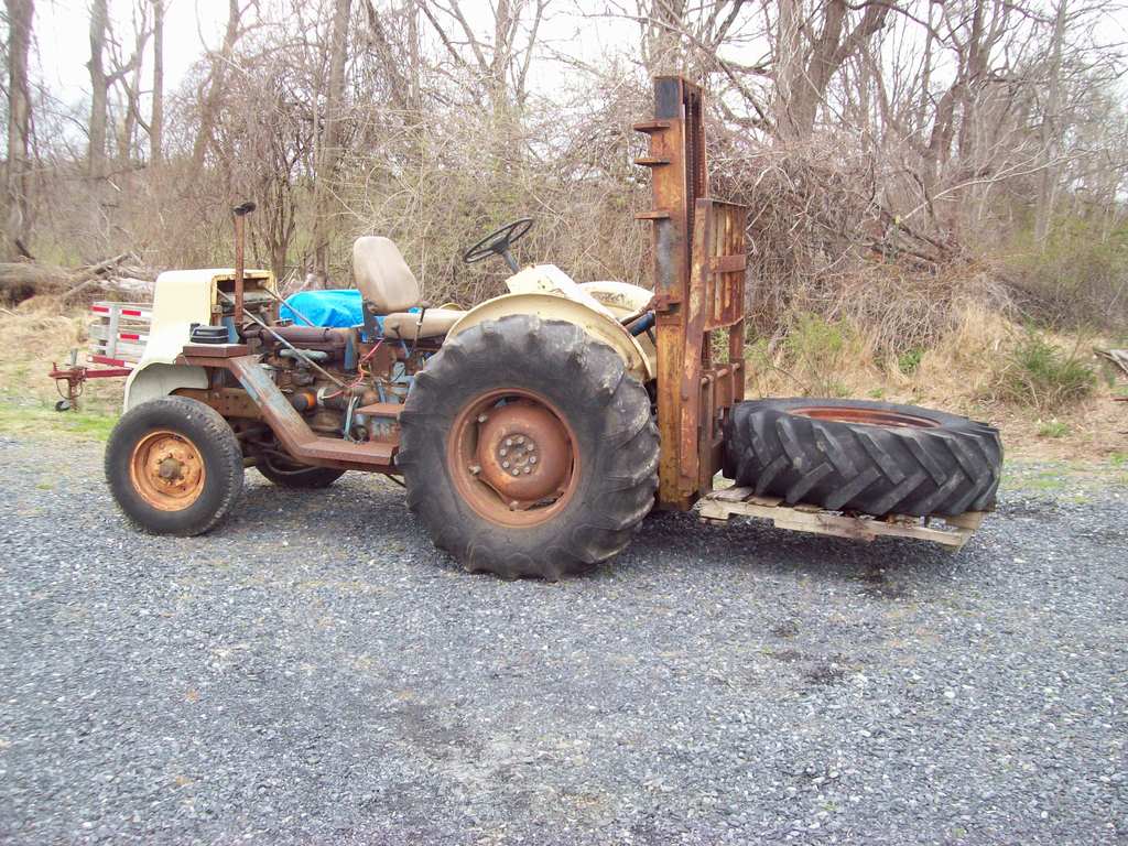

I had a 16.9 x 28 loaded to the max tire I rolled around about four times, almost dropped a couple of time. Then I finally got smart and moved it the easy way with the forklift.
