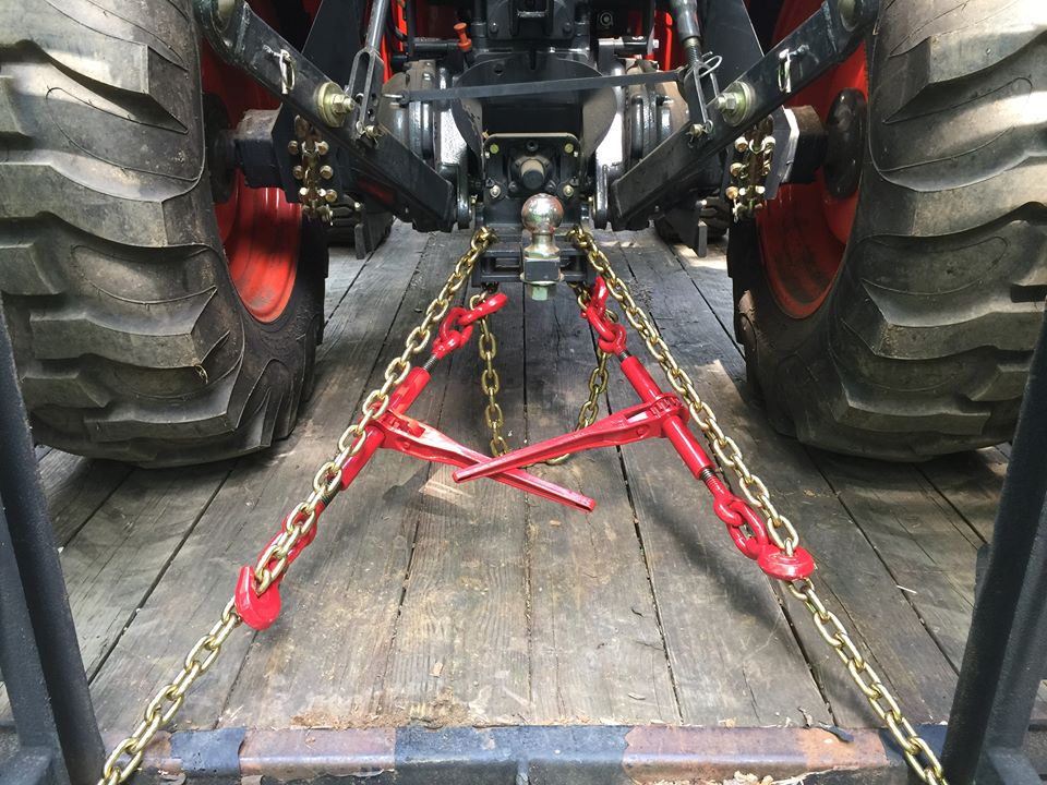

Funny you should ask. Just took some with you in mind...
one thing I didn't mention is that the rear chains need to be attached to the trailer at least 1" behind the attachment point on the tractor and the fronts need to be attached to the trailer at least 1" in front of the tractor attachment points. But ideally, you want a 45 degree angle on the chain. My set up in the back is decent. In the front I actually have a bucket stuffed between the loader arms and the tractor frame so the chains don't have a straight run to the sides. Ideally, you want the chains strait from the tractor to the trailer. Also, ideally I'd have 5 binders not 4. I will be getting a 5th binder so I can have two separate chains going to the front just like on the back. Without two separate chains, if your tractor isn't perfectly centered to start with, it can walk towards center and cause the chains to get loose. This evening will be the first time I road it with the new binders, previously I used one chain in front and one in back and one binder only on the front to pull it forward until tight. However, with this set up it would get loose and move a bit. That is why I'm going to the 4 point tie down method for machine + 1 per attachment.
   / Proper way to tie-down BX2350 to utility trailer #15
one more comment about the third picture (the one of the hooks on the rail). The point here is to run the chain under the rail and push the hook down on the top of the rail. This way, if the chains get loose the hook stays on the rail. If you hook to the bottom of the rail, it is easy for the hook to become detached if the chain gets loose.

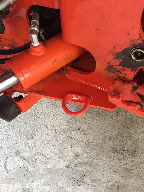

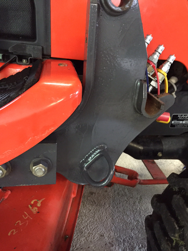

I'm in Somerset Pa an I asked a state trooper while we were filling up at sheetz gas station to look at the way I strap mine down an he told me that my bx25 needs to be secured down at each corner. He said running one strap over the front bucket of the machine an one over the back is not acceptable in his opinion as the machine can still shift. So instead of arguing this is what I did to make it easier for me. I welded D rings to the tractor an backhoe. Then my kubota dealer sold me 4 of these kubota straps. Said with 4 total I will be well secured. image-1469926651.jpg image-4023284028.jpg image-2543854852.jpg image-3099203554.jpg
   / Proper way to tie-down BX2350 to utility trailer #20
I'm in Somerset Pa an I asked a state trooper while we were filling up at sheetz gas station to look at the way I strap mine down an he told me that my bx25 needs to be secured down at each corner. He said running one strap over the front bucket of the machine an one over the back is not acceptable in his opinion as the machine can still shift. So instead of arguing this is what I did to make it easier for me. I welded D rings to the tractor an backhoe. Then my kubota dealer sold me 4 of these kubota straps. Said with 4 total I will be well secured. View attachment 432763 View attachment 432764 View attachment 432765 View attachment 432766
I like the attachment points on your frame. I will look into options for something like that on my tractor.
I do not believe that four separate straps are required for smaller loads like your BX and my 2-series. However, I do agree that running a strap over the front bucket to secure the tractor is not acceptable. I strap my tractor down using hard points on the frame/drawbar. Then, I strap down the bucket/fork carrier and anything on the 3PH separately. I won't rely on hydraulic cylinders to keep anything secure, and that's what you're doing when you try to hold the tractor by the loader arms.
