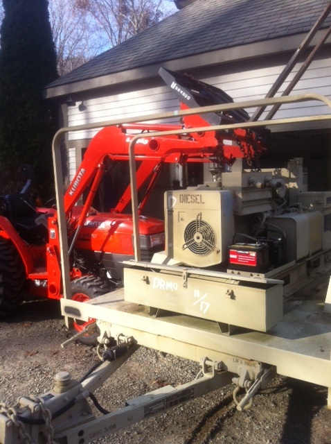

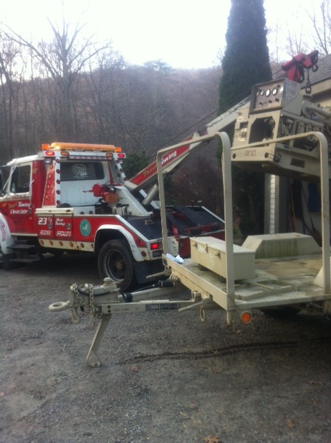

Well, since you have a lot of diesel already, I'll throw in my $.02. My son & I bought government surplus generators out of Ft Meade in MD. Luckily he lives not too far from Meade so he was able to easily pick them up - they came on trailers. Both were reconditioned & had only a few hours on them (like 2), the trailers were brand new.
They are 4 cylinder air cooled Onans & rated at 10Kw. I sold my trailer for $500 which bought the generator price down to $1500 :) The gensets are built like tanks & weigh 1300lbs. I installed my in the garage & wired a transfer switch in for my whole house. After 3-1/2 years I finally got to use it a few days ago. A tree knocked out our power for 17 hours. Ran the whole house incl AC easy peasy. There is a video somewhere on the interwebby that shows one of these MEP-003A's running a 14Kw load for hours.
Because of it's weight my L3400 had no chance of lifting it off the trailer (safely) so. . .
