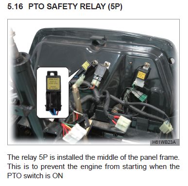

I am having intermittent starting problems with my tractor. I will turn the key to start....nothing happens immediately however within a few seconds of just leaving the key in the "start" position, electrical contact is made and it starts. I have done the "brute force starter test" as outlined here: brute-force test and the engine cranks normally when performing the "acid test". All 12V connections have been tested "OK" from the battery to the solenoid. This leads me to believe that the problem lies between the key switch and the small 12V terminal on the solenoid. I have removed and cleaned the Key Switch and Safety Start Switch with contact cleaner but the problem persists. My next thing was to swap out the 40 Amp PTO Safety Relay with a new one to see if that works before I start thinking of possibly replacing the Key Switch. As indicated in the graphic below which was copied from the shop manual, the relay is supposed to be in the middle of the panel frame once the Instrument Panel is removed. Problem is, the relay is not there on my tractor and I can't for the life of me find it anywhere. I've searched every nook and cranny in panel area cavity as well as the firewall. Tried to follow wires from PTO switch with no luck as the wires disappear within a wire loom into no-mans-land. The wiring diagram confirms there is a PTO Safety Relay but does not provide its location.
Have any other Kioti owners ever encountered this situation?...any ideas where this thing could be hiding?..I have done a subject search on the forum but have not been able to find anything related to this..thank you in advance for any help or ideas that can be provided.

CM: As I understood the issue, the starter motor doesn't turn (at least not immediately). The stop solenoid should not be a factor in that .

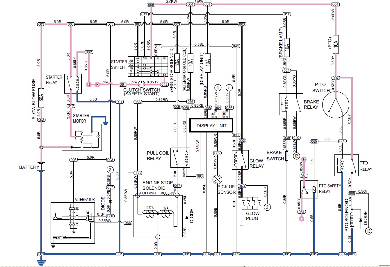

mrtwister: The start circuit for the 4510HS (which is the same as the 4510) and it's exceedingly simple: no electronics, just mechanical switches and relays:
This is a good thing which should simplify troubleshooting.

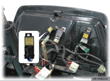

Oddly, even the shop manual shows a blank space where the PTO safety relay is indicated. To help convince yourself that the PTO safety relay is not the problem, you can turn the PTO on and then off while you are holding the key in crank and nothing is happening. If the PTO relay is balky, cycling it should restore the connection and the engine would crank immediately after you switch the PTO off.
Rebuilding the key switch is not hard but there are a springs inside (for the detents, return from crank, and pressure for the copper disk). The risk is that one of the springs goes flying and is never found. Electrically, the switch is very simple: each wire is soldered to a contact on the inside is the switch back. There is a copper disk with raised circular arcs which touch those contacts (or not) as the key is turned. See here.
Are you sure you replaced the correct relay? I think there are two identical relays and sometimes (even at the factory) the connectors get switched. That makes no difference in the function except the relay functions would be reversed from the labels in the service manual.

I had checked out the above wiring diagram in my shop manual and was perplexed by the blank space that you are referring to, although it does specify that there is a PTO Safety Relay...that little bugger has to be hiding somewhere!!....or is it possible that a relay is not required?..anyway, let's hope that is not the problem.

Just unfounded speculation, but maybe they changed to a PTO relay with dual contacts and used the second set of contacts for the safety function vs a separate relay? I have noticed a more than a few errors in the Kioti manuals, so this wouldn't surprise me. With luck, you'll never need to know.
