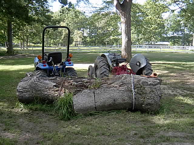

I've always used parallel, rather than series to evenly distribute the power for my pull. Here's a picture...
