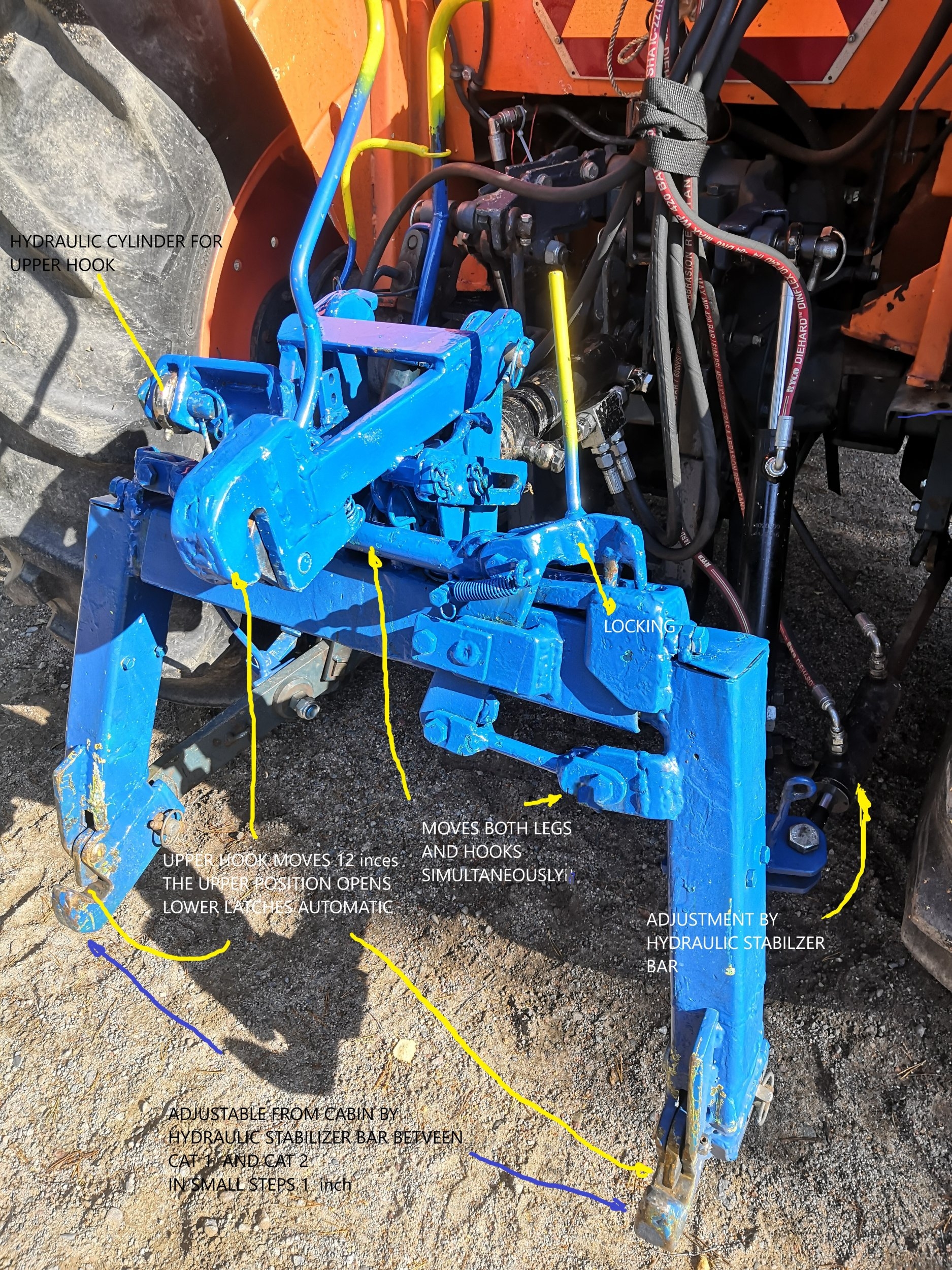

I made at first my UNIVERSAL QH
It was suitable for standard cat1 and cat2 tools and for my not standard tractor tools
It works very well and I love it.
But it is complicated and heavy and most people do not like that.
What to do next . I try now EURO HOOKS.

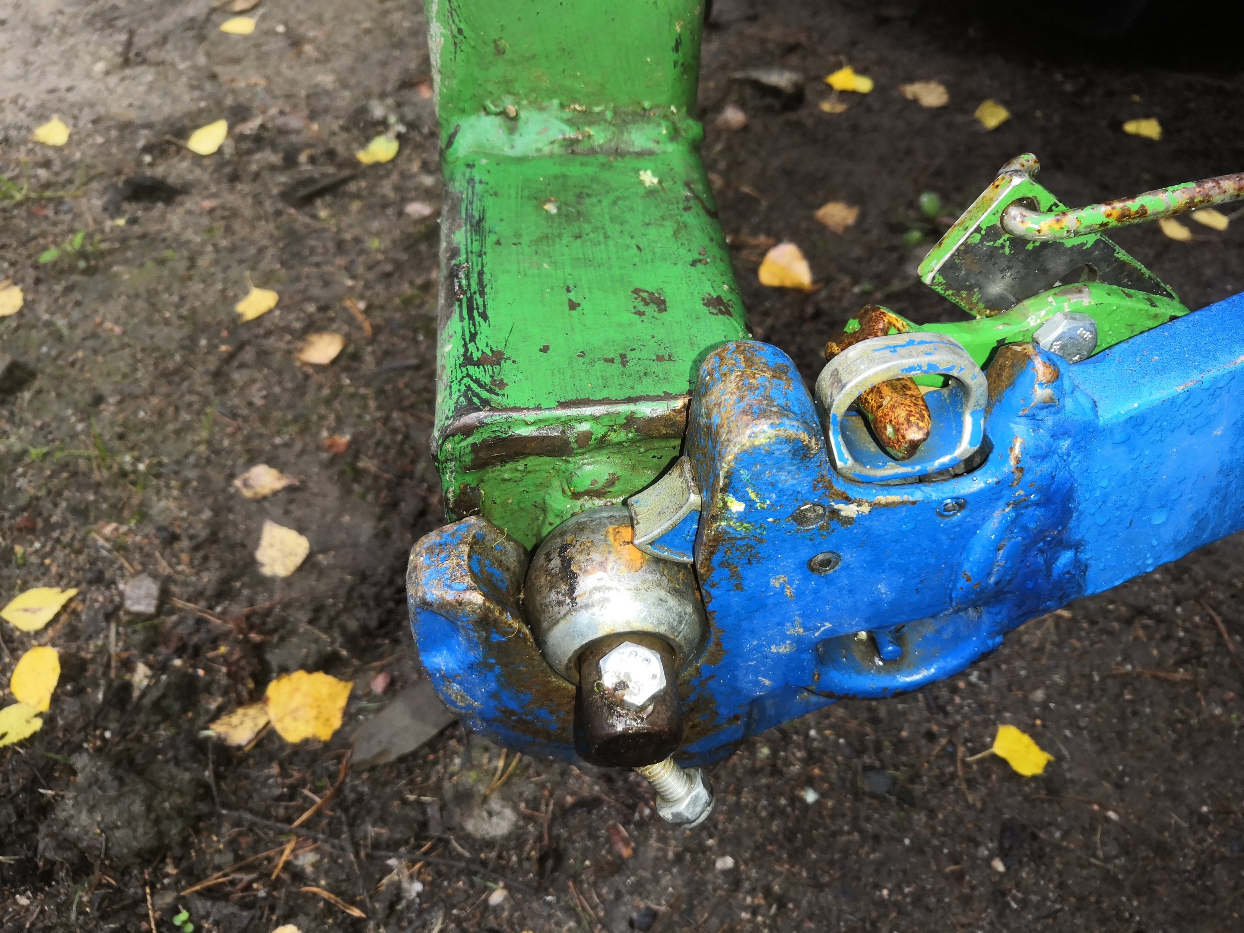

I welded Euro Hooks to my Kubota L345DT lower links.

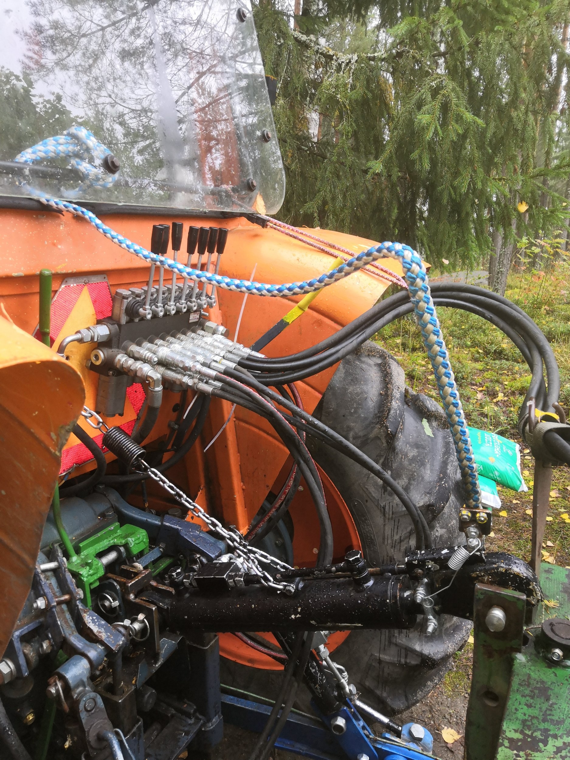

I made then two rod links to the cabin from the lower hooks
and a car tow rope from the top link to the cabin.
Here is a spring inside the rope at hook end keeping it upright
and an other spring and chain keeping the top link lightweight to use.
I made same thinks for next to JD
These ideas are suitable for small and big tractors and all cat three points and non standard attachments. I am near 83 years and can not do much more for your EURO HOOKS
Ask your tractor maker for EURO HOOKS!!!. They can do !!!!
