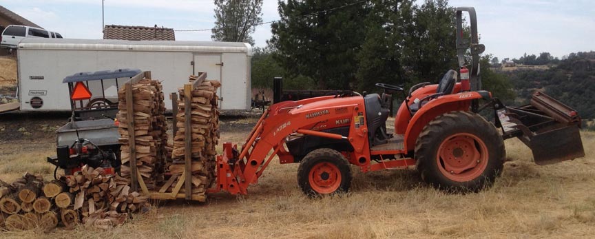

It's been overcast the last couple of days so I've been out working the wood pile. This morning I got out the splitter and went after some of the bigger rounds that I've been setting aside. I like the idea of easy handling wood (thanks!) so I kept the splits under 3" across and it wasn't that much extra work. I had a 4'x4' pallet about a third full of wood already and when I got it to half tried to lift it with the forks on the tractor. No problem. So I kept loading it up, checking again at three fourths full. Still no problem. When it got full the FEL could still lift it, but because there was s slight side slope the tractor was heavily loaded on one side. I set the pallet down and used the box blade to even out the ground and things were fine after that. But I don't think I'd want to put much more wood on a pallet than that. Here's a picture showing some of the wood pile and the tractor lifting the pallet:
That's the only 4x4 pallet I've built up, and only have three more that are about 2x3. They're easier to lift and I like not having to duck under the front cross member when I'm loading the back bay on the 4x4, so I'll probably focus on finding 2x4 or so pallets. The shop I've been getting my tile and stone from has tons of pallets and are only too happy to see a few disappear in the back of my truck when I drop by to say hi.

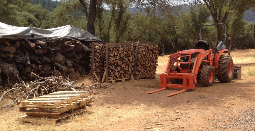

Here's a shot showing two of the smaller racks and the big one sitting off the end of the wood pile. Only about half that pile is showing in the picture, so it looks like I'm gonna need a bunch more pallets. I'm not putting much effort into the bracing on the pallets because I'm hoping to have an awning to stash them under before the rains come again, and just need some way to make the wood easier to move around. So far all I've needed are scrap 2x4s and a few long drywall screws for each one, and they take maybe fifteen minutes to slap together. Not very sturdy, and I'm sure if I bump into something with one or try to go too fast over rough ground they'll fall apart, but for now I think for figuring out the sizing and loading they'll be fine. Another great from TBM veterans!

I was thinking if you had one of your pallets full of green wood it would be heavy. Be careful stacking the wood that high. A piece could fall back on the tractor. If you prefer a 2'x4' pallet you can get a 42''x48'' or 4'x4' and cut it down to make a 2'x4'. The part you cut off can be used for kindling. When my pallets get rotten the turn into kindling. I use a reciprocating saw with a bimetal blade to cut them up.
I prefer to stack my wood on 42''x48'' pallets. I have some that are a little bigger. I don't like 3x3 pallets because I have to move the forks in.

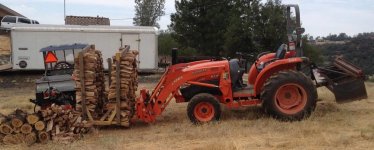

Here is how I stack my wood on pallets. This year I just started using netwrap around them. It helps hold them together and keep the leaves out. I think I am getting around 1/3 cord on them.
If you don't wrap them and take it slow the wood stays on.
