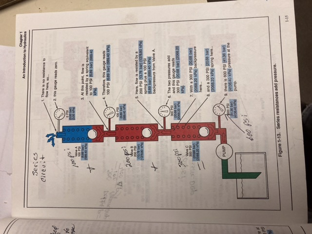

   / Question about how my open center FEL valve with power beyond #6
Just to show this came from a Vickers training manual. Same principle of multiple resistance in series valves.

   / Question about how my open center FEL valve with power beyond #10
I'm trying to understand how the diagram and video above apply to this thread topic. I don't think that the directional valves in a series have check valves working when all the spools are centered. (ie not being used) The leading valve must have a pressure relief valve to protect the pump and each valve spool may have anti-drop check valves but they would not function the same as the check valves shown above. Right?
