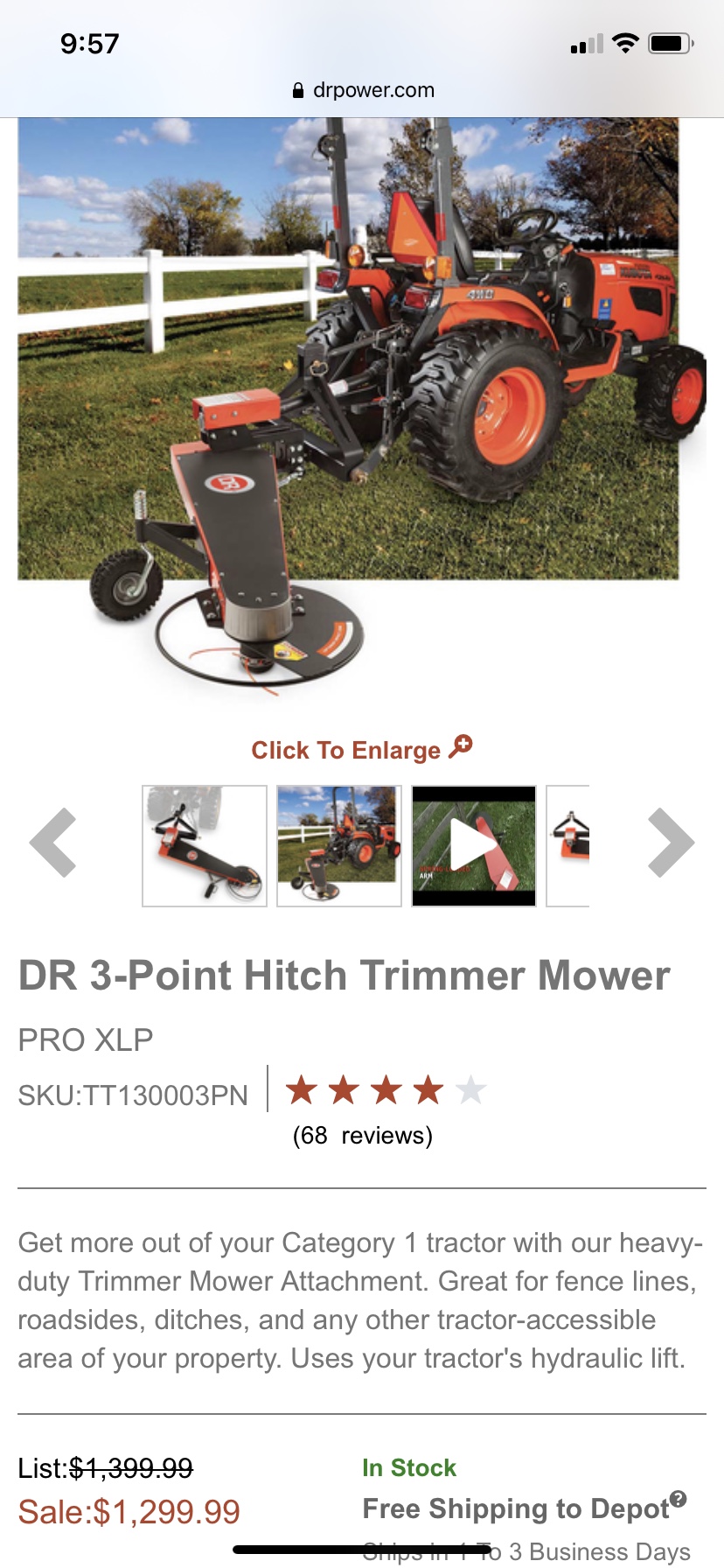

As I recall, somebody ( DR ? ) makes a 3 point fenceline following industrial strength weed whip that can cut under a wire fence and dodges fence posts with a spring loaded follower arm.
   / question on field fence #5
You are correct. Plus it is on sale!
