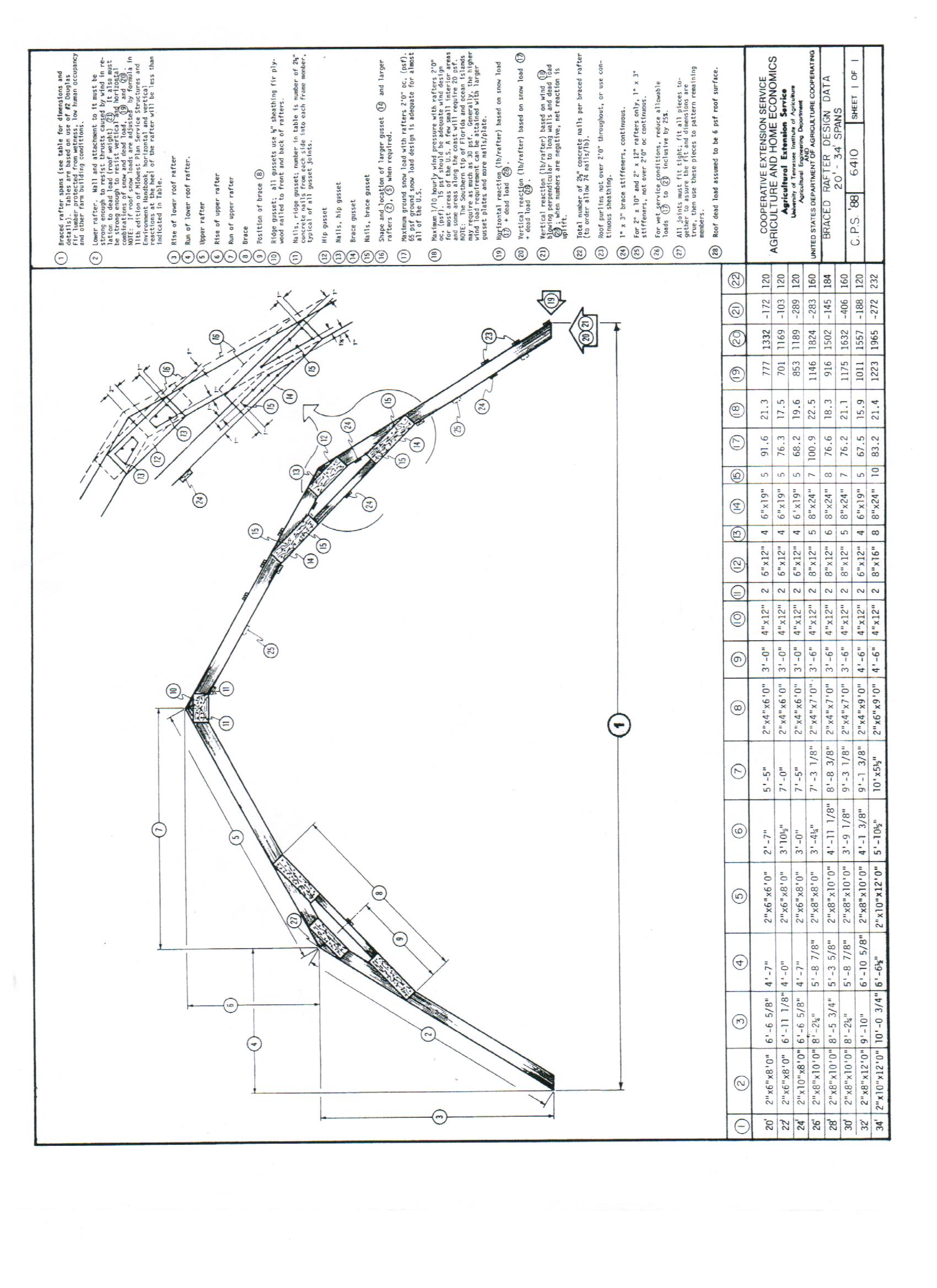

Can anyone help me figure angles for truss's on open loft/storage for a barn style roof for a shed. 16 by 20

This is what I used to build gambrel trusses for a 32' span. It gives you all the dimensions but no angles, I had to lay it out on the ground and farmer math the cut angles.

   / Question on how to figure angle on barn style roofs #6
Are you looking for the actual angle or are you trying to design a truss?:confused:
   / Question on how to figure angle on barn style roofs #7
I like this method.Take half the width 16'=8' draw 8' circle plate corner to plate
corner.Then from center draw line 45 degree left and right to circle.Straight line
from plate to 45 to center. Makes nice angles for gambrel style roofs. Good luck
