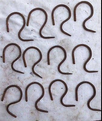

This is what rock tines look like. They are made out of high carbon spring steel, and wrap around the drive shaft so they have quite a bit of flex if they hit anything solid.
To put them on the PT, you'd need a "P" shaped clamp to clamp the wire against the shaft and enable you to bolt it down.
